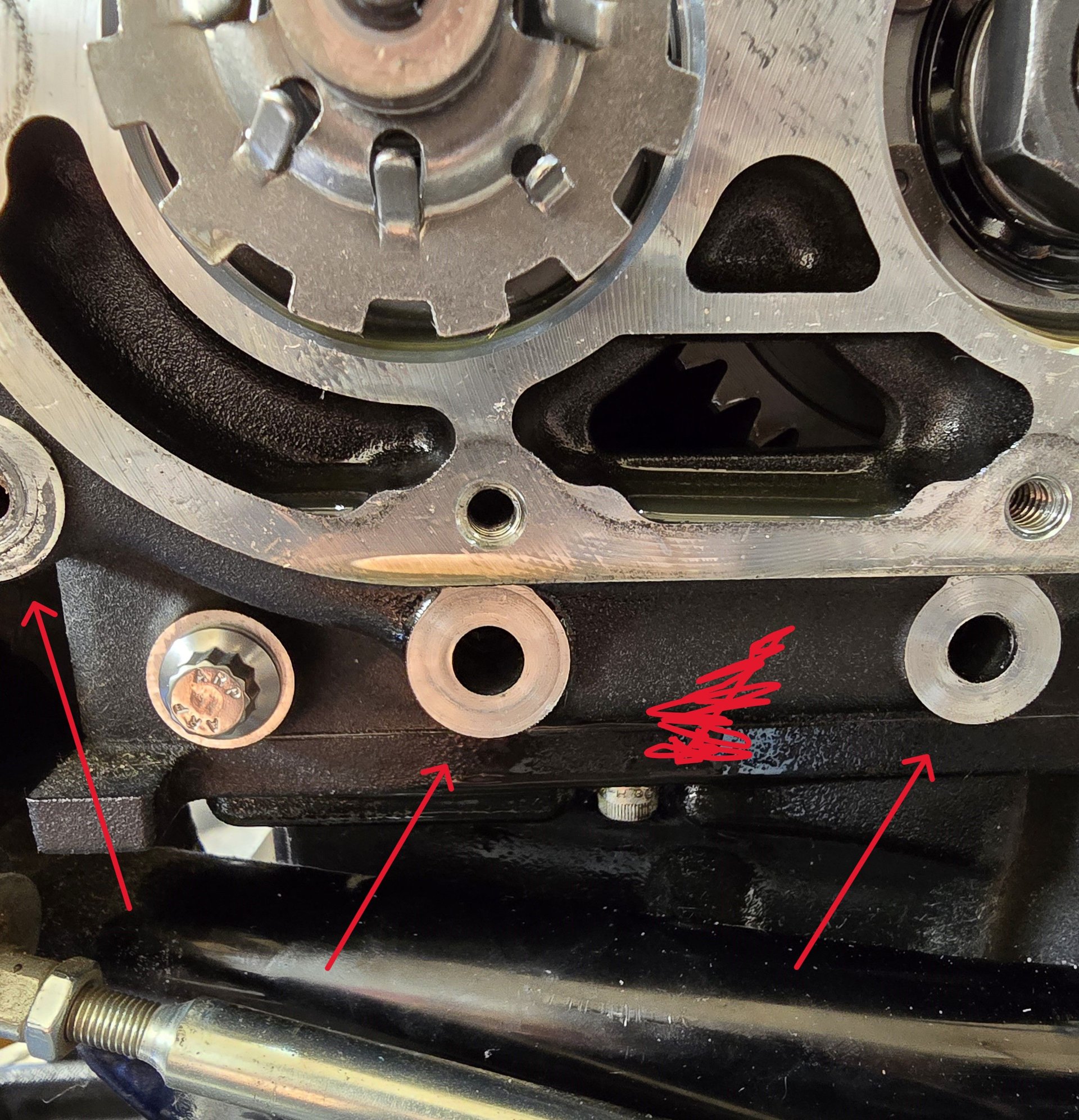

Not following what bolts your talking about.. Can you post a pic?
Originally Posted by Bubba Zanetti
What are you gonna do OP?

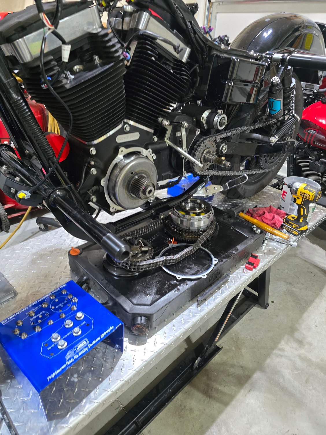

I pulled the primary and my race puller should be here tomorrow. I am very good at talking myself out of doing things and it's a bad habit. I've been wrenching since I was old enough to hold one, I have a fully stocked shop and most of the specialty tools I need, tearing everything down literally took about a 1/2 hour. The most time-consuming part was finding clean places to lay the primary halves and the compensator/clutch basket assembly.
You know, I'm just as guilty of saying shitty things here and there but it always cracks me up when people chime in with dumb-*** comments. There isn't a mechanic alive who hasn't at one time, or another made a dumb mistake even after years of experience. I'm an engineer by trade so I am typically very meticulous about any work that I do. I'll own my mistake; it turns out the bolts are actually too long. I don't know if this is true, but my guess is the stock bolts didn't strip because they are a softer material but the ARP's tore right through the case material when they bottomed(?).
Either way, it's a bonus because I can reach the engine to trans bolts (and others) now and I'm swapping them for ARP's also.
I appreciate all the posts with helpful into especially about the different inserts, I'm going to watch that video and do some reading before I settle on one. My fear now is going through all of this and re-stripping the holes. My plan is to take the depth on the repaired hole, add the width of the Thunderheader bracket and the spacer then subtract a 1/4" to get the new bolt length. I'm not a mechanical engineer so does that sound reasonable?
