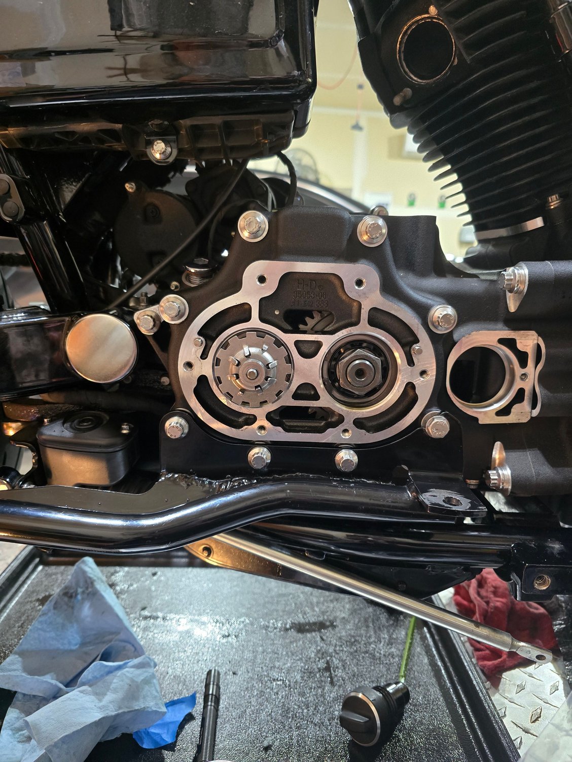

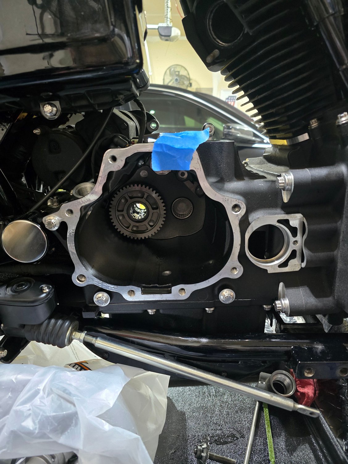

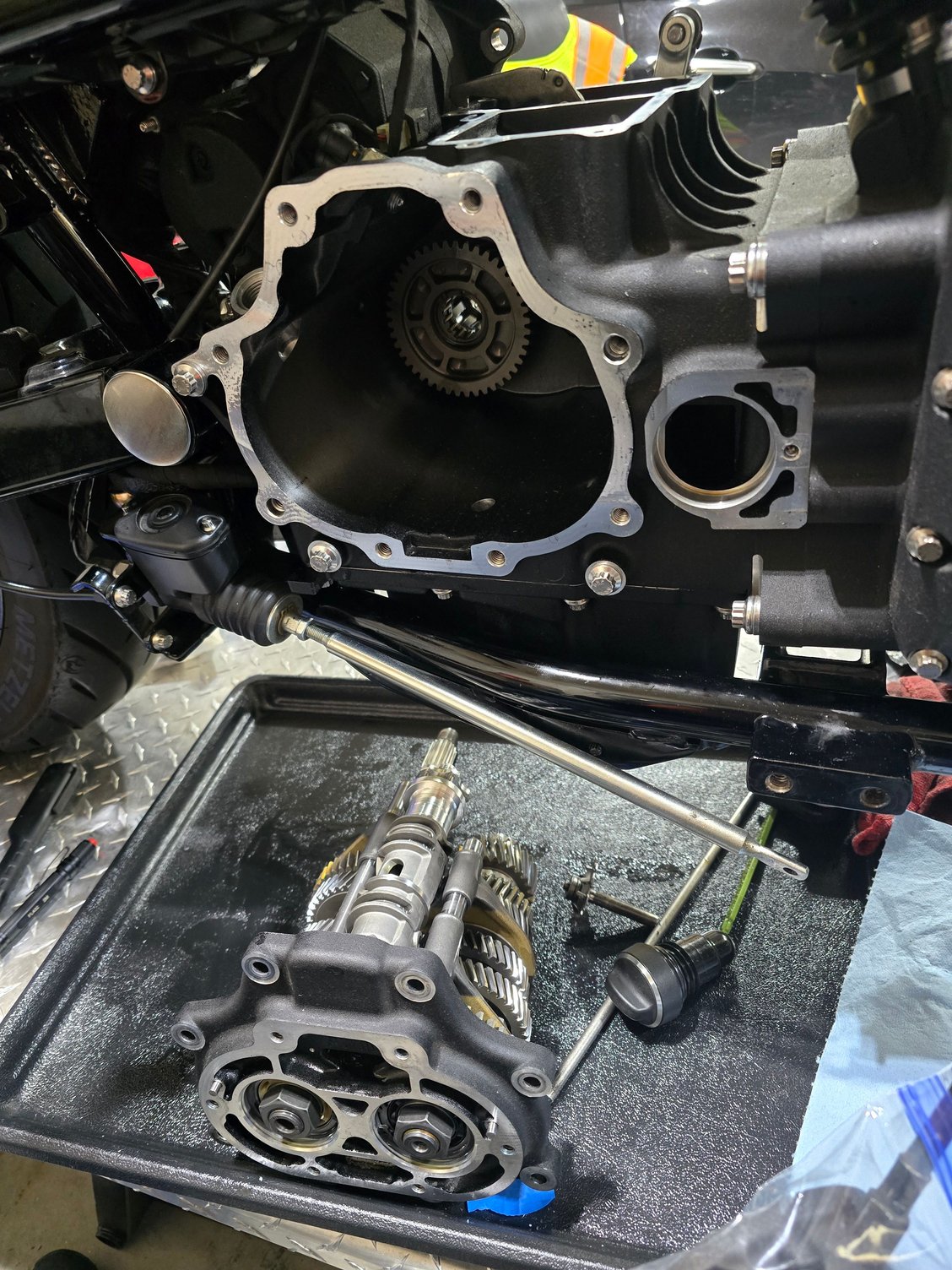

Well here's the result. I pulled the main bearing cover/gear set, it was pretty easy with the right tool to remove the main shaft race. Cleaned everything up, drilled, tapped and HeliCoiled the 3 holes, cleaned it again and got it put together last night. Bolts all set to factory minimum 23ftlb with a drop of blue and the HeliCoils were confidence inspiring. This is the first time that all 8 fasteners were able to be torqued. Thanks to everyone that weighed in, I appreciate it.
