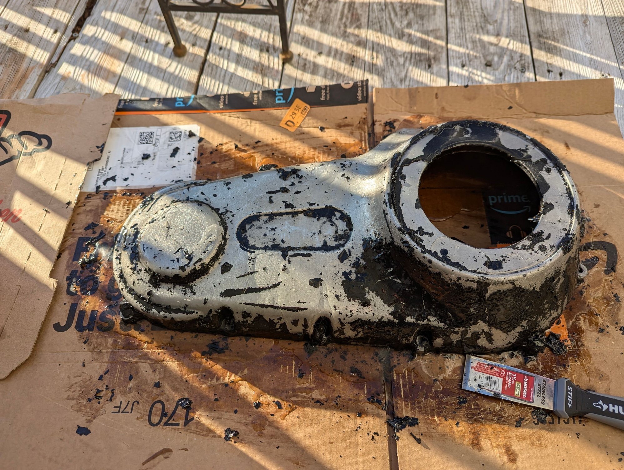

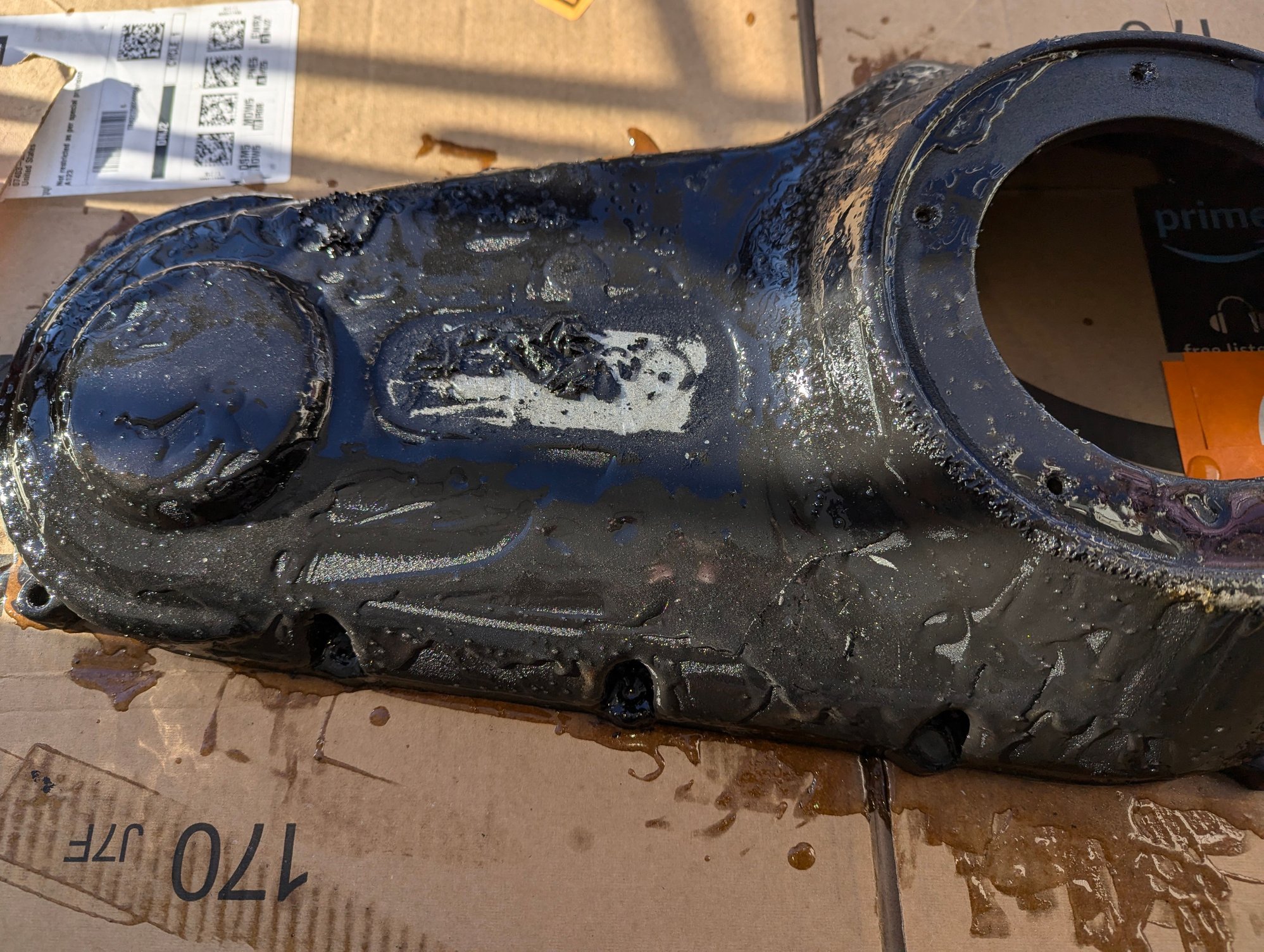

Well that was a helluva lot easier then I was expecting, I first tested the 'inspection cover' (which is solid now) and that was easy peasy. So I glopped it all over, and let it sit for an hour and used a paper towel to wipe off. I'm on hold because of the temperature (North Jersey 30sh minutes from NYC), so it's down to the teens at times. But first round took off the majority, and the manual labor so far has been 15/20 minutes to wipe off the paint and stripper glop. It took far longer to clean up then the stripper took, I was expecting to be wiping a lot or cleaning more, but this stuff took it right off. The cool thing was that a few times, the gloves melted and I didn't even feel it or know (but I immediately scrubbed up when I did notice) just in case. They melted twice in 15 minutes but overall, no problems so far. I'll resume tomorrow and finish the strip then begin polishing up the aluminum.
BTW, no I didn't use the scraper, that was all I had to lather it on, but I didn't scratch the aluminum and went gentle and sideways with the scraper and goop:

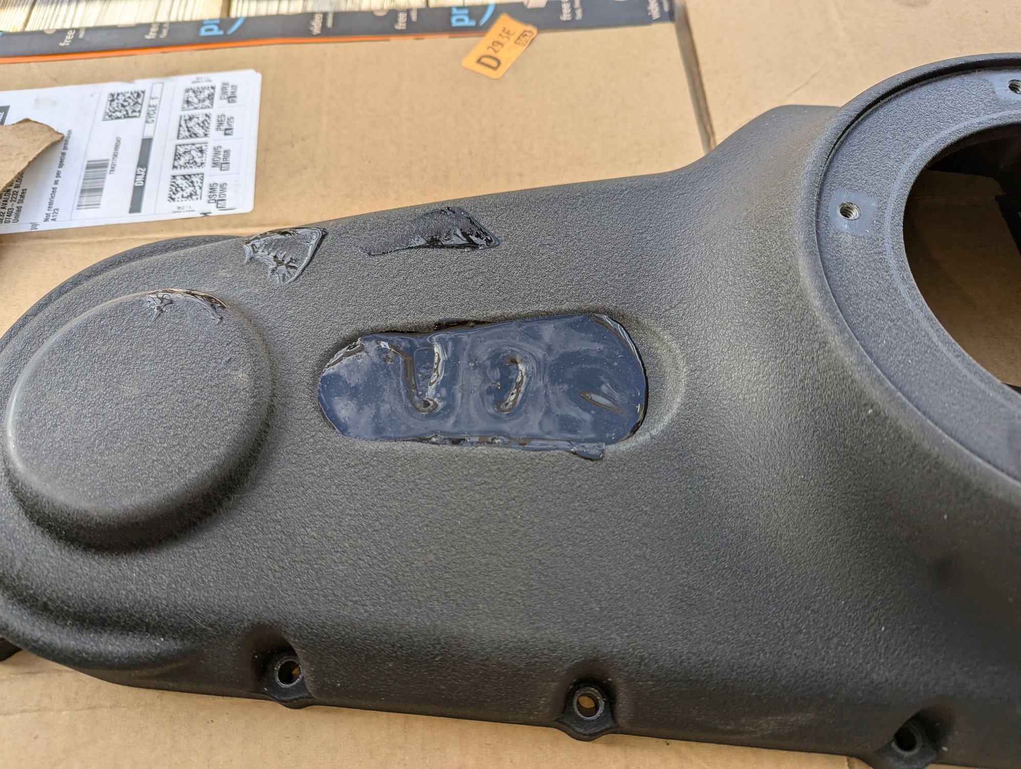

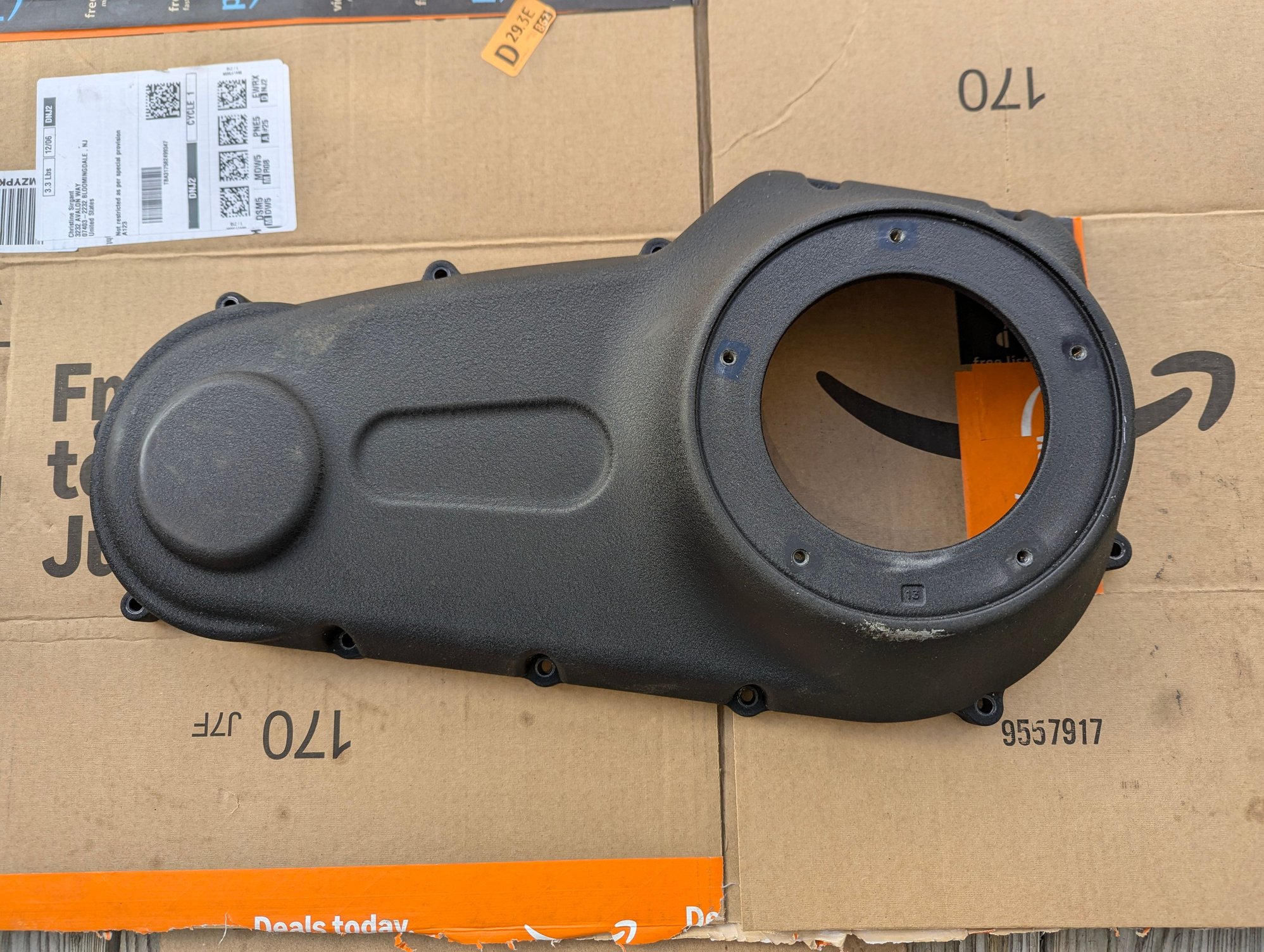

Here's the 'before' and initial inspection test:

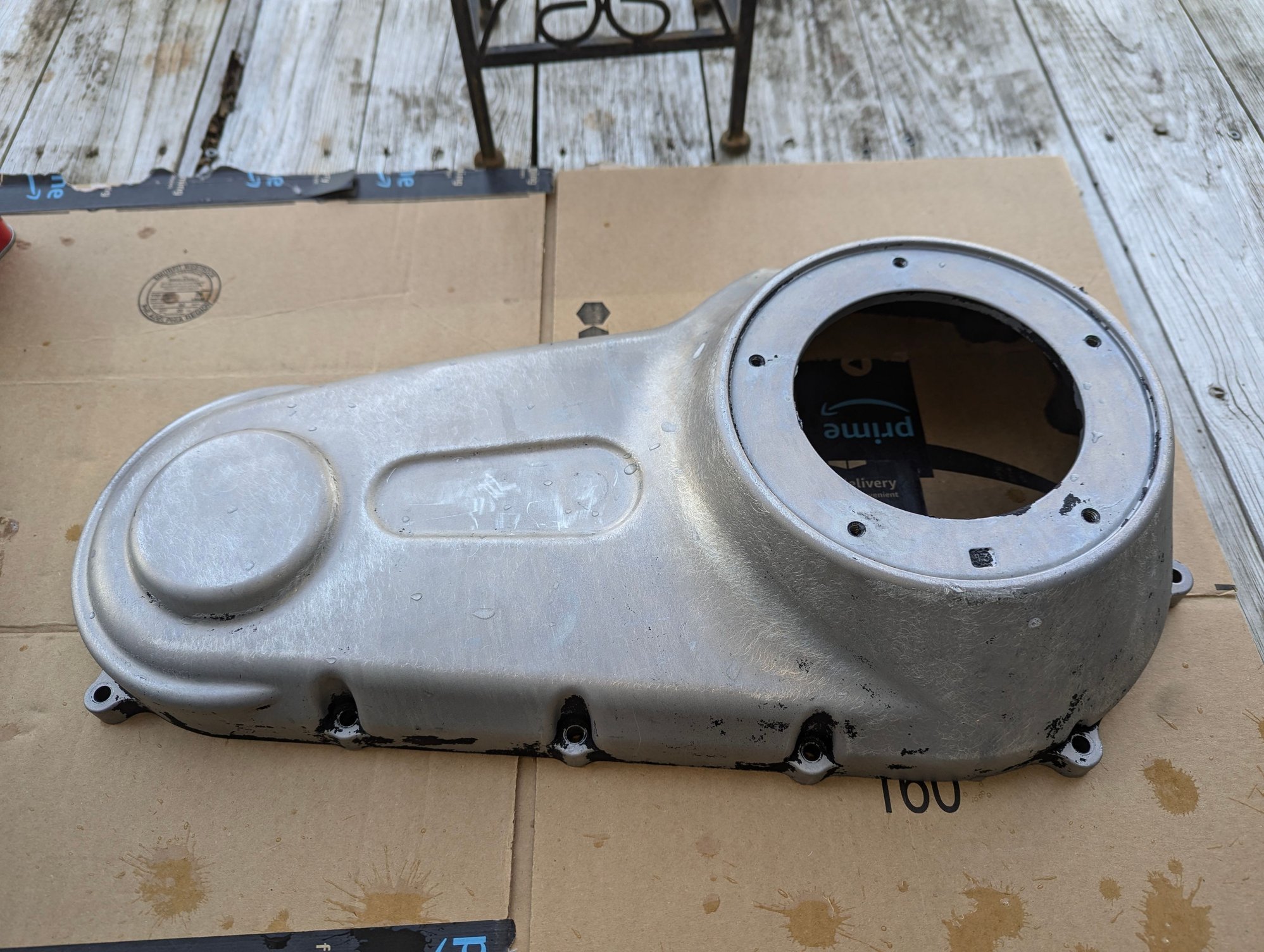

Round 2, this time I hit the corners and then gave it a good bath with warm water and soap after the removal. I needed to see what's actually left to remove but not stuck on with the paint remover (but actually removed). Almost done, a few holes and few high spots to hit but I should finish with the next round then I can begin to polish it up:
