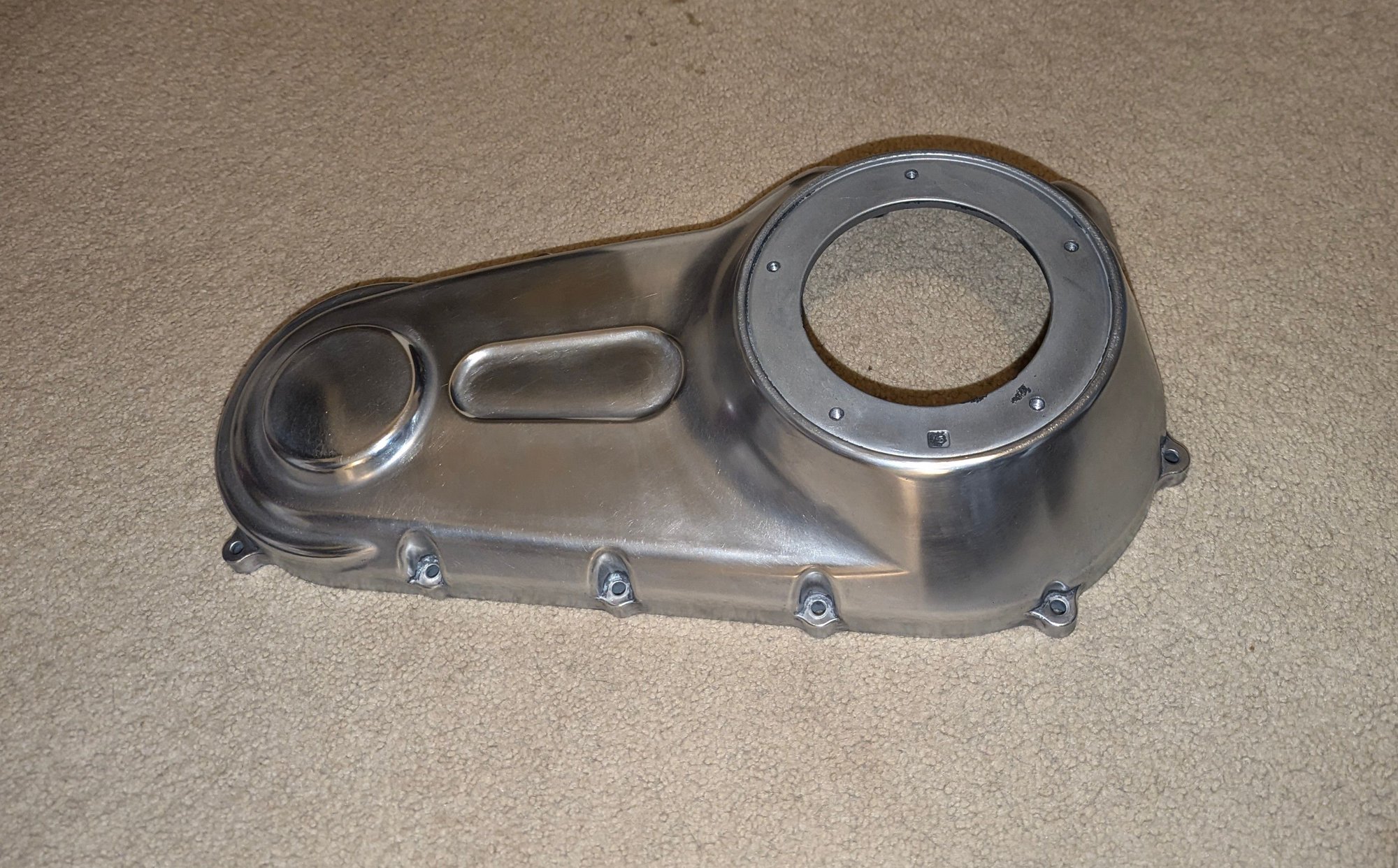

Forgot to post the final pic with the scratch sanded/buffed out. I removed all original damage and buffed out the aluminum. I love how the final product came out so I'm getting the trans top, points cover, and continuing the rest to match the trans side cover..

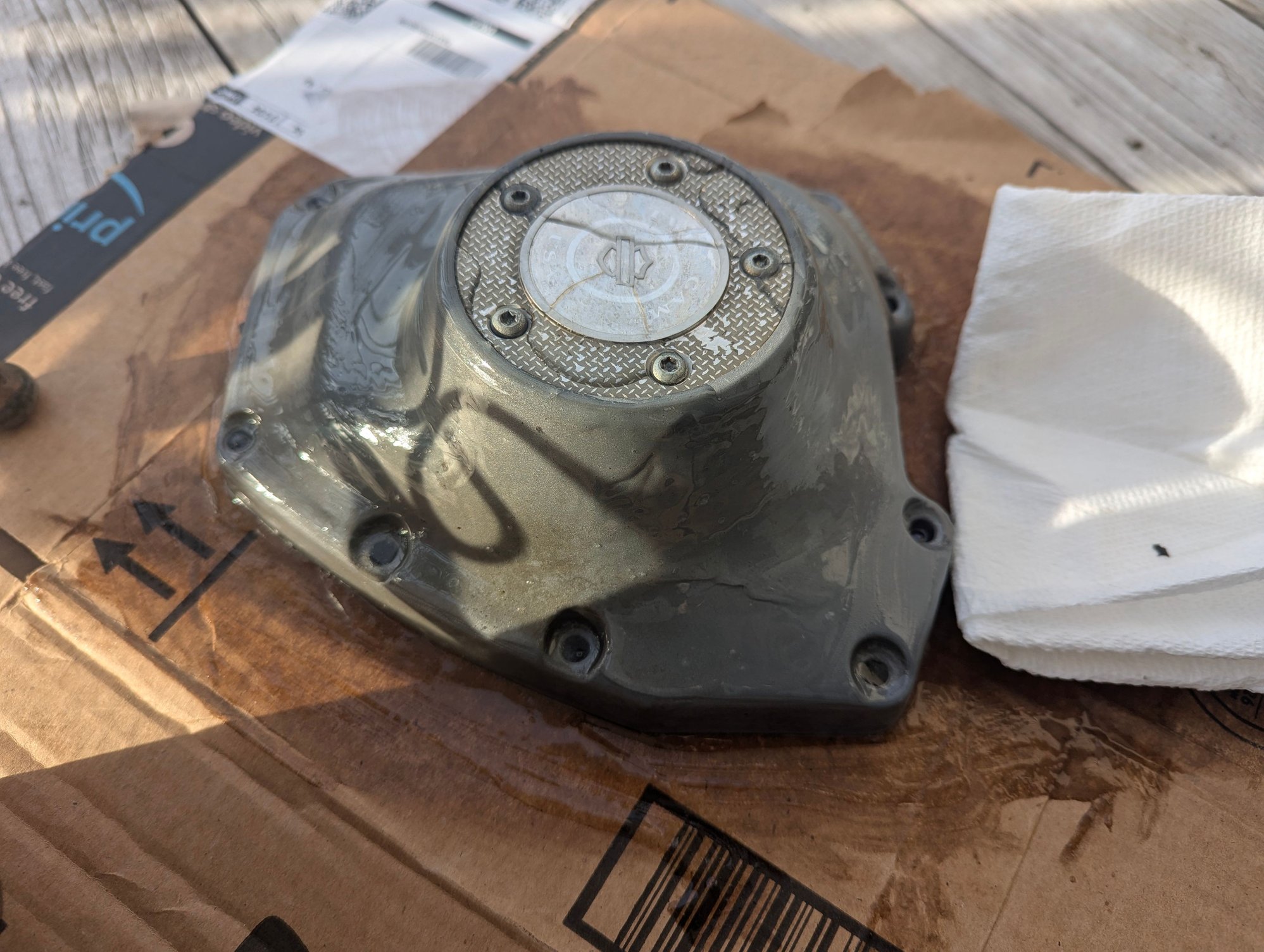

I just bought a cam cover for 30 bucks, obviously needs sanding but overall in good shape so this is next:

One thing is for sure, black powdercoat came off a hell of a lot easier then the stock grey. I did the same process, first stripped the paint with an hour wait, barely anything happened so I let it sit overnight (12 hours). Barely anything happened, a little grey smudge came off so I hit it with 300 grit sandpaper, and Dremel stripper. That took everything off but took a while. Once I had it stripped of all grey, I began sanding it by hand with 400 grit (wet sanded) and now she's ready to polish sand (1,000) grit, then I'll polish the piece to match the primary. It took a lot longer than the larger black powdercoat (primary cover), but the end result is the same. I'll follow-up once it's chrome shiny!
I'm having so much fun polishing up my aluminum, and my only complaint is that I wish I had known I could've done this 2/3 years ago. I've been riding with the ugly grey covers and the mid control shaft for 50,000 or more miles (I only run forward control but I didn't have a primary cover at the time so I left the shaft intact). I would've done it day 1 if I had known it was possible so I REALLY appreciate everyone's help and input!!
This is what it looked like originally. I left the cover (original points cover) on to protect the inside since I'm not using it and will use my original cover so I figured it was best to leave it on while I sanded the piece:

I need to polish a bit more to match the primary but it's coming along beautifully!

Here's the final polish next to the primary, perfect match 😁
