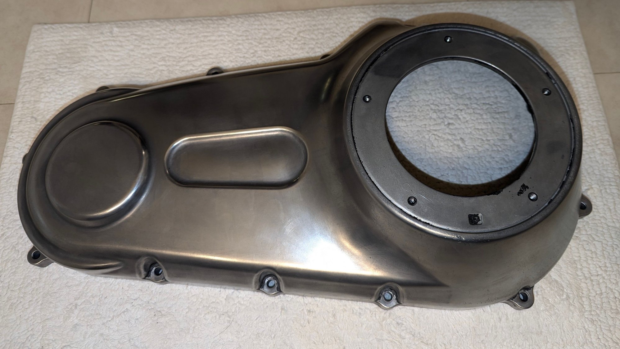

Here's the current status, all black gone, I'm in the first stage of sanding out the aluminum. 220 grit is done, working on 400 now, then I'll move to 600 and 1,000 until it's shiny. I can't go to shiny right away or it won't match so I'll probably stop at 1,000 then redo it down the road when all covers are stripped (I don't mind the work of removing down the road). It gives me a chance to check everything underneath the covers (primary chain/tensioner plus the cams are being swapped soon) so eventually they're all coming off again anyways:

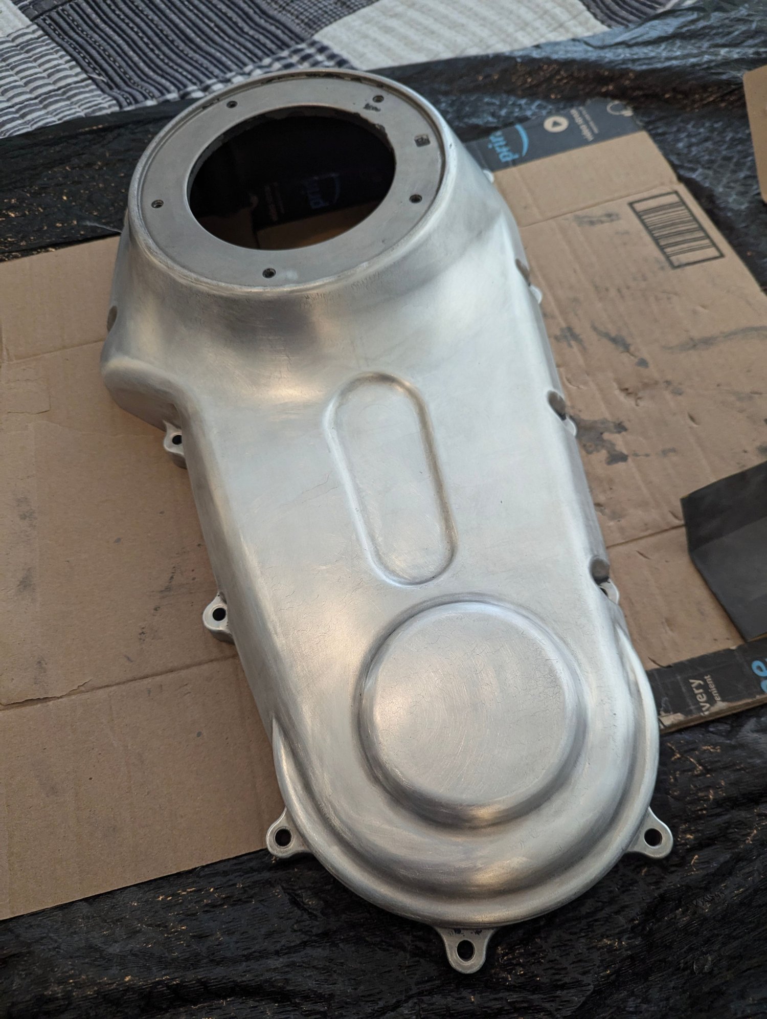

I polished it only once, and it already matches my new trans cover almost perfectly so I'm going hit it one more time with mother's mag and one more polish then install it. It's awesome but the pics don't do it justice at all (in person it's beautiful). It's better than I expected it could be to be honest! It's exactly the old school shovel look I'm going for so it's the outcome I wanted! Now I can get rid of the mid control and start to match bare aluminum and get rid of the ugly grey!

I'm done, 2cd polish and in person it's almost chrome shine, which is far shinier than anything else on the bike (except S&S teardrop) so it's perfect!
