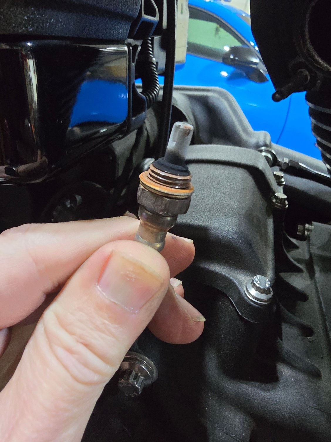

Small update for today, I pulled the Thunderheader so I can give the whole engine a good cleaning after the snowy trip to WI last spring. I noticed the front sensor is really covered in carbon while the rear was clean except for the base, any thoughts on that?

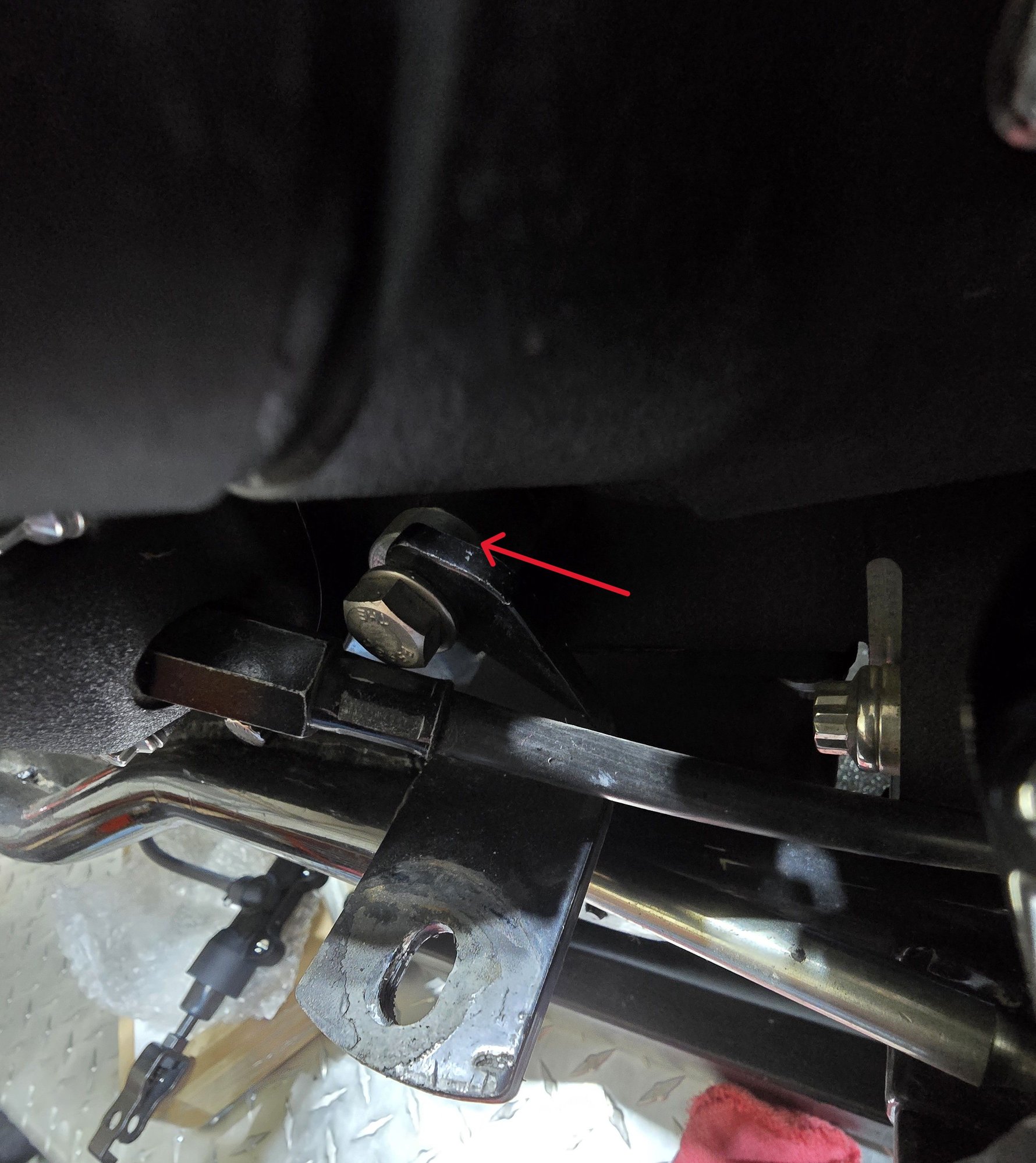

While I'm at it, I'm removing the spacers I had added to the Thunderheader bracket. I used to run a pair of 14" Legends out back and when I installed them, I had serious contact with the pipe. @Mchad had the fantastic idea to push the bracket out with spacers and it's worked for years. This last spring I switched to 13" Bitubo's so I don't need them anymore. This will also let me get rid of one of the last non-ARP bolts on the bike, since I didn't have the clearance with the spacer in place.

As I recall, the rear cyl usually runs a little hotter, but I’d add both O2 sensors to one of the instrument data pages on the PV and run a 20 min log, starting cold. Then give FM a shout and send them the log.
Edit: do you have 18mm bungs on your pipe? I doubt it but if you do I can always lend you my wideband kit for more detailed logging?

How far is the sensor into the pipe?

No idea, it's the stock Thunderheader bung setup.

I just realized that those are narrow band sensors so they won't be able to record any AFR outside of the narrow band sensors capability of 14.3 -15.1 I believe.. But at least it will show the changes in the VE tables. It would help a lot to see your tune..
EDITED: what do the plugs look like??

It almost looks "shrouded". Quite common especially if it's in an adapter for 18mm bung.
