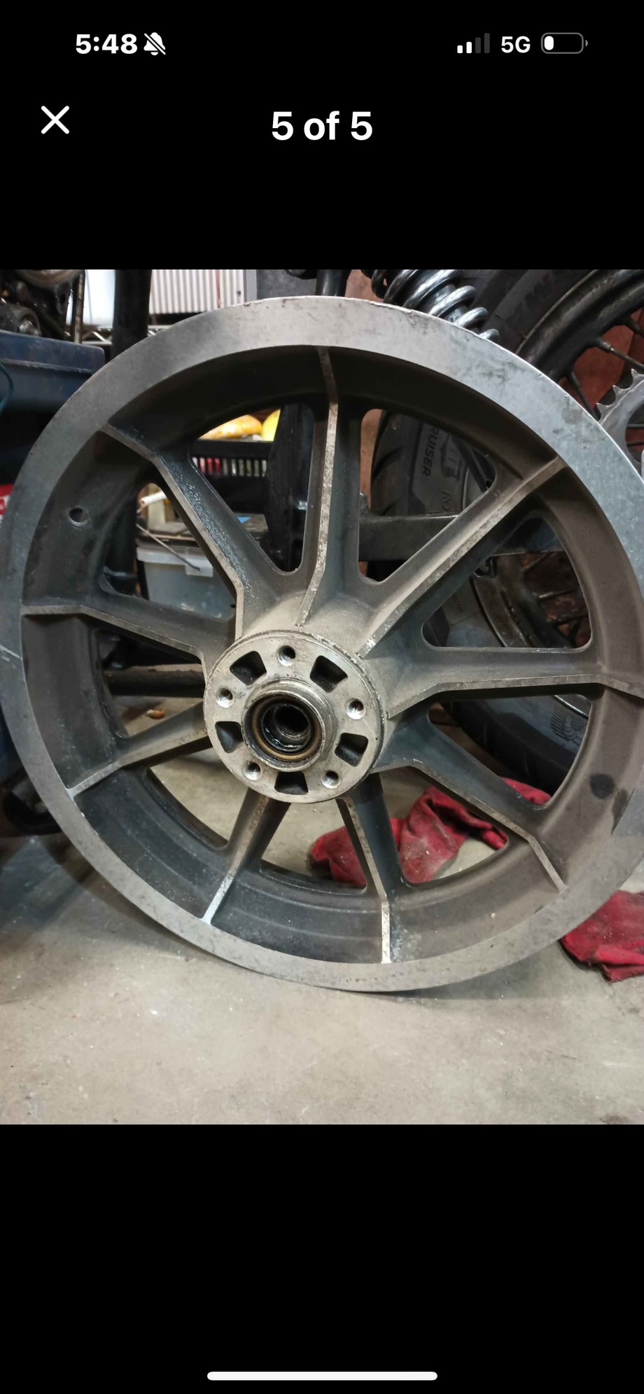

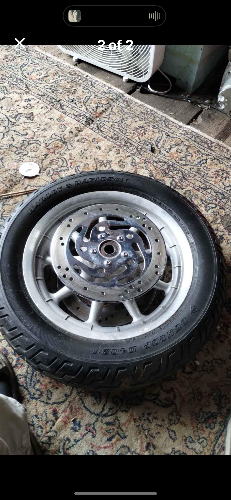

Hello everyone, I’ve been eating to get some new wheels for my 2008 fat bob. I wanted to see if maybe these wheels would work. I know new spacers would have to be made. Other than the axel size would they work?

The width of the hub on the rear wheel you’re looking at is probably 7 1/4”. The rear hub on a Dyna wheel is 6 ž”. So it won’t fit. The front wheel you’re looking at will fit the fat Bob front end but you’ll have to figure out the spacers needed.
even if it’s the fat bob wider wheels and tires?

Yes. If you take your rear wheel off and measure the hub it will be 6 ž”. FL Softail rear wheels are 7 ź”.

Hey so a set up like this, could this be done on my fat bob. I’m unsure if the bearings would work. On past wheels I’ve bored out the lip for the 3/4 axel to allow my 25mm axel sleeve.
adding more info to my question: could I essentially use sealed 25mm bearings on a set up like this.
