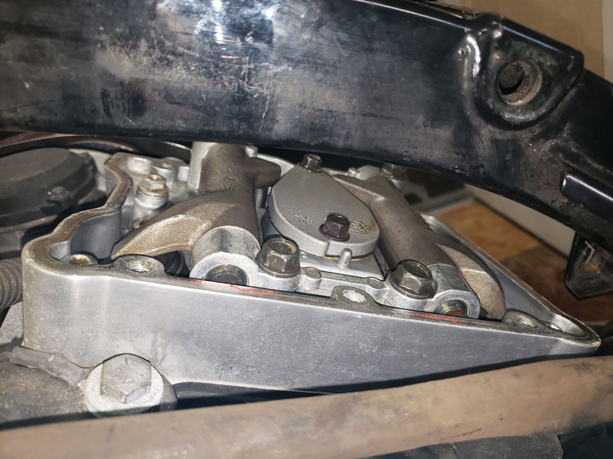

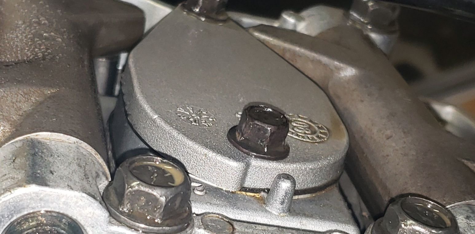

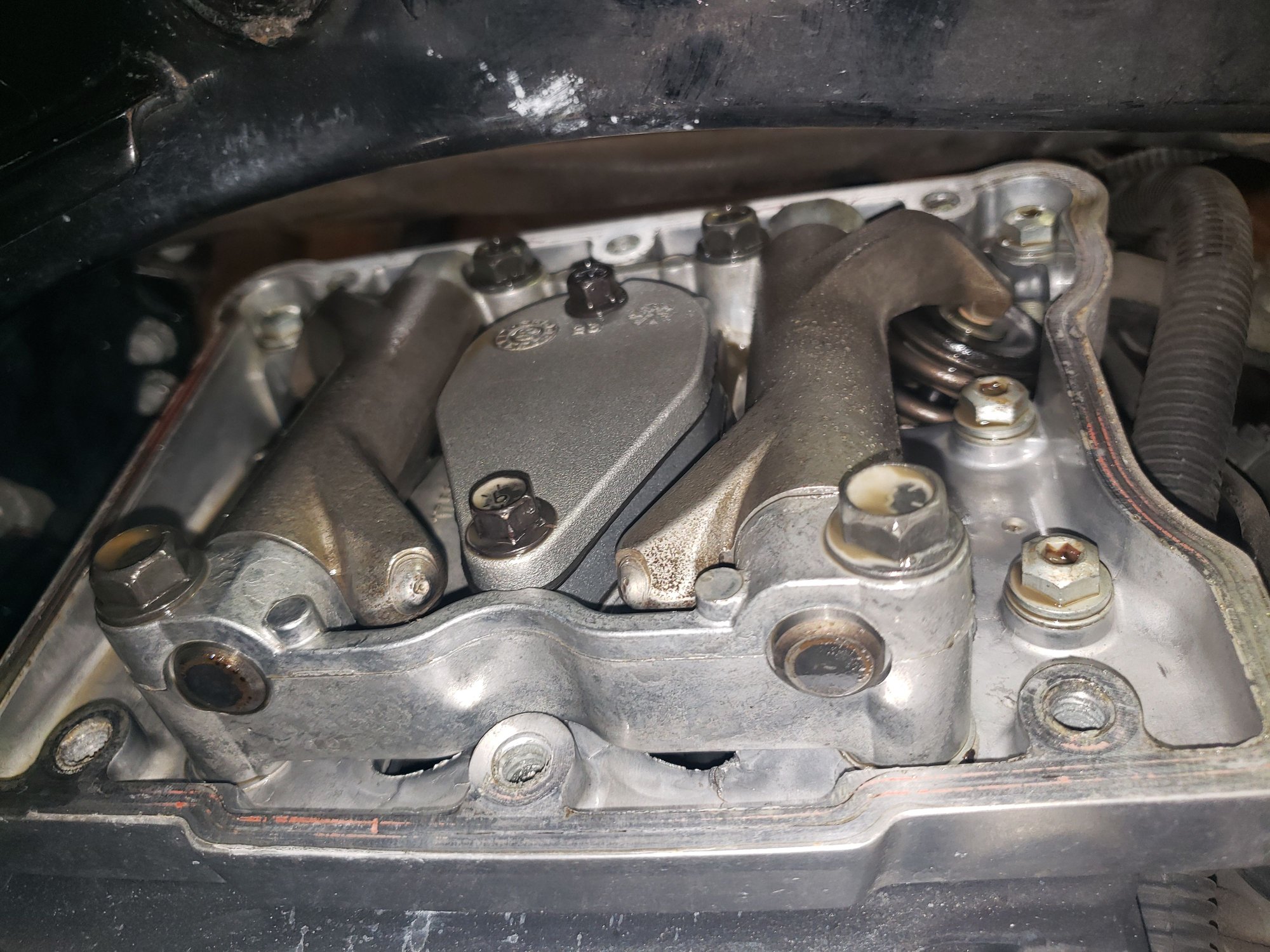

I pulled off a valve cover. Looks like 08 is stamped there. Here is a pic of under the valve covers. It is a clean engine. I was surprised on how clean it was.
If you enlarge the last photo on the cover you can see it has an 08 calendar stamp.

What's with the oil.. Looks like muddy water.
Yeah Max looks like a lot of moisture in that motor either that or breathers aren't working properly..

Water in that oil for sure. It could come from starting it to hear it run then shutting down. never runs long enough to cook off the moisture.
Remember back in the day when we first started driving our old points distributor Plymouths, especially the 225 slant 6.. We didn't know much about maintenance then but if you pulled the breather off the valve cover man there was always Brown goo, sort of like what comes out of the cam position sensors on the Evos.. LOL..
Come to think of it the posters Brown goo up in the rocker assemblies is definitely an indication of whoever owned it would start it in the garage or outside for a little bit thinking they're doing it good and then shutting it down.. like Max said not cooking the moisture out of the oil all the way..
Those are the old style, cast breather assemblies, #17650-02. They were replaced with the newer stamped style breathers, #17025-03A.
I didn't know any Twin Cam engines still used the cast breathers after 2004 or 2006......
