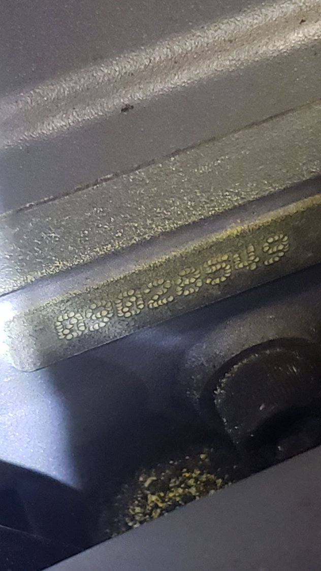

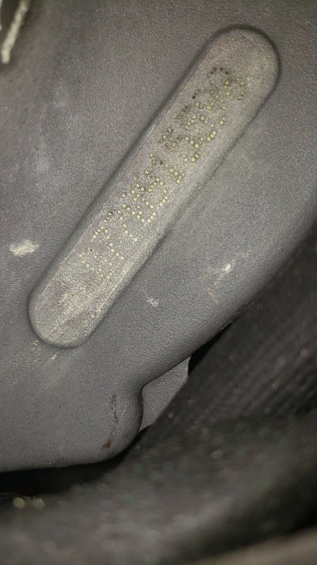

Right side just aft of oil filter head - 0770915598
Left side on the transmission case just past the bottom of the transmission cover - 09028549
Left side between the bottom of the cylinder housings - *GM49305475*
I believe the third number that starts with the star is the engine ID number. The engine is married to a 6 speed transmission which makes it a post 2006 transmission. The 9 would indicate that the engine is post 2009. The 4 would indicate a Twin Cam 88 engine - if I am piecing the numbers correctly.

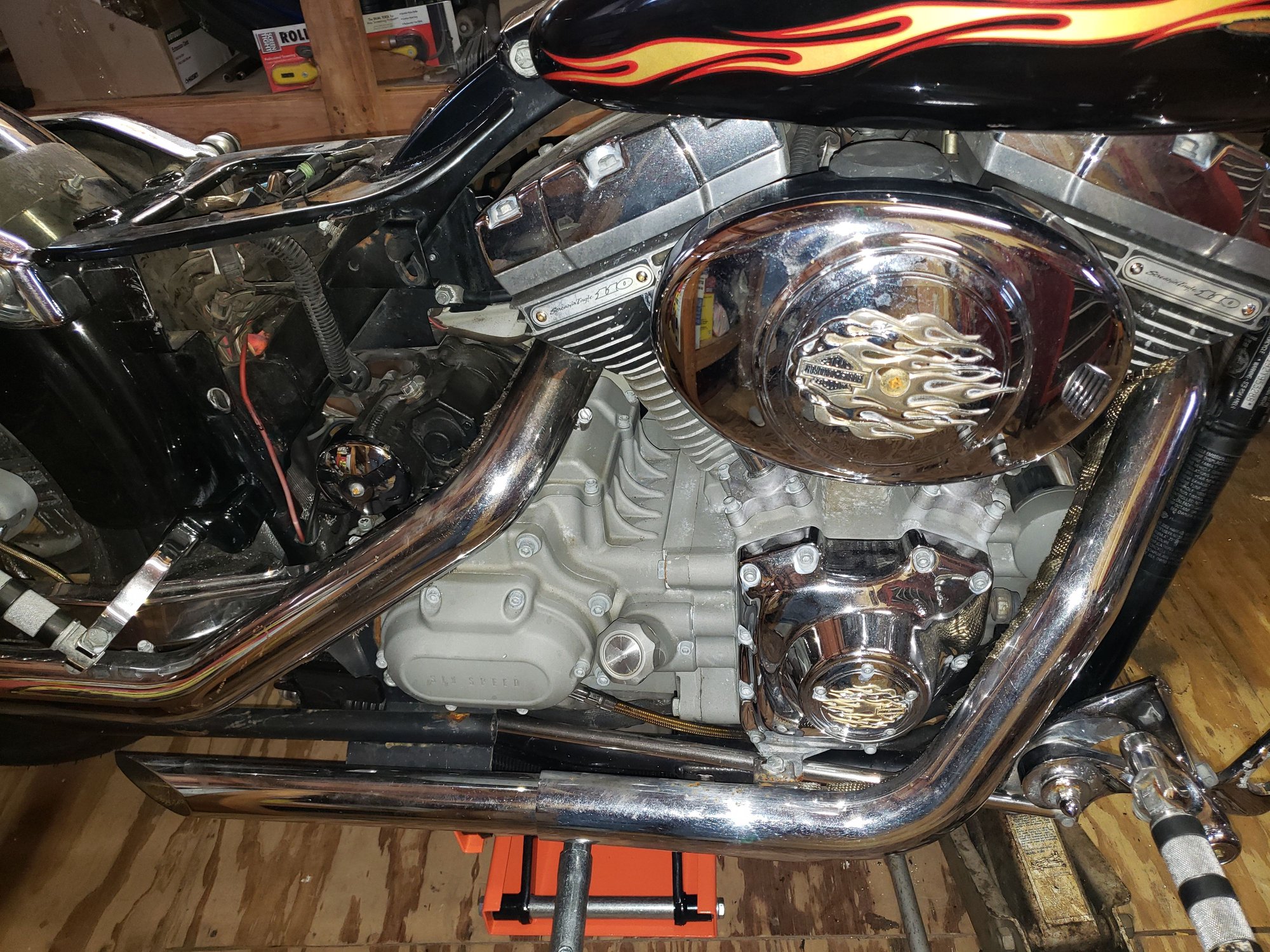

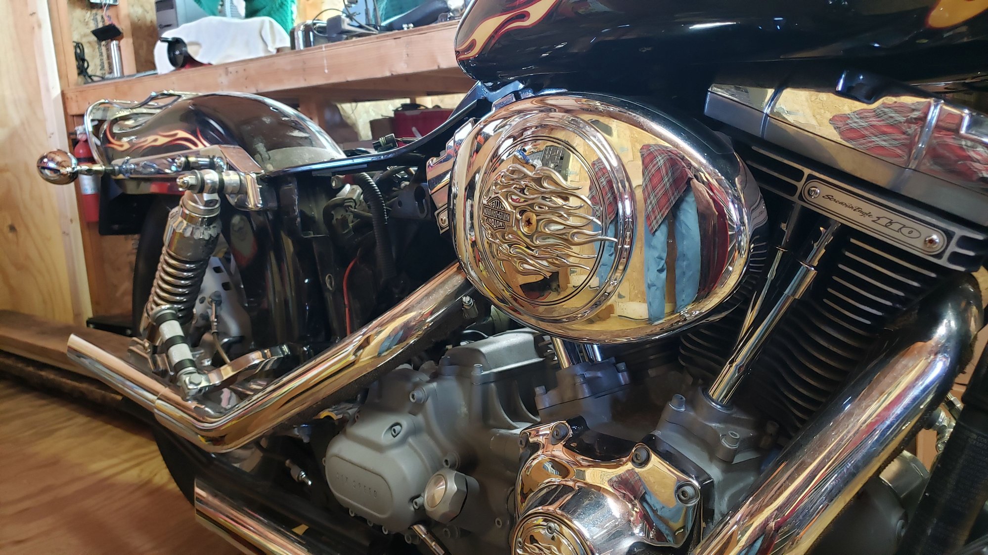

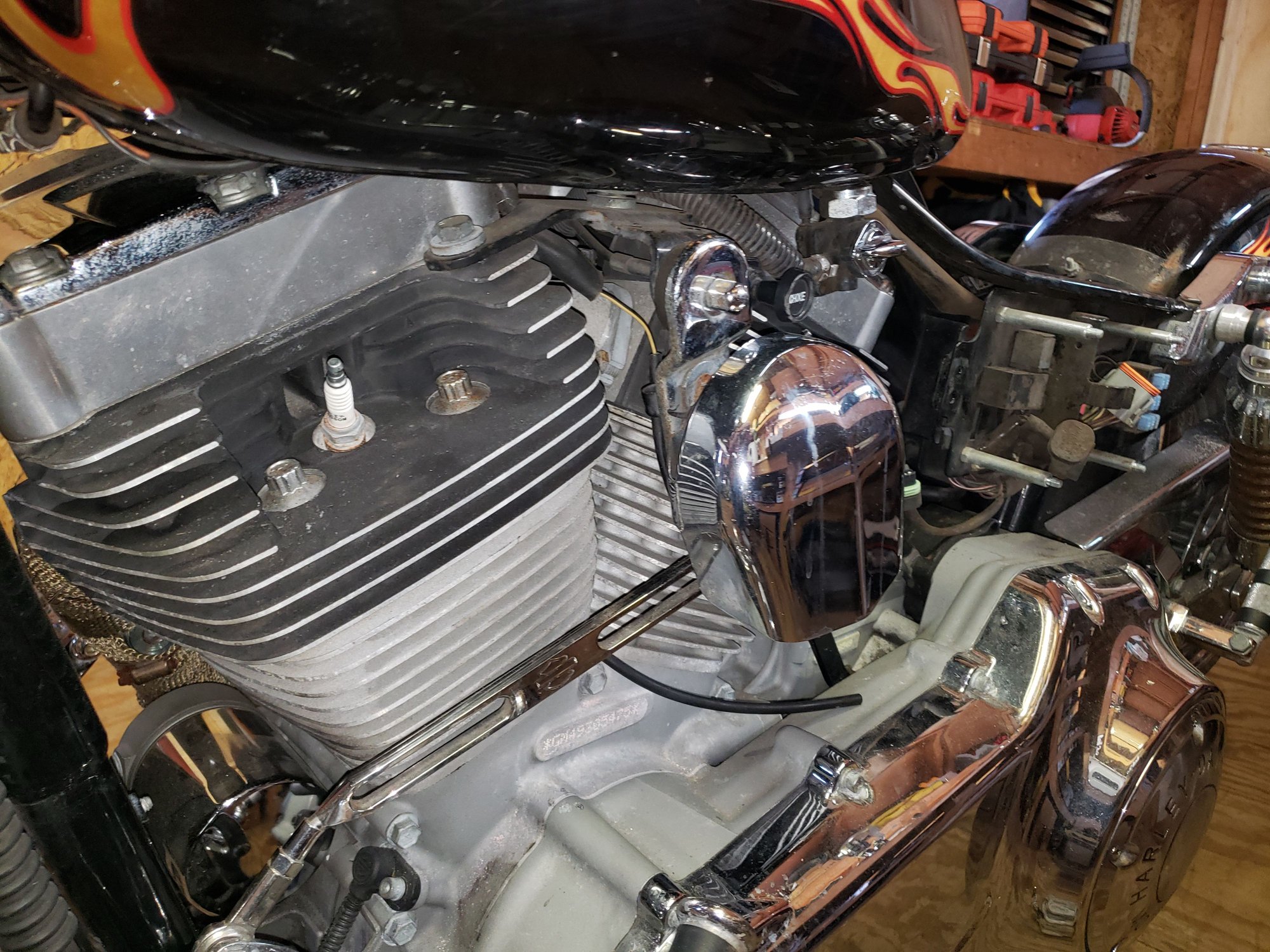

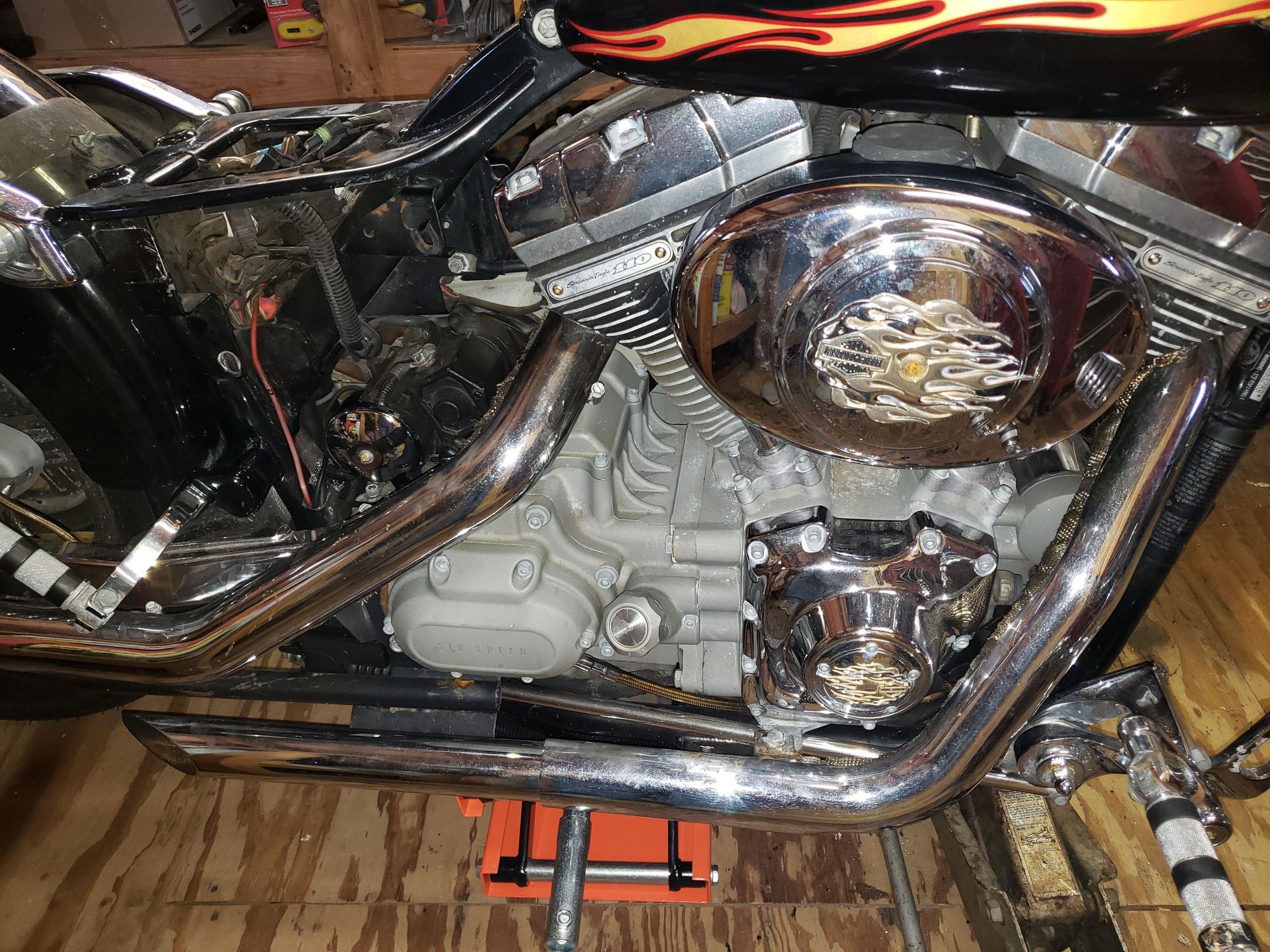

How about a pic of the whole motor? Both sides.

The EIN (engine identification number) is the "GM49305475" number on the left side of the engine, between the base of the cylinders on the engine case.
"GM" = model - FXDI (Super Glide)
"4" = engine code - 1584 ESPFI (96" EFI)
"9" = date code - 2009
"305474" = last 6 digits on the VIN the frame the engine was shipped from the factory in.

Your engine number seems to fit the 2009 vin decoder for a FXD
GM = FXD 4 = Twin Cam 96 9 = 2009
This has to be a crate engine as the engine last 6 do not match the VIN last 6 of 953288. I guess it could be a take off but the Black/Silver scheme of the engine was reserved for the CVO models.
Also this is a carburetor engine not ESPFI. I'd be lucky if it was a Electronic Sequential Port Fuel Injected engine. Of course that just means more stuff to go wrong on it.
The 1584 CC Air Cooled Twin Cam, is that with or without the SE 110 heads? I tried to find numbers on the SE heads and cylinder casing but could not find anything.

I thought you posted the bike was repowered, and the pictures you posted are on the engine from an unknown source, or did I misunderstand?
The last six numbers "305474" of the engine identification number, are supposed to match the last 6 numbers of the VIN on the frame of the bike the engine was installed in at the factory. If they are on an engine in a repowered bike, they won't match that repowered bike's frame VIN.
Since the EIN is on the cases, and this is a custom application of that engine, IMHO, there is no way to say if the heads, cylinders or any other engine component, came from the factory on that engine...
All I can say for sure, is that the cases on that engine in the picture, came from a 2009 Harley Super Glide that was delivered from the factory with a 96" EFI engine and had the last six of its frame VIN as
"305474". Anything else on that engine could be from any other compatible source.

You got it right. The current engine, the one in the pictures, is the replacement engine form the Twin Can 88 engine that originally was on the bike. I was told that the engine was replaced at some time but the last owner had no information on it except "the engine was replaced about 7K miles ago".
As it is a repowered bike, I knew that the last 6 numbers would not match the VIN stamped on the frame as the engines were two different engines, thus 2 different ID numbers.
I do understand that there is no certain way to tell if some of the engine parts on the repower engine came from the original. Thats one of the reasons that I am trying to find out everything I can about the replacement engine.
There are no EFI sensors on the replacement engine. This is a carburated engine. I have the 2002 FXDWG3 shop manual and this replacement engine is as close to 2002 stock. Thrre are no electronic upgrades that I have been able to find.
