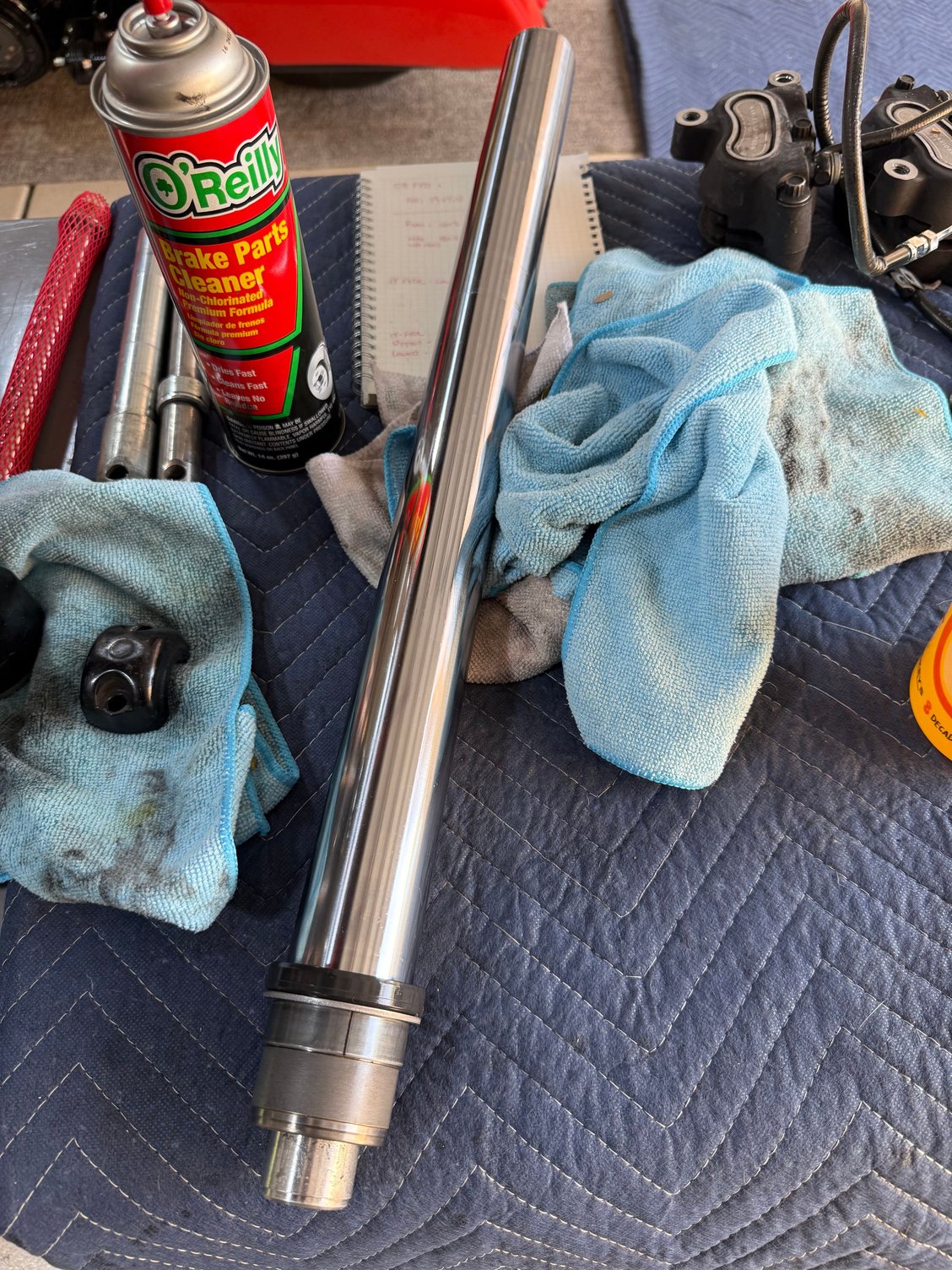

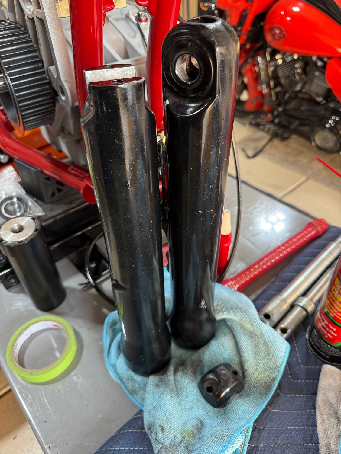

Got the front forks broken down, need to make a few small cosmetic repairs on the lowers, then will get them and the wheels out to powder coat.

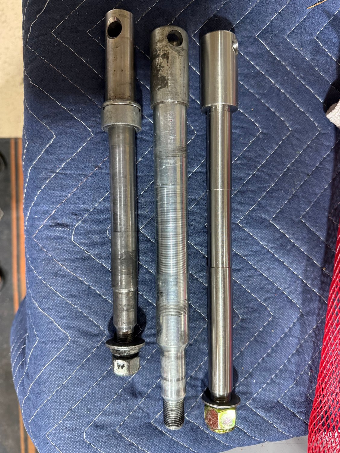

Did some measuring so I can make some spacers for the longer axle. Pretty sure I will have to make some hub spacers also to get the brake discs out a little further , or I can space the Brake calipers inward. Anyone have any insight?
Tubes are in good shape fortunately, one thing at least to save some cost.
Few small dings I need to weld back in and clean up. Overall in good shape.
Stock FXD axle on left, Stock 49mm axle in middle, and the Vulcan conversion axle on the right. Definitely going to need some spacers.

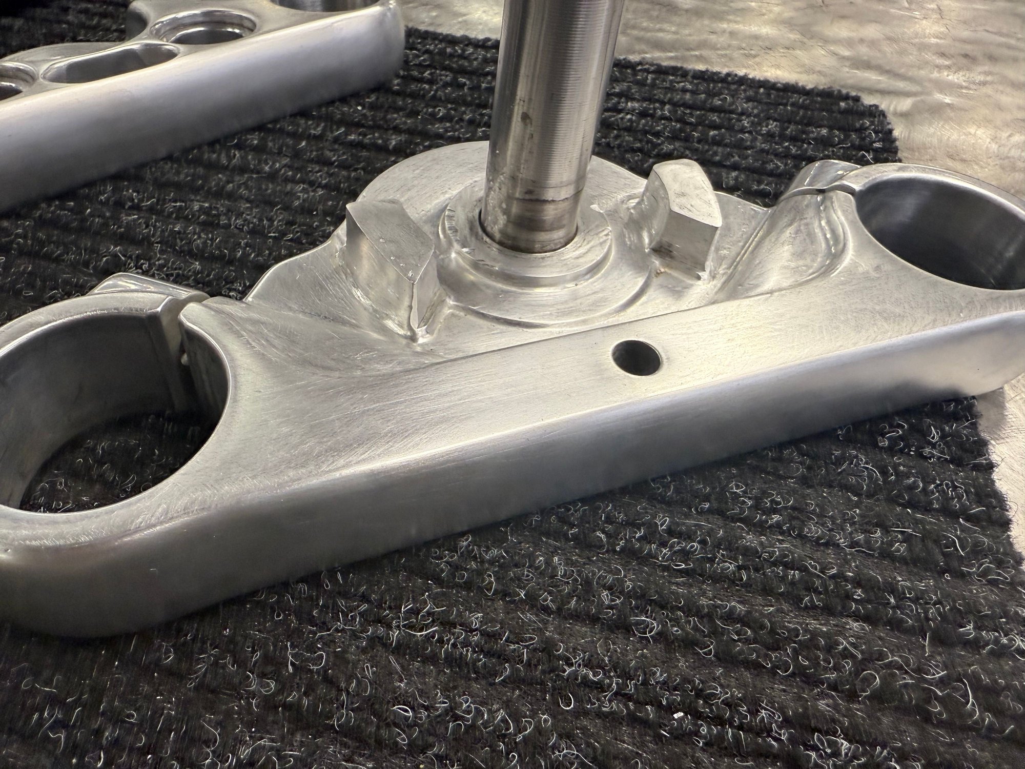

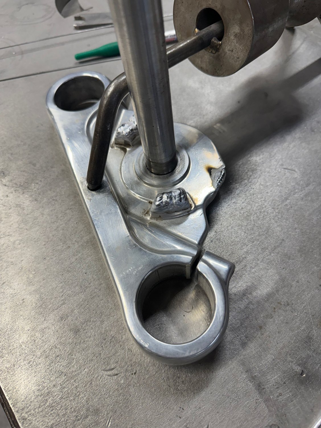

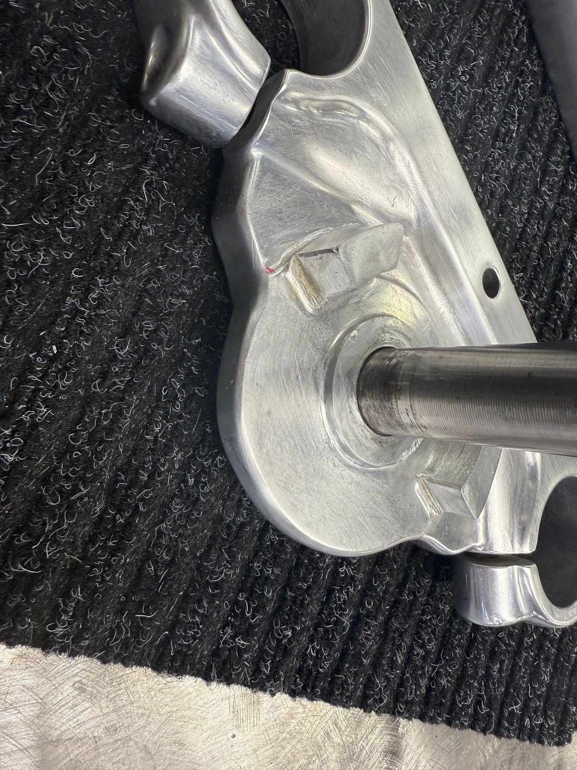

In keeping moving forward, worked on the lower tree. The fork lock on the later model bikes looks like it is a pin that is engaged into a tab that is on the lower tree. It would not have been in thew way but looked odd. So I filled the hole with weld, then ground it off to look like the other side. Also added weld to the fork stops to make them taller so they hit the frame correctly. These, the fork lowers, and the wheels and the fender rail covers will be going to powder coat this week.
Once I get those back progress should take a big jump. Hopefully it wont be 110 in the garage either. I have a small a/c I can run out there, but no money left to run it after buying that swing arm.
Cut off the fork lock tab and added some weld to make the fork stops taller so they engaged with the frame properly
All cleaned up and ready for powder

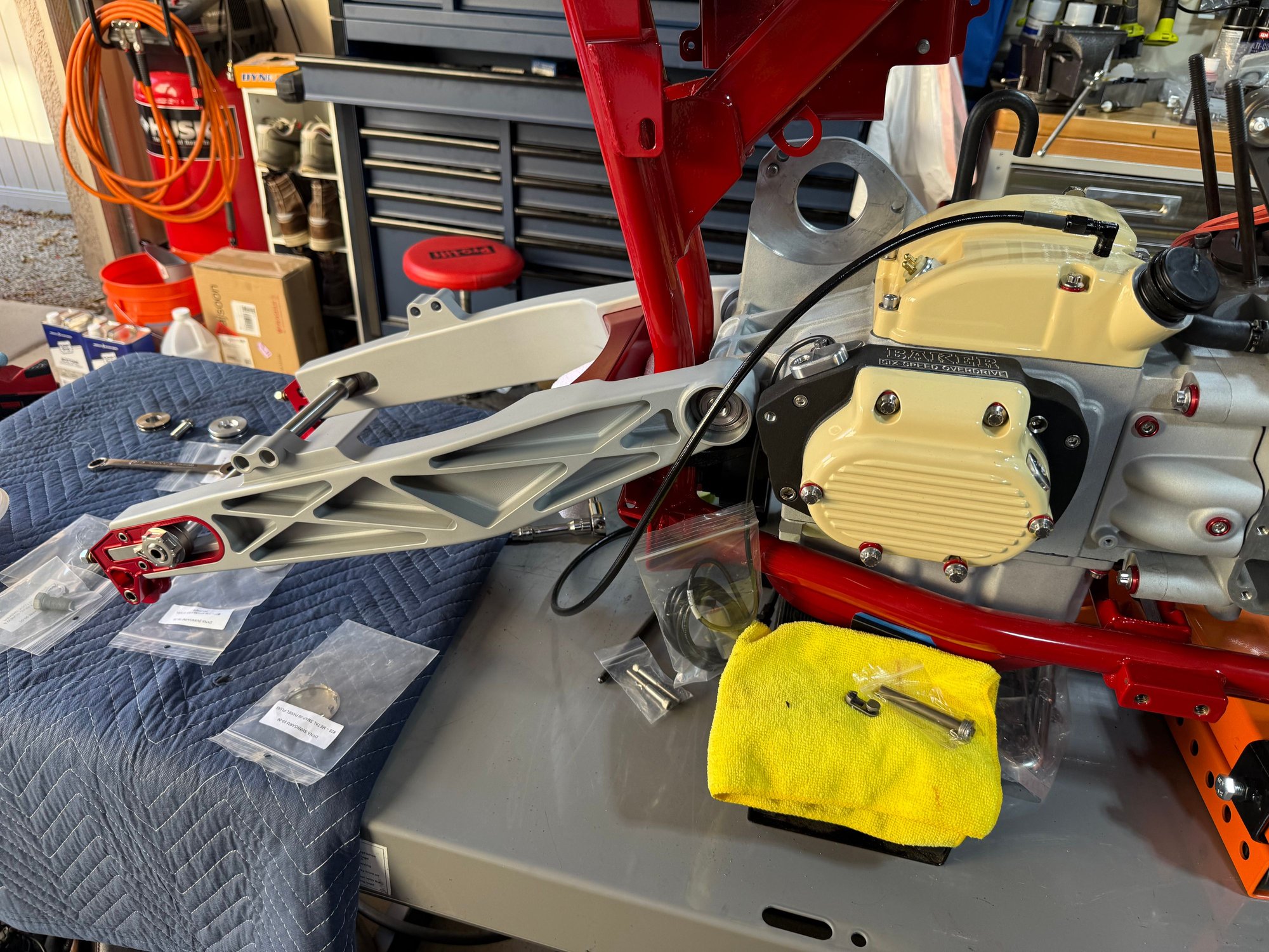

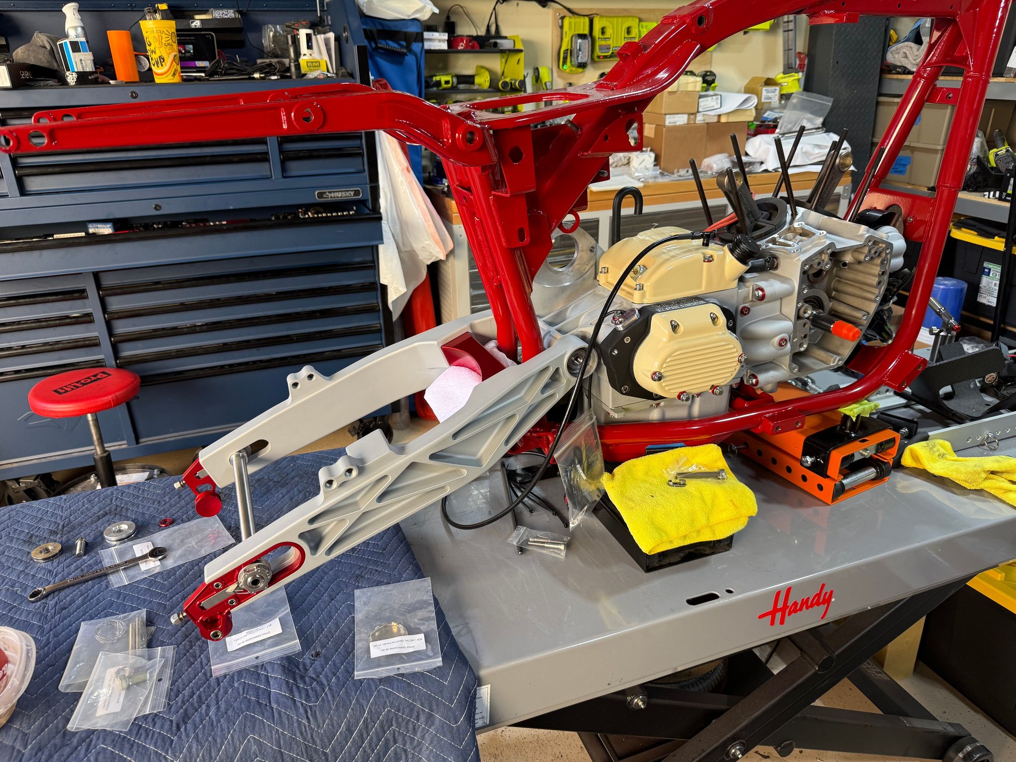

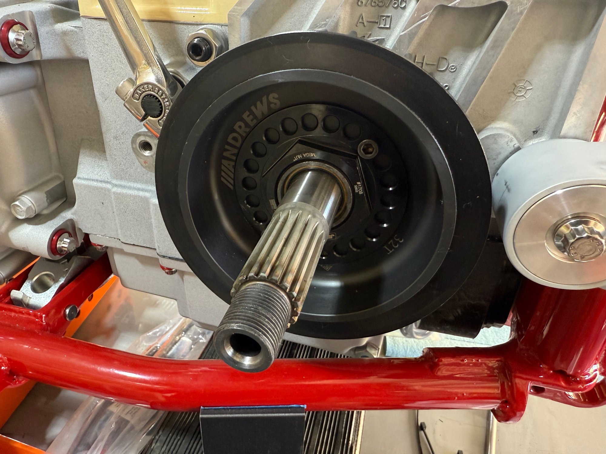

Swingarm arrived and got it installed. This thing is f$&@ing sweet. Very well built and finishes are top notch.
also got he new transmission pulley installed. Used the Jim’s Mega Nut. Was so much easier than the stock setup. Didn’t have to uninstall and rotate spline by spline the get the holes to line up. Found a hole first shot within specified torque range.
Started working on getting primary mounted, but somehow I lost the mid control inner shifter shaft. Need to get everything organized again, limited space makes this process a little hard.
Is that a test fit? Shouldn't your inner primary cover be installed?
