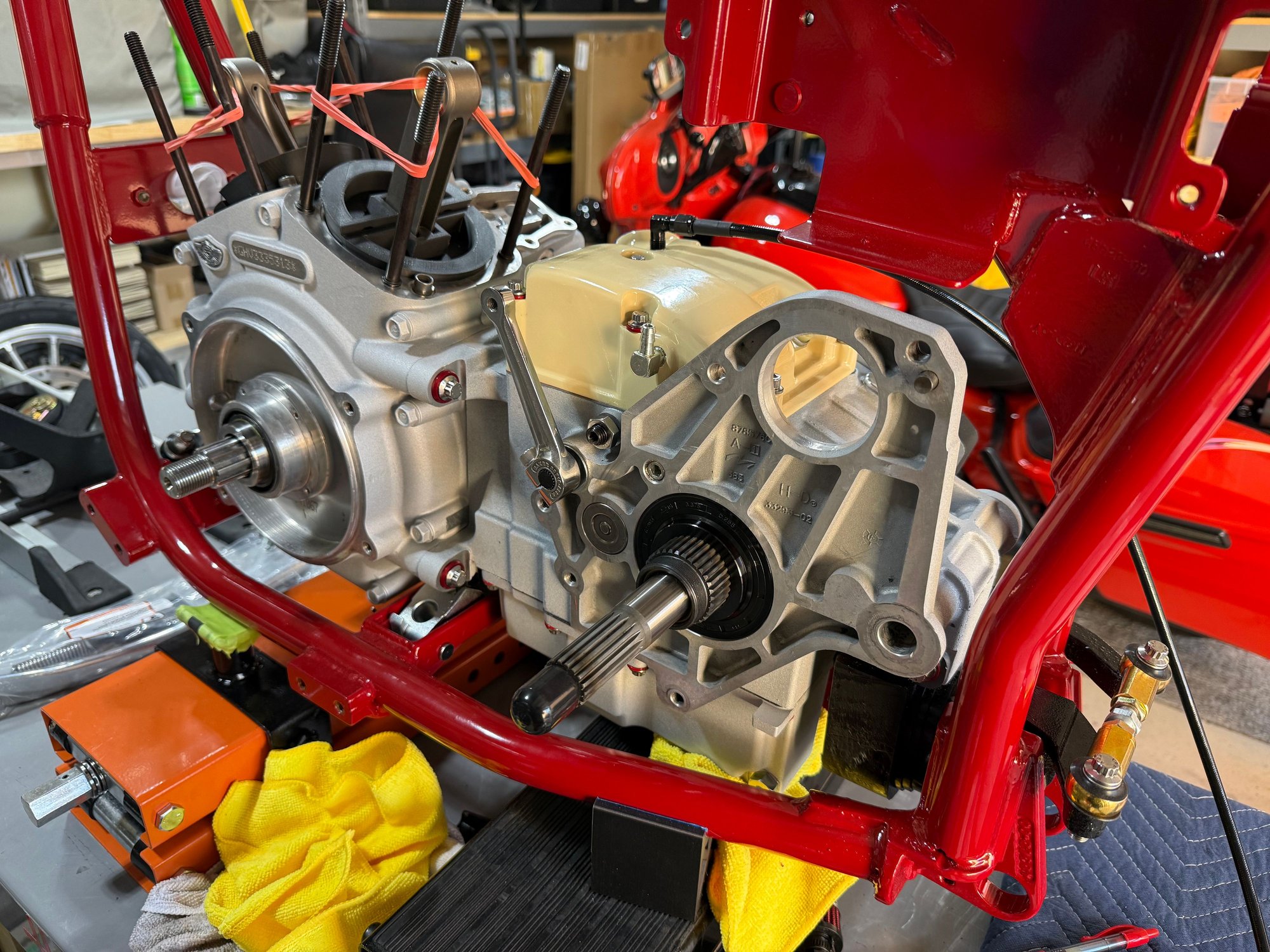

Got the short block and trans case mounted on the Glide Pro engine mounts, and got the Sputhe Stabilizer in. Got everything leveled to the frame, and installed the new Jiffy Stand mount. So much easier to do when everything is out of the way. Will get the transmission installed next, then work my way to the primary. In between I need to mask off the heads and jugs and touch up the paint on those.
Side Note: Called ARP and they would only say “powder coating the washers and using them under max loads would not be recommended”. I then called up a colleague I work with who is a structural engineer, and while he doesn’t do automotive he does some pretty wacky stuff. His opinion was if this was a racing application where everything was under max loads all the time he would not do it. Also anything that would get above 400 degrees, which is the suggested max temp of the powder coating, he would also not use them there. But in a “typical” use it should not make much of a difference, but he would suggested using a split lock in addition to the flat if possible, and also fasten everything to the max torque of the range and use loctite on everything. He is also a rider and understands that motorcycles have fewer fail safes then a car, and said he would be entirely comfortable using them. So for anything high heat, I will either use a hard anodized washer if I can fit it or just a plain SS ARP Washer and for the other areas it will just depend.
So easy to install when nothing is in your way.
You missed a few ARP's

Got a few covers done this week. Using the little Eastwood oven means one at a time. Much better that all the mess is at the shop though and not my garage. Daughter home from college also, so been a slow week.
Next up is the camchest, then the top end. Killing time until the swingarm shows up.
ARP not going to fit on trans cover.  Will pick up some polished SS SHCS to use here. Added the Fuel Moto trans vent.
Finally found the quad seal in my stack of **** so I could get the backside of the trans covered up.  Going with the Bearing conversion for the race.

For all the effort and expense you're putting in im surprised you wouldn't find someone to turn down the flanges on the ARPs to make them fit.
Old Jun 30, 2025 | 07:32 AM
  #79
malfvnction's Avatar
malfvnction
Joined: Jan 2019
Posts: 177
Likes: 149
From: Las Vegas
Can do that myself. But if the flange don’t fit, a socket won’t fit.
Old Jun 30, 2025 | 07:38 AM
  #80
GLFLSTCI02's Avatar
GLFLSTCI02
Joined: Apr 2010
Posts: 64
Likes: 70
From: Eastern Ontario
Just the other day I spun down the flanges on both the ARP 12pt that I used on the rear of the trans top cover, 12pt socket and the box end wrench fit fine on the bolt head. You won't get a washer under there though.
