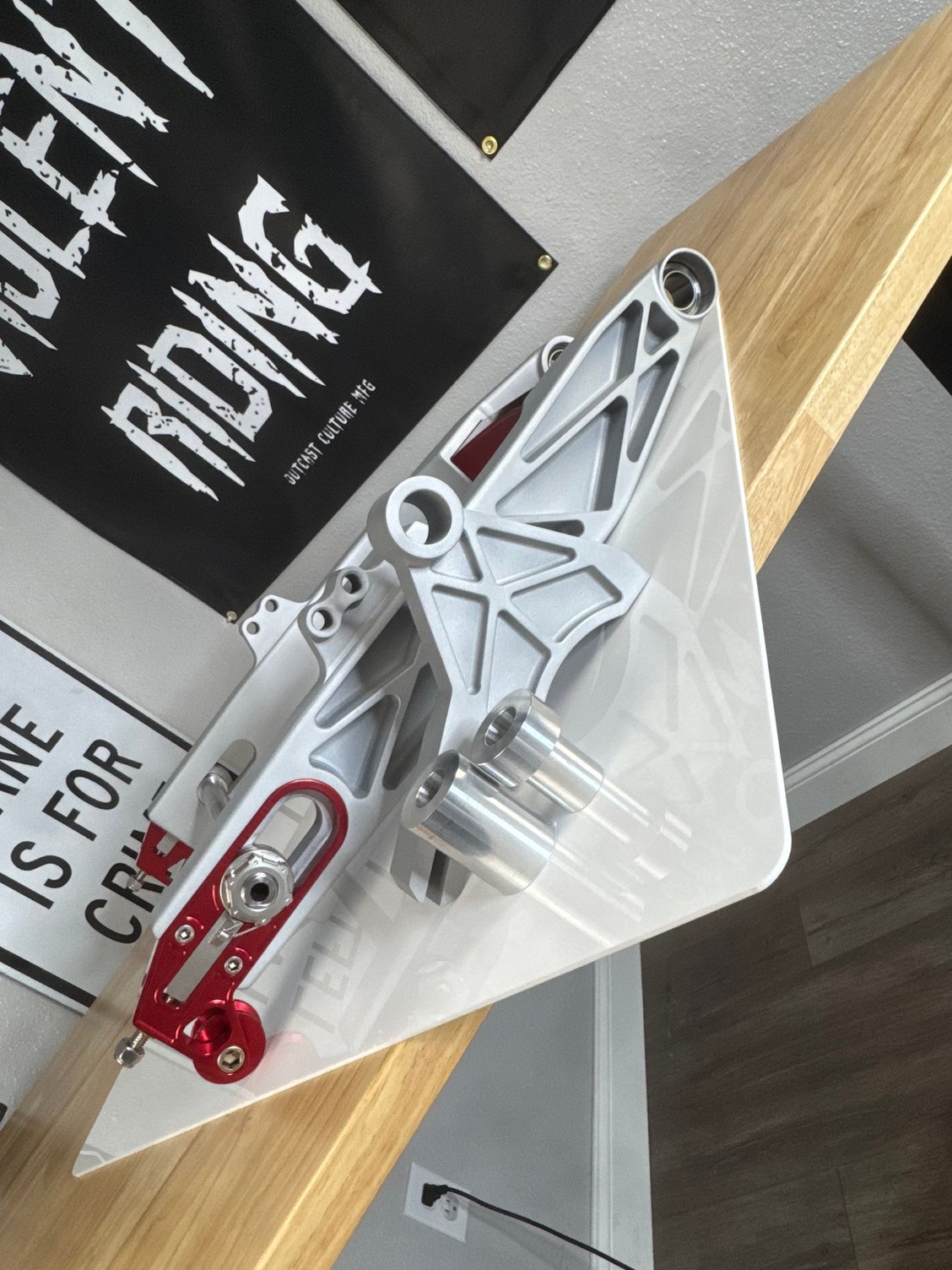

Was just talking to Speed Dealer and they sent me a quick preview of my swingarm. Can’t wait to get this thing on.
Cerakoted to match the HD Blonde motor, and red anodize on all the trim parts.

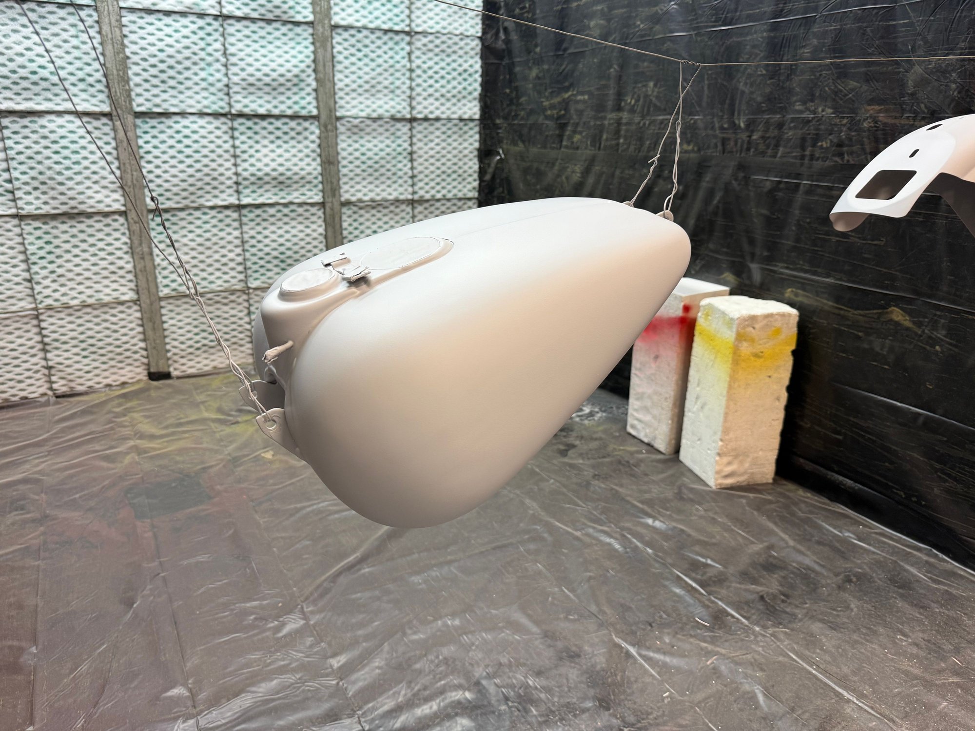

Started getting the tins prepped. Since I am
switching to a 49mm front end I had to order the from fender. That should have significant less prep than these did. The previous owner decided he didn’t like the 100th anniversary blue, so he taped over the center line, then applied somewhere between 3 and 300 coats of black paint. Not sure what the paint was but had to go all the way up to 36 grit to get it off. Hammered out a few dents in the fender and got them primed. Waiting on the high bills to cure, then will sand one last time and start getting some color on them.

That swing arm is killer....
Who makes it?

Speed dealer
https://speeddealercustoms.com/colle...son-dyna-99-06
