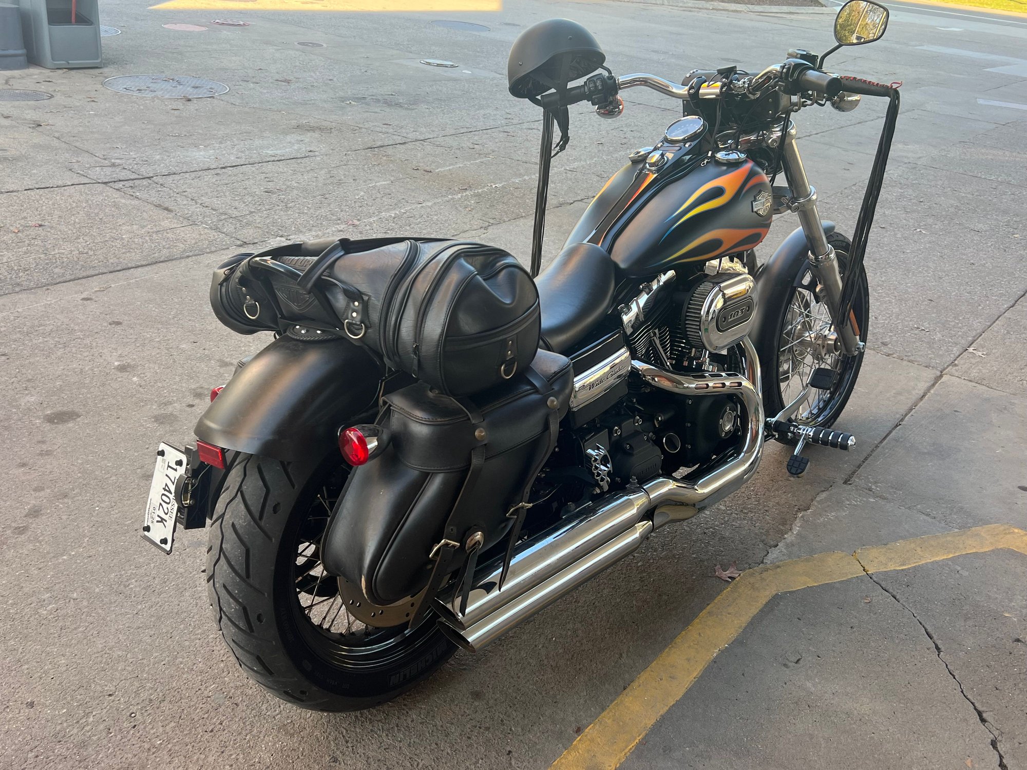

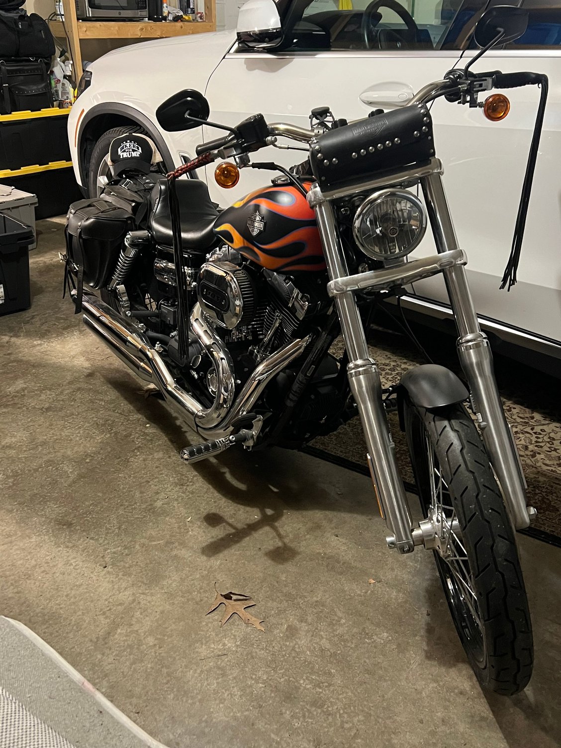

It looks like a high flow air cleaner has already been installed. Did the late model Dynas come with that air cleaner?
