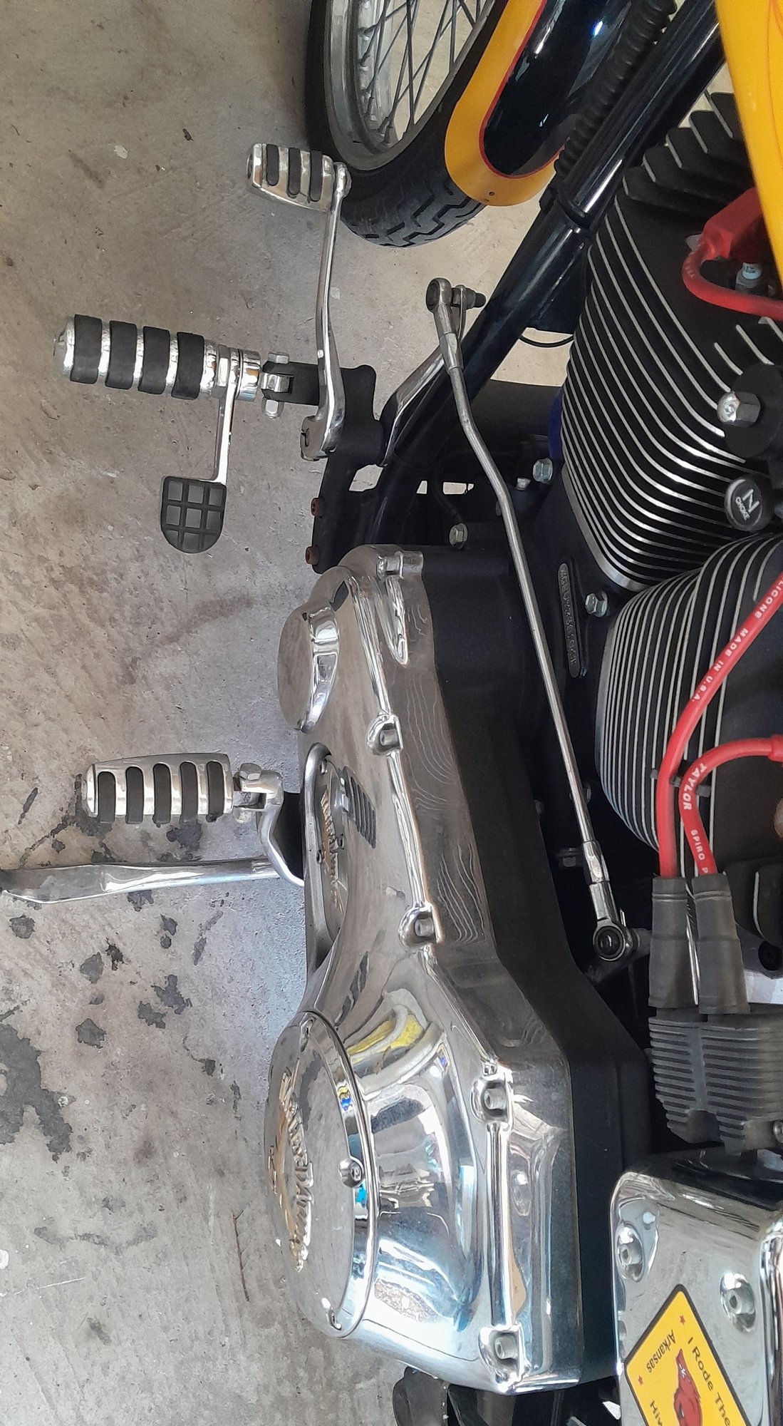

There's no adjusting the mid-controls. I found this mid-control extension kit. This moves feet 2" forward.
https://www.denniskirk.com/bikers-ch...rd/5702969.sku
For the forward control conversation, you can order from H-D online and pickup at your nearest Dealer. This moves feet 11" forward.
https://www.harley-davidson.com/us/e...ls/p/49080-06A
Picture of my bike for reference. I added Mid-pegs but, I never use them.
