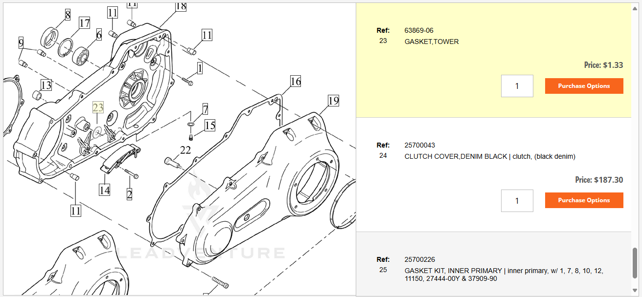

So the repair here is pull the outer primary and replace the seal(s) on this shaft ?

All you should need to get things fixed up is #23 and I'd probably replace #16 instead of trying to reuse it.

That's pretty much it. Get the bike level, pull the left foot peg assembly off, drain the primary, pull the outer primary cover, clean the mating surfaces and replace the $1.30 gasket, use a new primary gasket and replace the outer primary, refill, replace other parts you removed and you're done. It's a pretty easy job.
Go here and look up your bike, you'll find all part info you need.
Genuine Harley-Davidson OEM Service Parts | Harley-Davidson USA
