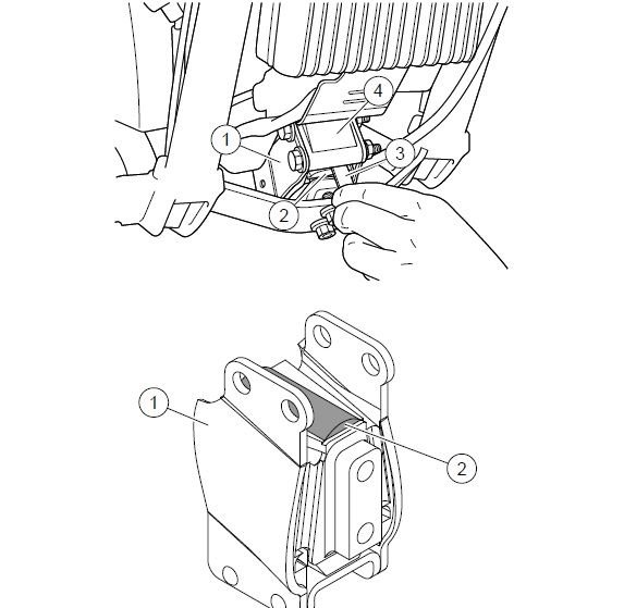

Awesome info.. Curious what the change is as they look identical, at least from what I see. Thats a solid cast part. Currently my sons Metric Bike is on the lift shimming valves and waiting on parts but s soon as thats off, the WG is going up for a thorough inspection of said items. I was leaning toward rubber either played out and its a metal on metal thing or rubber is very rigid from age and sitting, Low miles on Bike and it sat for a number of years up until last summer when it had a complete tip to tail inspection from a Harley Shop that cost north of 2k when done in labor/parts/tires. I do know the mounts passed but they usually do visually look fine unless trashed. I have the inspection sheet.

I suspect you will find part 4 in the upper figure touching part 2 in the lower figure. If so, I would replace both front and rear mounts. Don't bother trying to fix it; at best you'll buy yourself a couple of months. Failure of the front mount stresses the rear mount, so replace it as well. I went with the Predator front mount, but they don't pay me to tell you that.
(Part 3 is a 0.020" feeler gauge)

Looks like the images I see between the different part numbers for the engine mount are possibly related to that threaded hole in the newer version, ground screw possibly? Not to sure. You can see hole in the image 14 posted by CoolBreeze3646, not there on any of the older part numbered ones I found online for sale.
