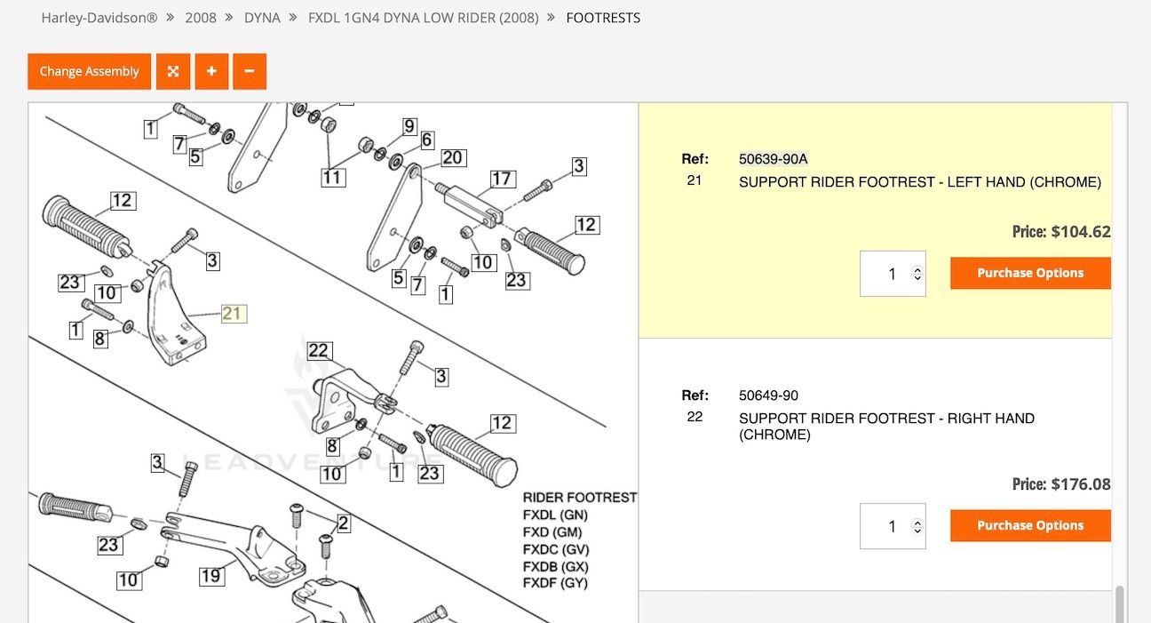

With that said, I'm wondering if anyone has... or if there's any reason not to... add a set of mid position rider pegs from another Dyna model. From what I can tell, looking at the bike, the WG frame appears to be drilled (and tapped?) for the mid position footrests with what looks to be rubber (?) plugs sealing up the unused holes.
If all that's true, I would think all the mid position footrest parts for other Dyna models, should bolt right on to a stock WG. But can anyone tell me if dual brake and shift controls, (both mid & forward), would be achievable with HD parts or reasonably modified HD parts. I wouldn't want to do anything that couldn't readily be returned to stock.

I have never done that particular mod, but I switched mid controls to forward controls on a '16 Low Rider.
Per the HD Online OEM parts finder, both frames look to be the same past the neck. The Wide Glide has a 34° rake while the Low Rider of the same year has a 29° rake.
They both have the same mid foot peg mount holes on the frame.
I have seen, and read about, people using forward controls, with mid pegs for a different foot position. Most had mid controls first and switched to forward controls,
I believe the mid foot peg mounts from the same year would do what you want, but you may need to grind off the left side mount brake pedal mount.
Also, check to make sure there is no exhaust obstruction issue. If you have aftermarket exhaust headers, check their fitment guide to make sure they don't say they will not work with mid controls. Barring that warning, I would be willing to spend the money to try the mod you are considering. Maybe look for the parts on eBay. it is usually cheaper than new OEM HD parts, but you'd be surprised sometimes what people on eBay are asking for prices. Always check to be sure the eBay parts aren't more $$ than new..

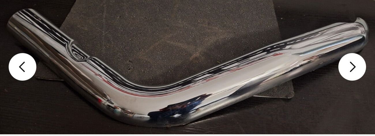

The exhaust is stock but the wide glide only came with forward controls. Other Dynas with mid controls typically had a cutout on the heat shield for the mid control.
yeah the mid control bracket comes over the pipe. It probably won’t rub, but if it does you can pick up a heat shield on eBay.
