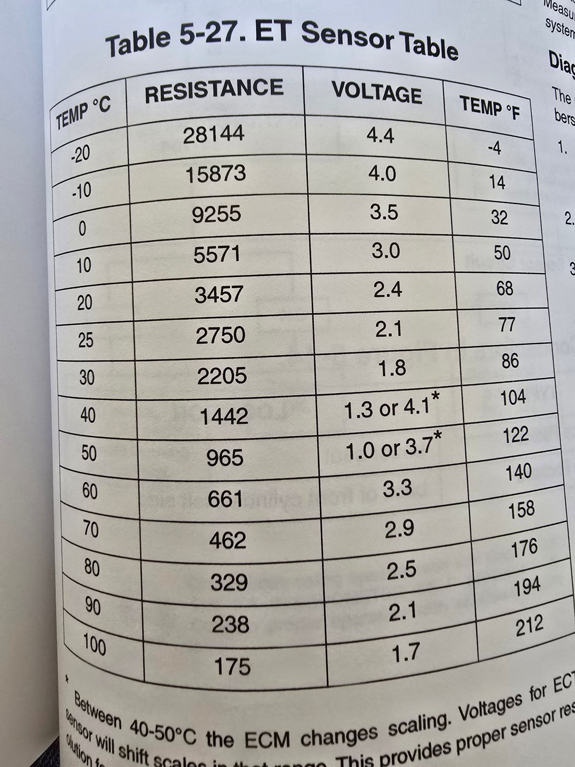

P0118 ET Sensor Voltage Open/High EFI
Check the connection to the Engine Temp Sensor. Measure the resistance of the sensor.

High is telling the ECU that the engine is very cold, <-4F, however, "open" is saying it's out of the normal range, too.

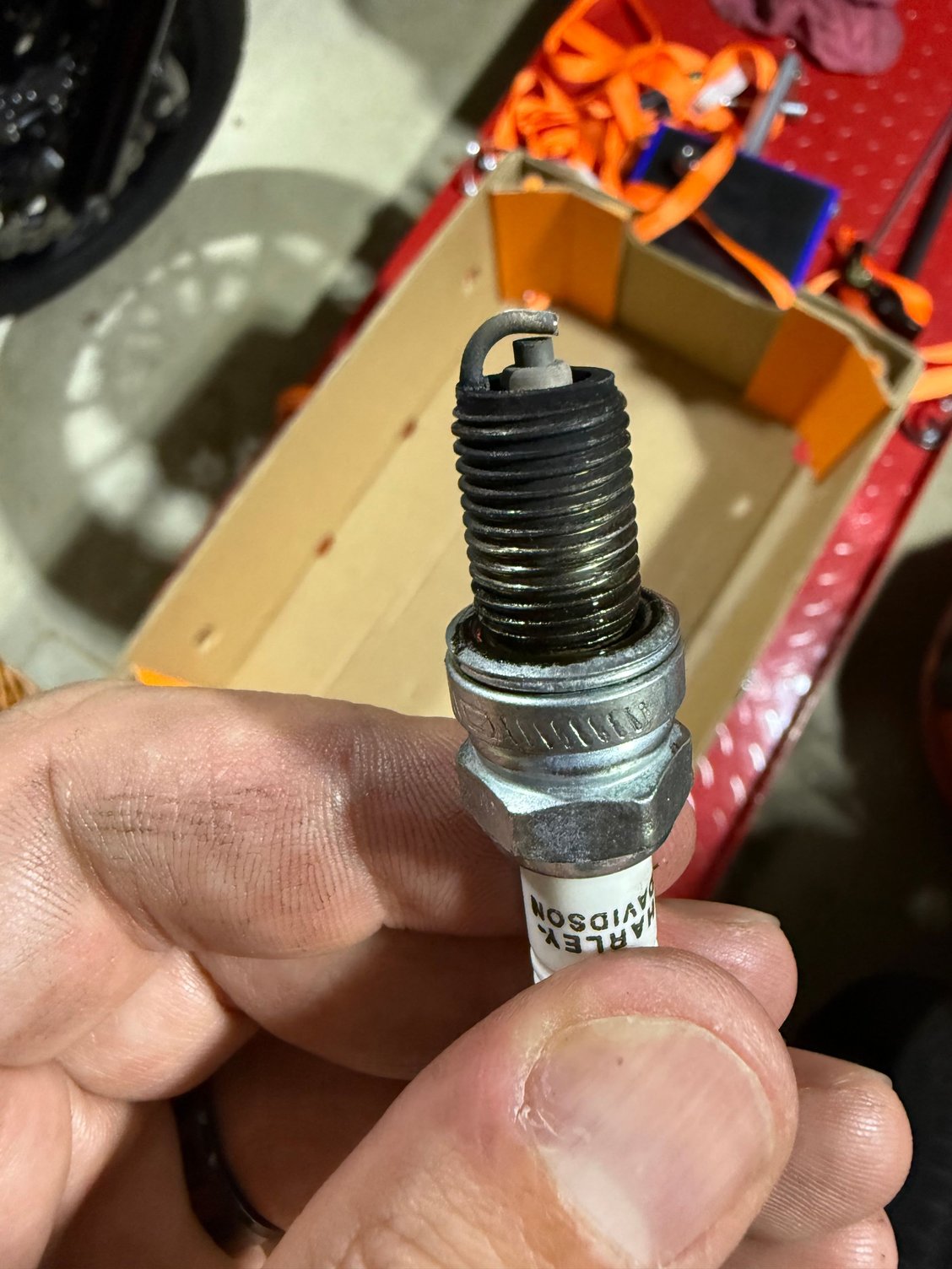

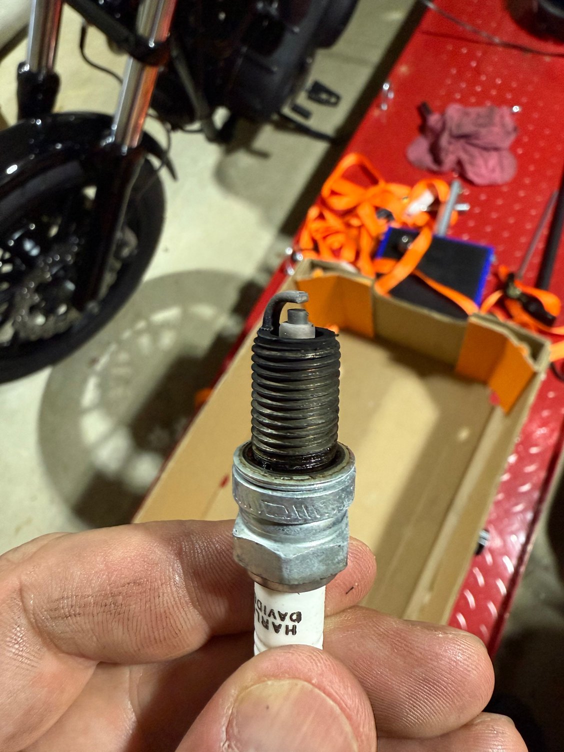

Swapped the plugs. I’ll take it for a ride tomorrow, pouring today. Here are some pics of the plugs. (I dropped the one showing no gap)
