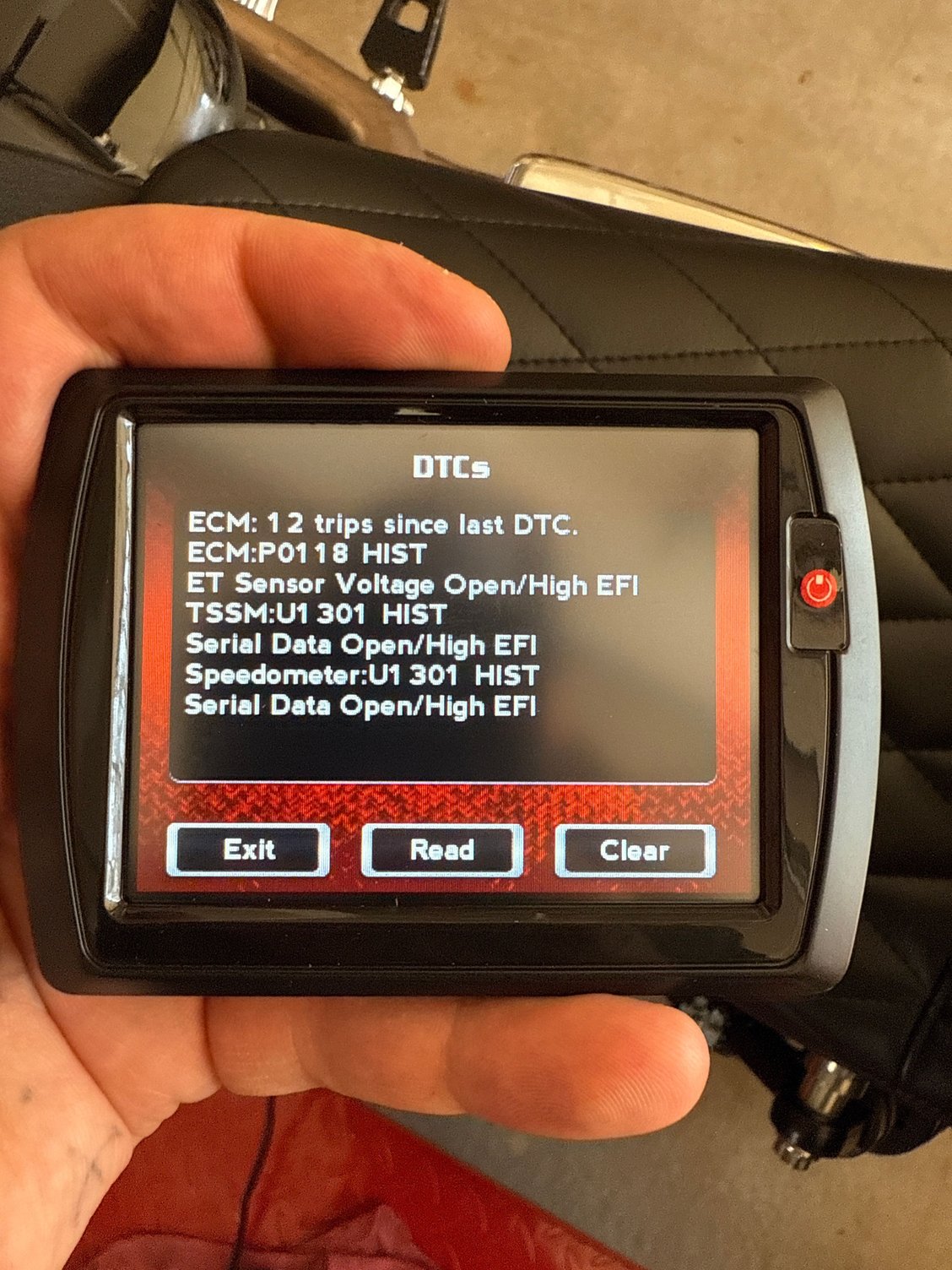

at 3500 it runs fine. Plugs were done a couple years ago. Could be worth changing. All fluids have been changed. Forgot to mention bike has an Andrew’s cam with a dynojet power vision tune. Just scanned it and I’m getting a p0118 code
That looks like a coolant temp code. Wanna try again?

Odd. Quite odd.
Those are historic codes. Clear them, change your plugs, see what happens.
