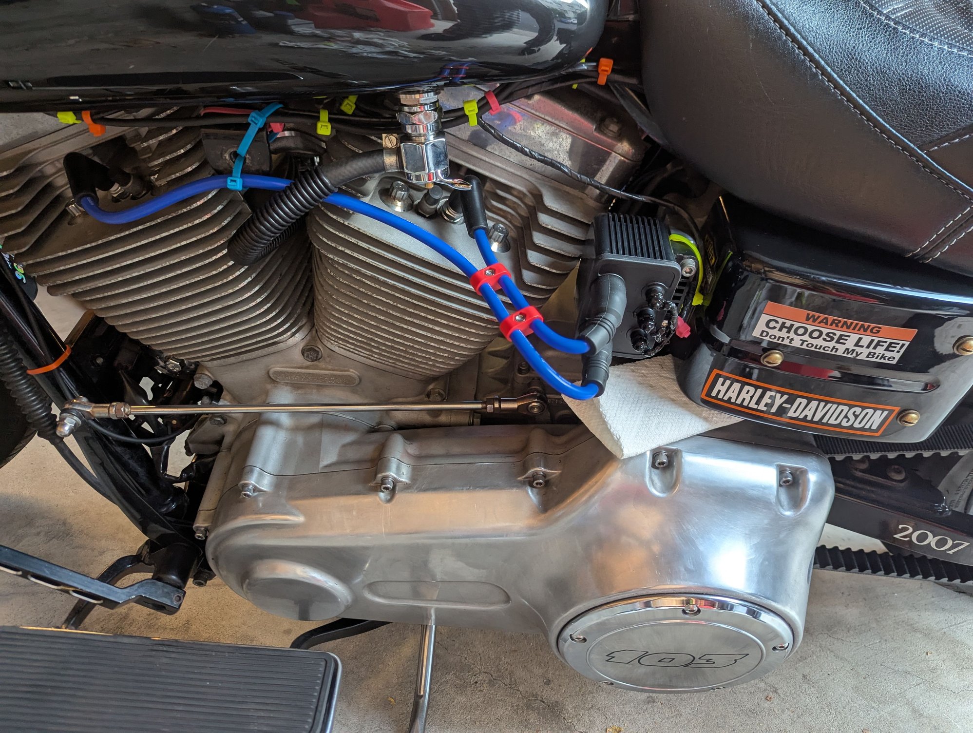

Looks great. I love the external breater. Don't forget the loctite on a 3 bolts for the air cleaner backing plate.

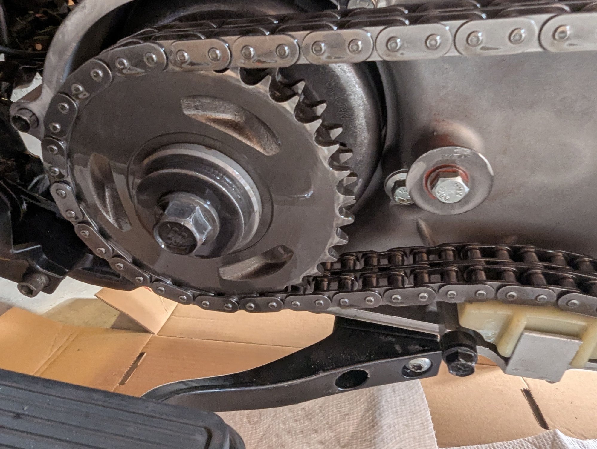

I also did a comp eliminator this morning as my comp started to knock on shutdown right before I did the carb. I didn't want to risk it and just replaced it with solid sprocket I had sitting around for a long time. I was gonna do it last year but never got around to it. The comp was completely fallen apart..

I finally got my S&S carb tuned and dialed in. I had to go up to .310 intermediate jet (from. 295), .070 main jet was left alone. Once I did that and went through the tuning steps, it rocks now with D timing! It's a brand new bike 😁

Thanks everyone for the assistance, I'm THRILLED at the performance and outcome! And because I made a new harness (with a new CPS), everything EFI is still available if I ever sell it! I doubt I will and will probably remove the ECU and wiring at some point, but it's available if needed. I use/kept the ECU and VSS for blinkers and self cancel but everything else is removed and tucked away!
