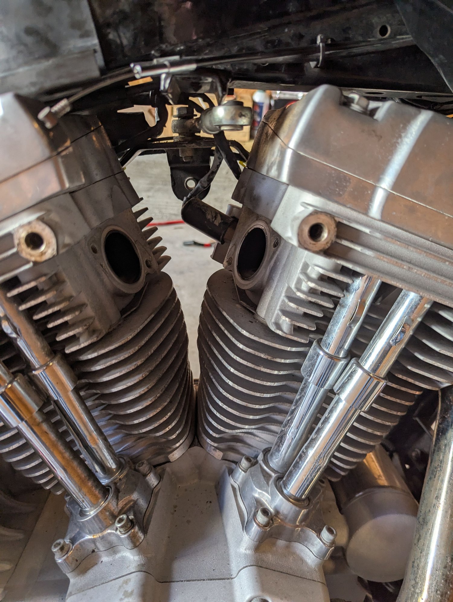

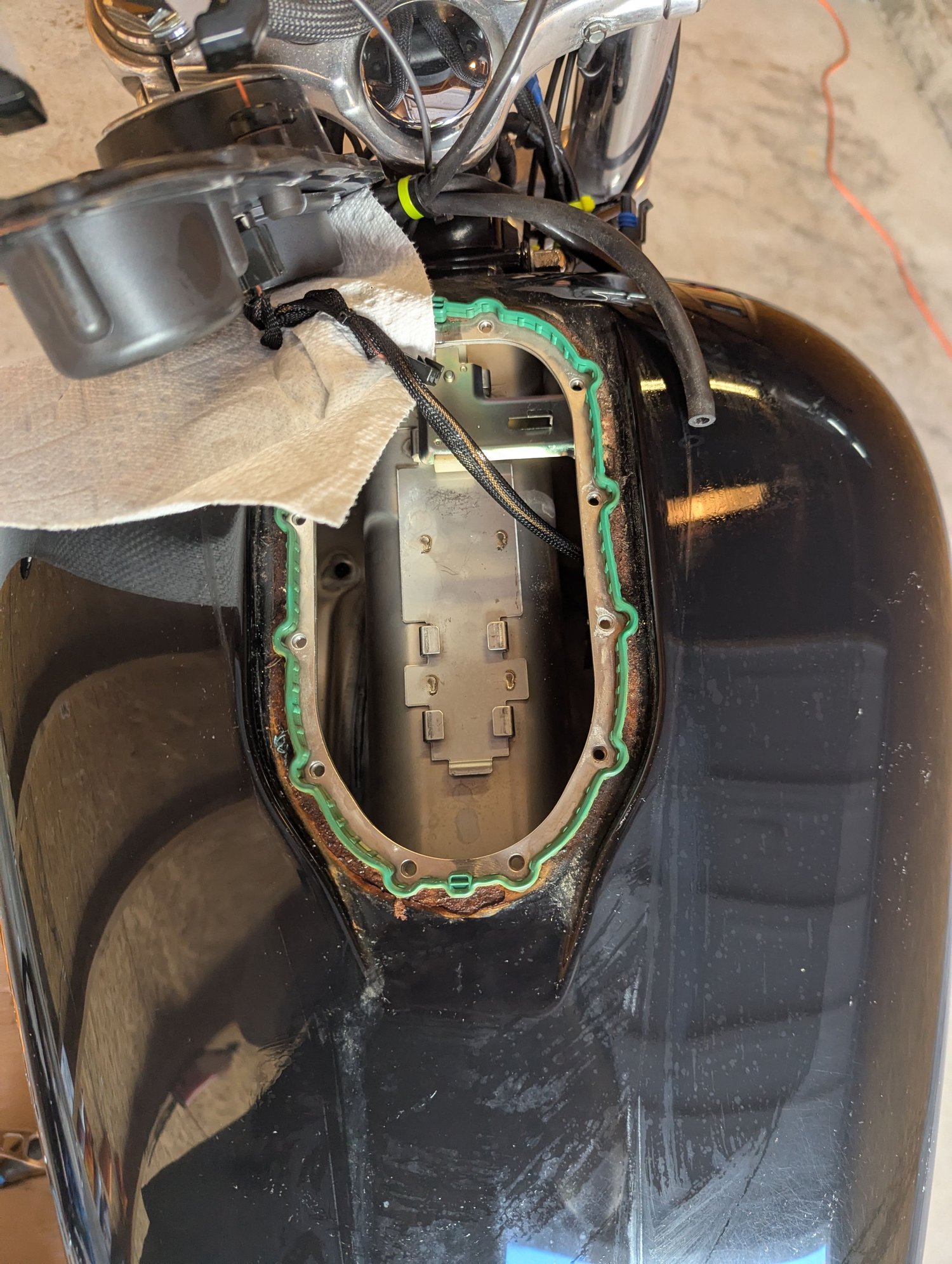

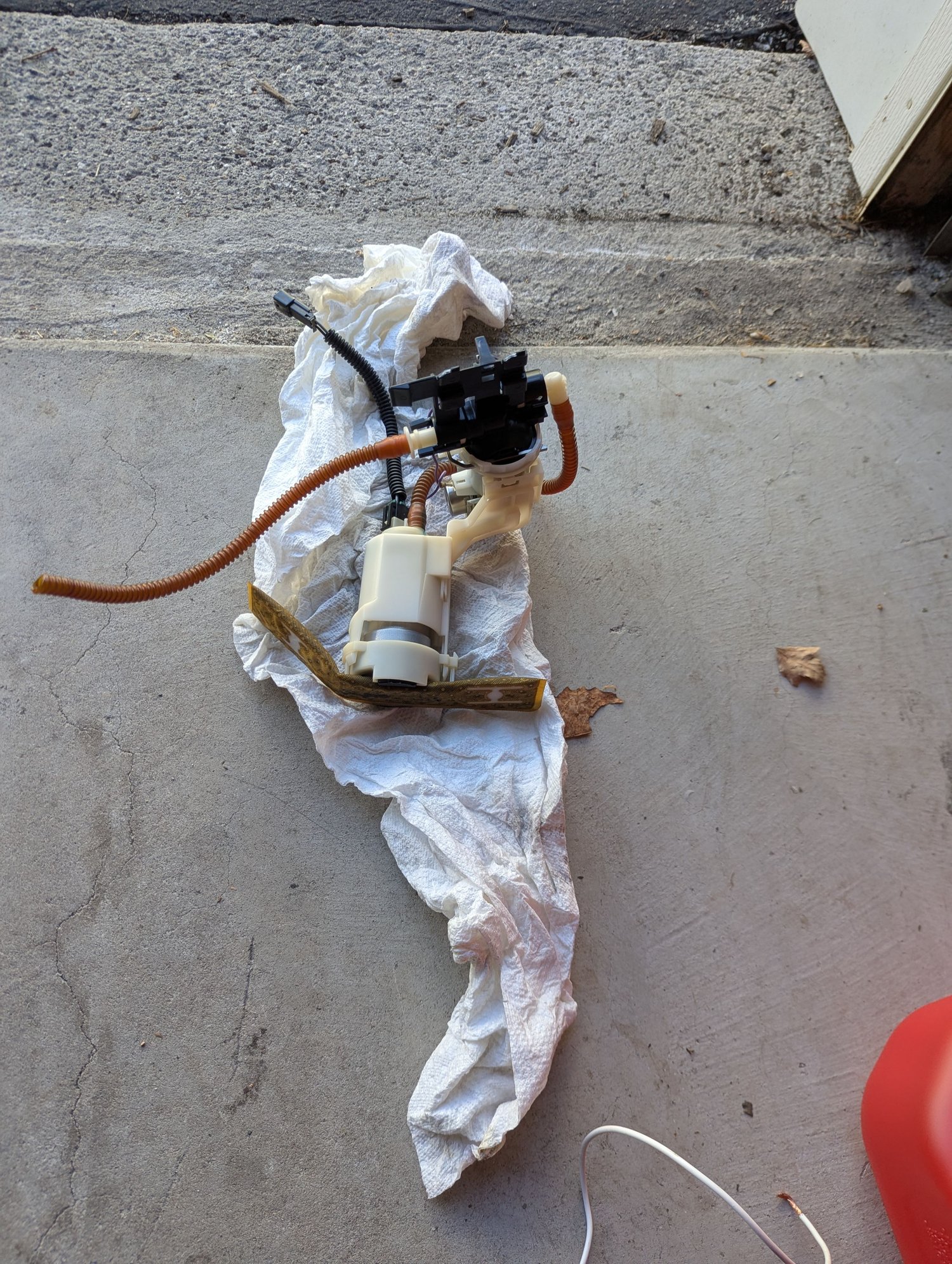

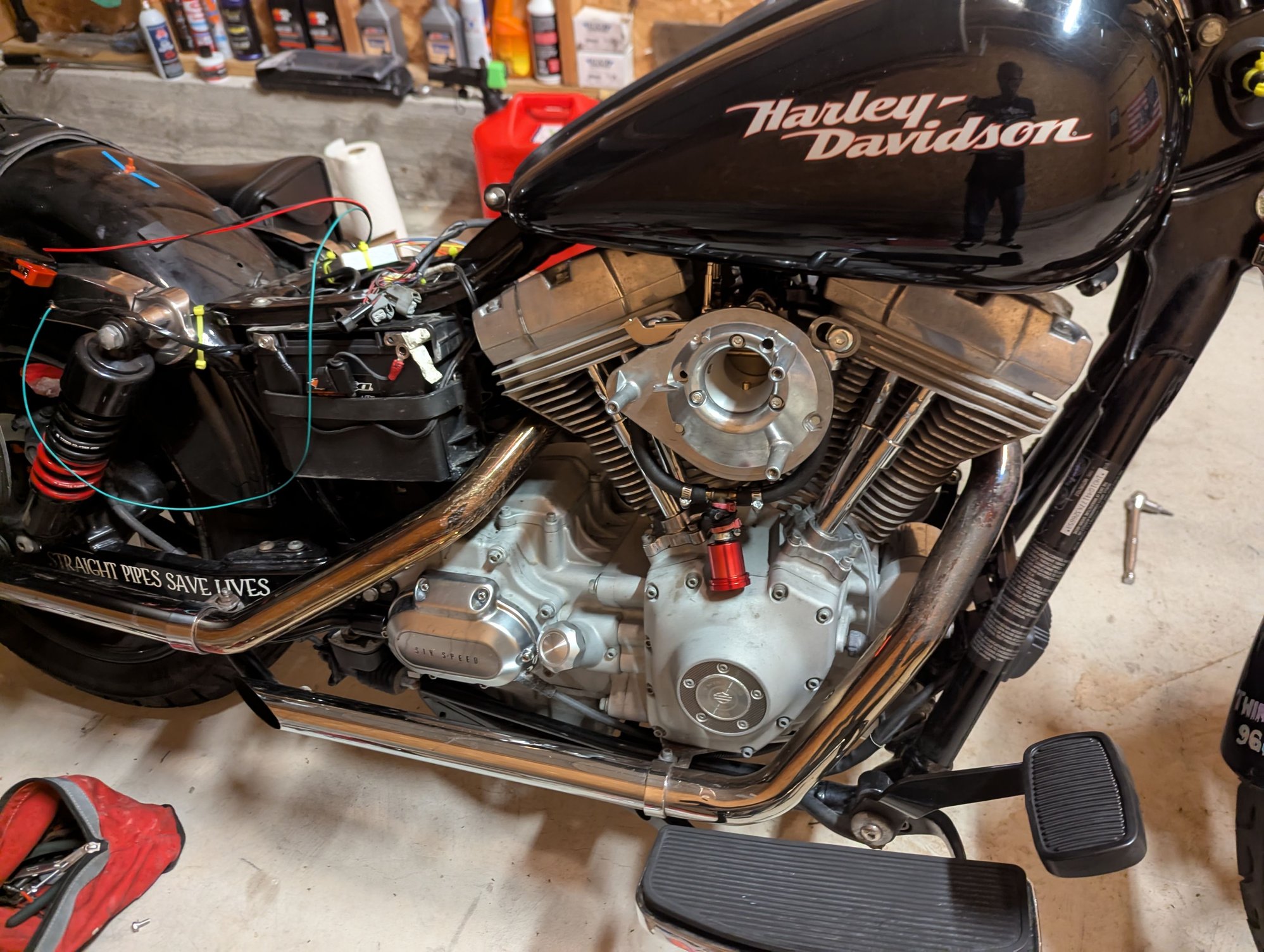

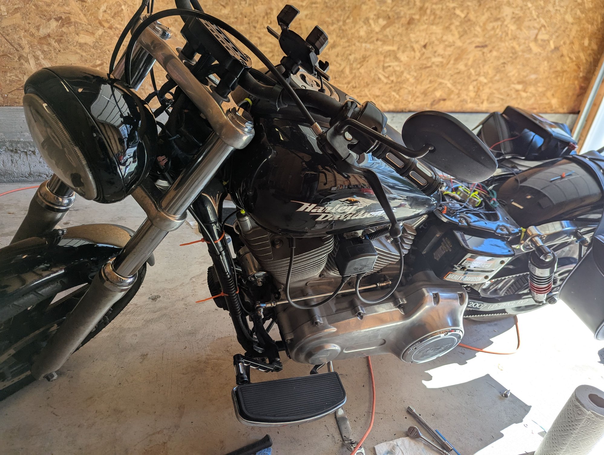

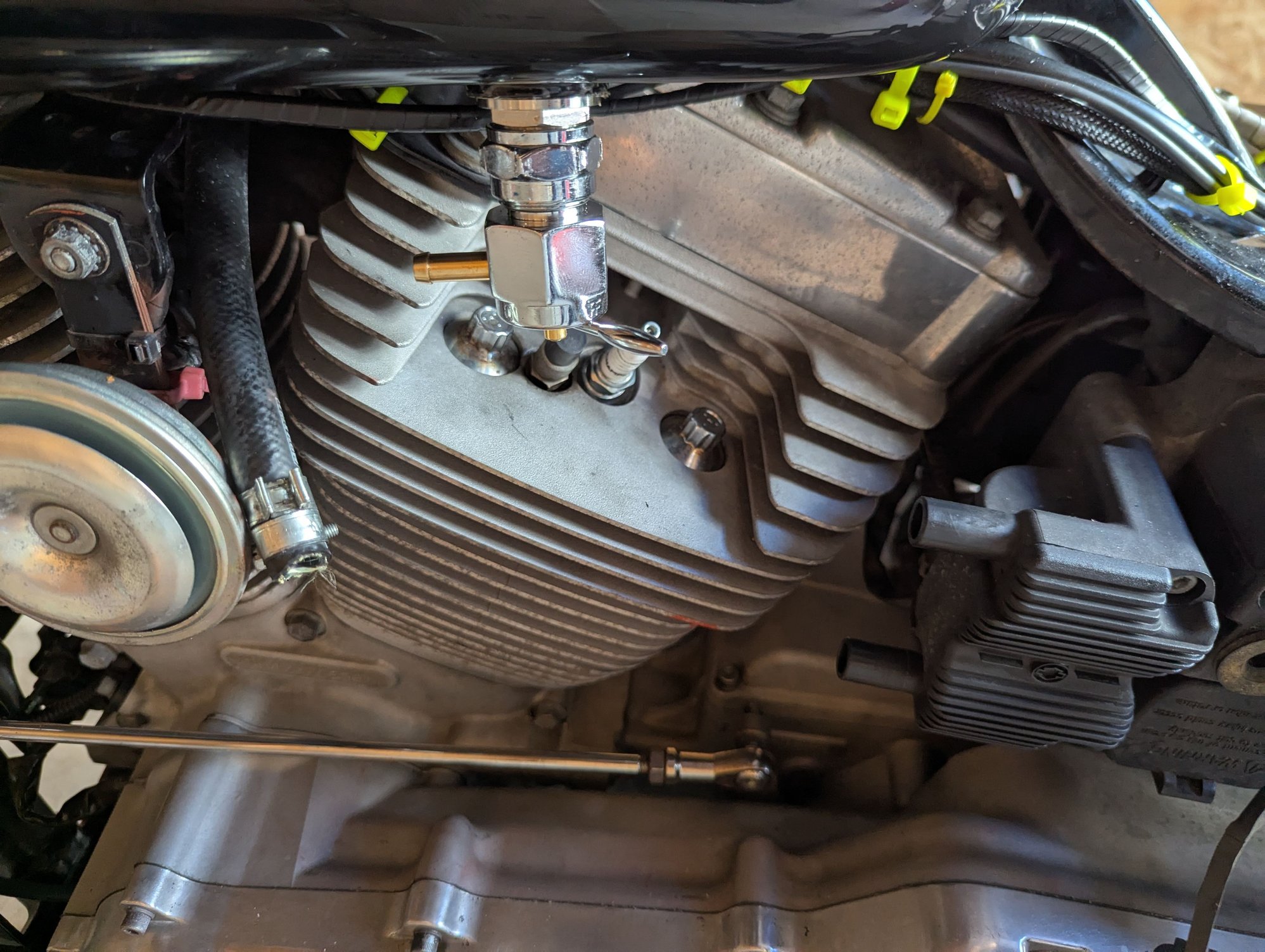

Holy crap, I should've done this 5 years ago! 96ci should ONLY come carbureted! Smooth idle, smooth acceleration, awesome idle, incredible ride, and the best part, no fuel injection, no computer, no sensors (except the crank which I replaced with the conversion, just in case), and simple naturally aspirated carburetor! It took longer than I planned but that was only because I had to make the wiring harness, fabricate a makeshift coil bracket and safely remove and tuck away any EFI parts under the tank and seat (to keep it stock revertible if needed). The only thing that was destroyed was the fuel pump and original petcock but that's cheap and would be best replaced anyway if it's ever converted back to EFI. Plus I didn't catch it the first round but I had a manifold leak in my right gasket, so I had to redo my manifold this morning to fix it. I don't plan to ever sell my dyna but who knows. I wanted to keep it available with options for now, but I'm probably gonna re-wire it this winter and fully remove everything (ECU, wiring, and all sensors) and box them up. I kept everything in the wiring harness intact and only removed the fuel rail, fuel pump, and injectors/throttle body (and all sensors except the VSS for turn signals) and of course crank to fire the thunderheart. I frickin love it! I was forced into doing it as an emergency conversion yesterday because my IAC crapped out and no amount of carb cleaning would solve it so I started after work yesterday and finished today (but I missed my weekend ride that I lead). Nothing I could do though, but I'm really glad I did the carb conversion!
Here's a few pics:
