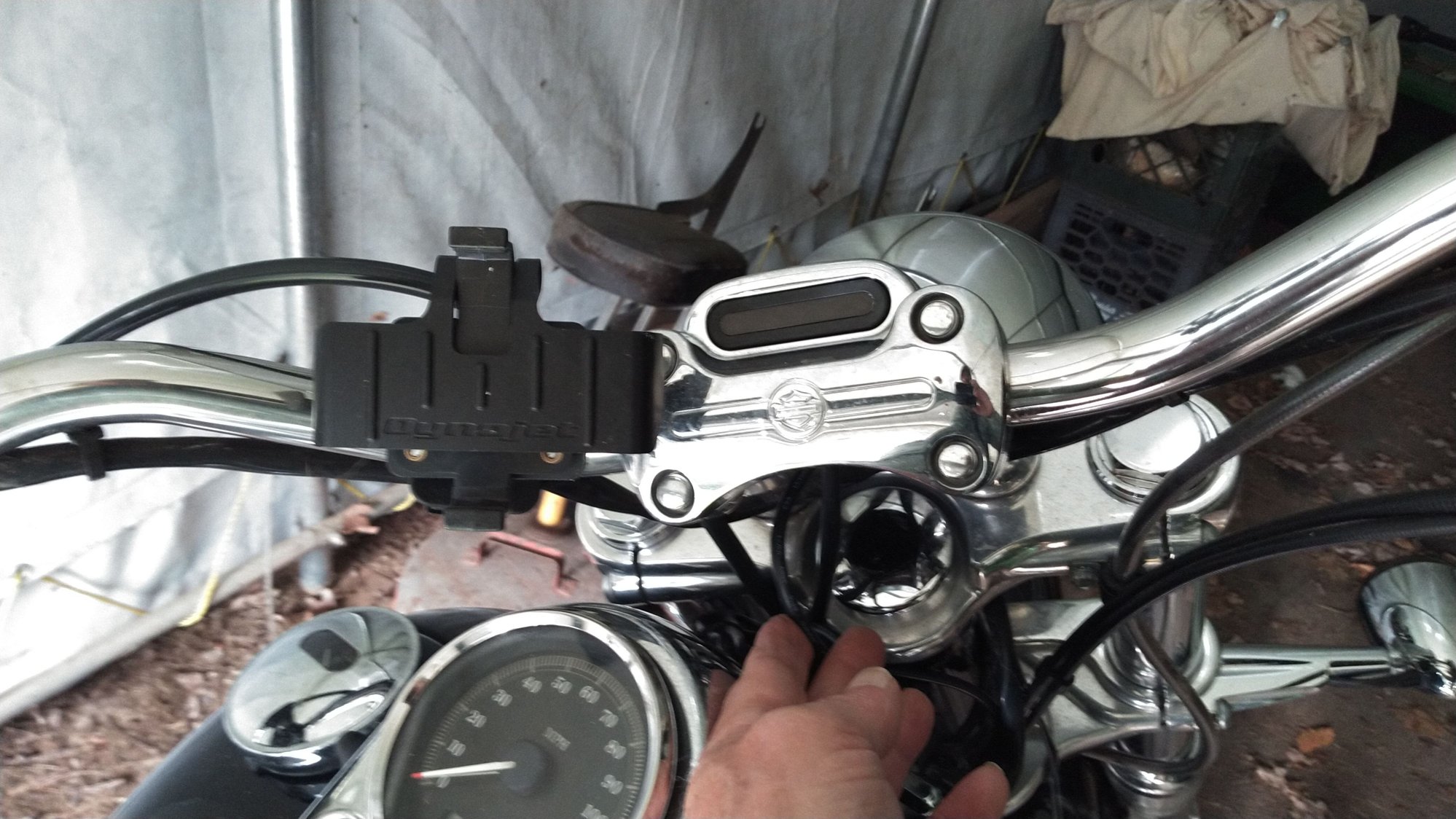

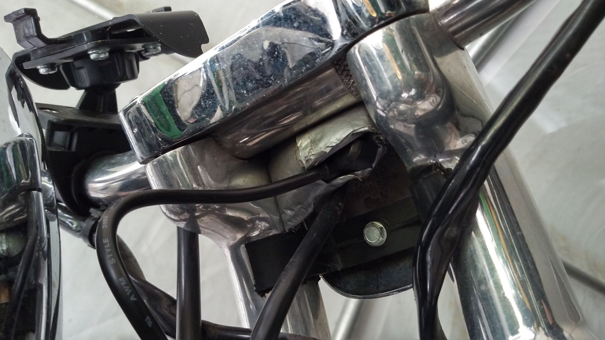

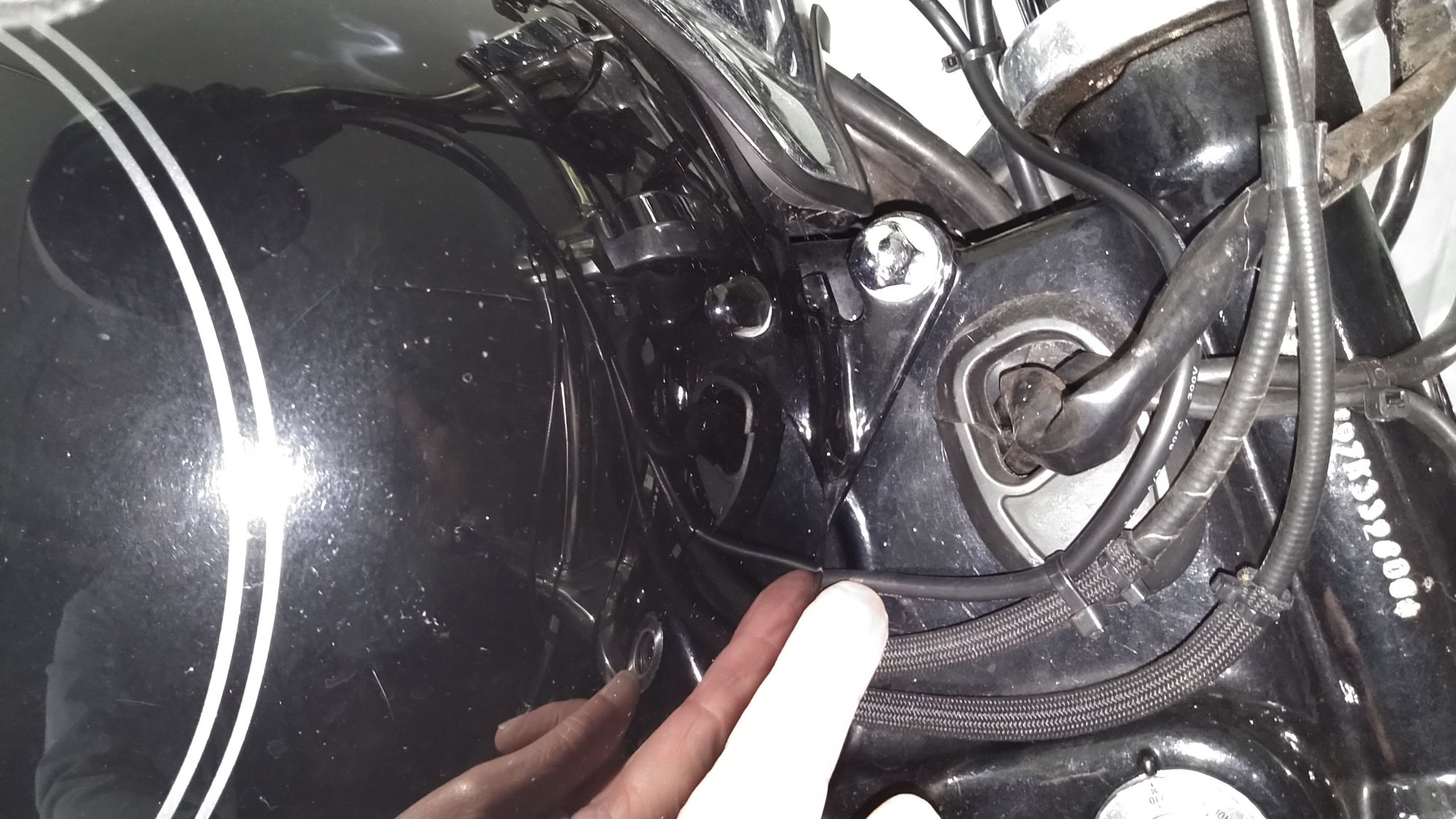

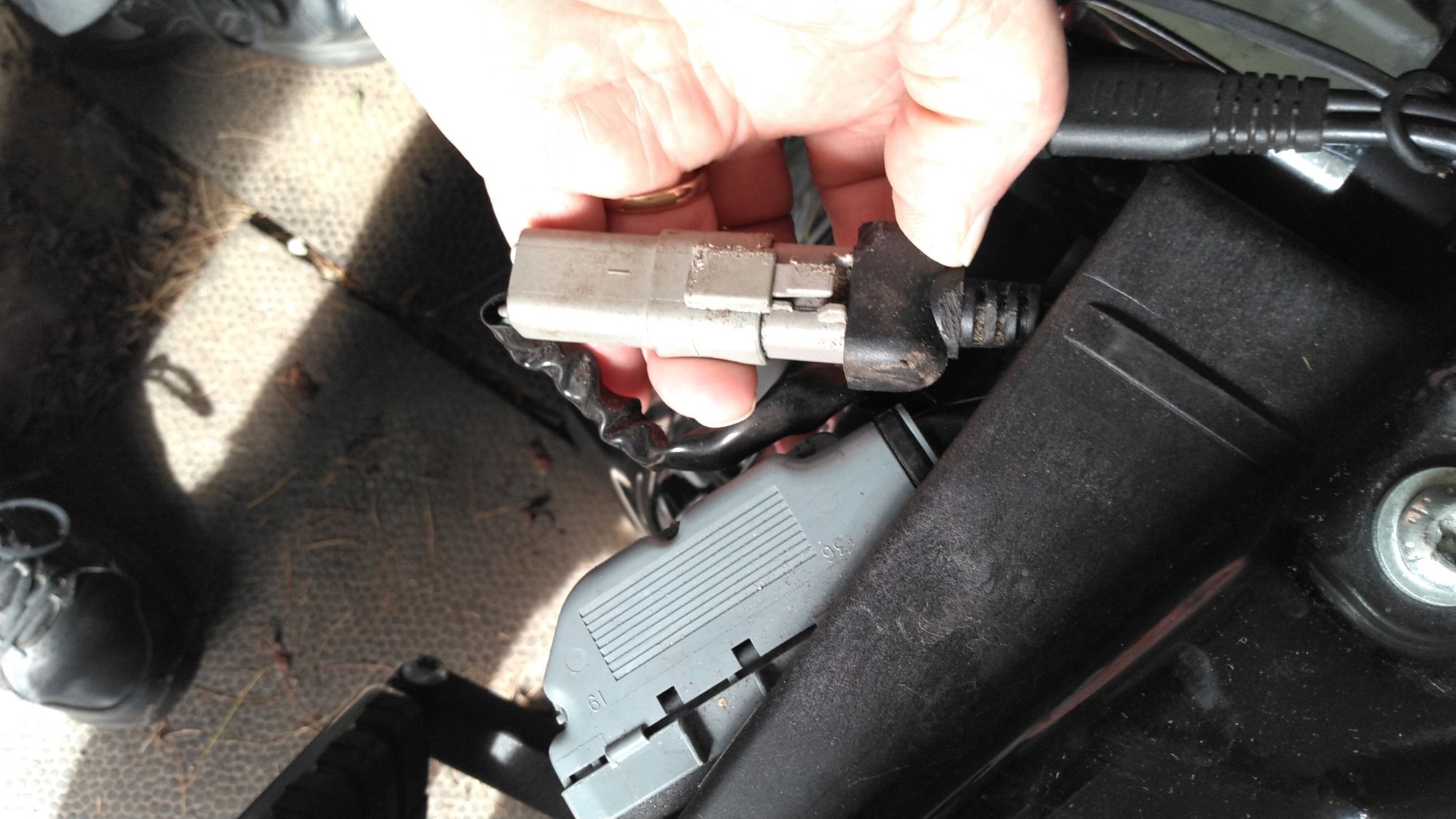

There's a hole in the caddy in the upper front corner (Pic 1). Under the tank, then I tied it to the throttle cable (Pic 2). I made a little packet from plastic foam and duct tape to cover the end (Pic 3) and so I can stick it up under the trim piece on the risers. (Pic 4, Pic 5)
This last photo shows why I need more mouse repellent for the winter. Fortunately there doesn't appear to be any other damage.
