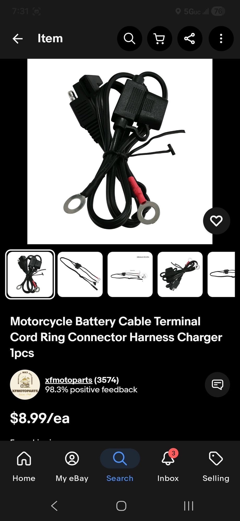

Tom, if you don't have Harleys matching maintenance charger for that line plug, that's a simple $8 fix on ebay.

Originally Posted by HDTom
The next pic is what's on my 2008 Anniversary FXDWG.
That's not the one i was thinking of. The one that came on my wife's trike looks like the first pic except it's wider and has a third connection, another socket. You can connect up a standard charger using the pin and first socket.
I agree, the easy solution is to change the connector. You can get one anywhere that sells powersport equipment.
John, where is that third connection going? A frame ground maybe for safety?
All this battery tender stuff is really getting off base. Please refer to post 17 here for a complete explanation of the thrid terminal on Harley's tender.
https://www.hdforums.com/forum/touri...e-wires-2.html
As far as I know, it goes to the battery plus as well, but it allows the battery to be connected to either a fast charger or a "normal" tender. I don't have a fast charger, so I can't be certain.
Post 17 is confusing. I can't tell if he's talking about the charger or the battery.
