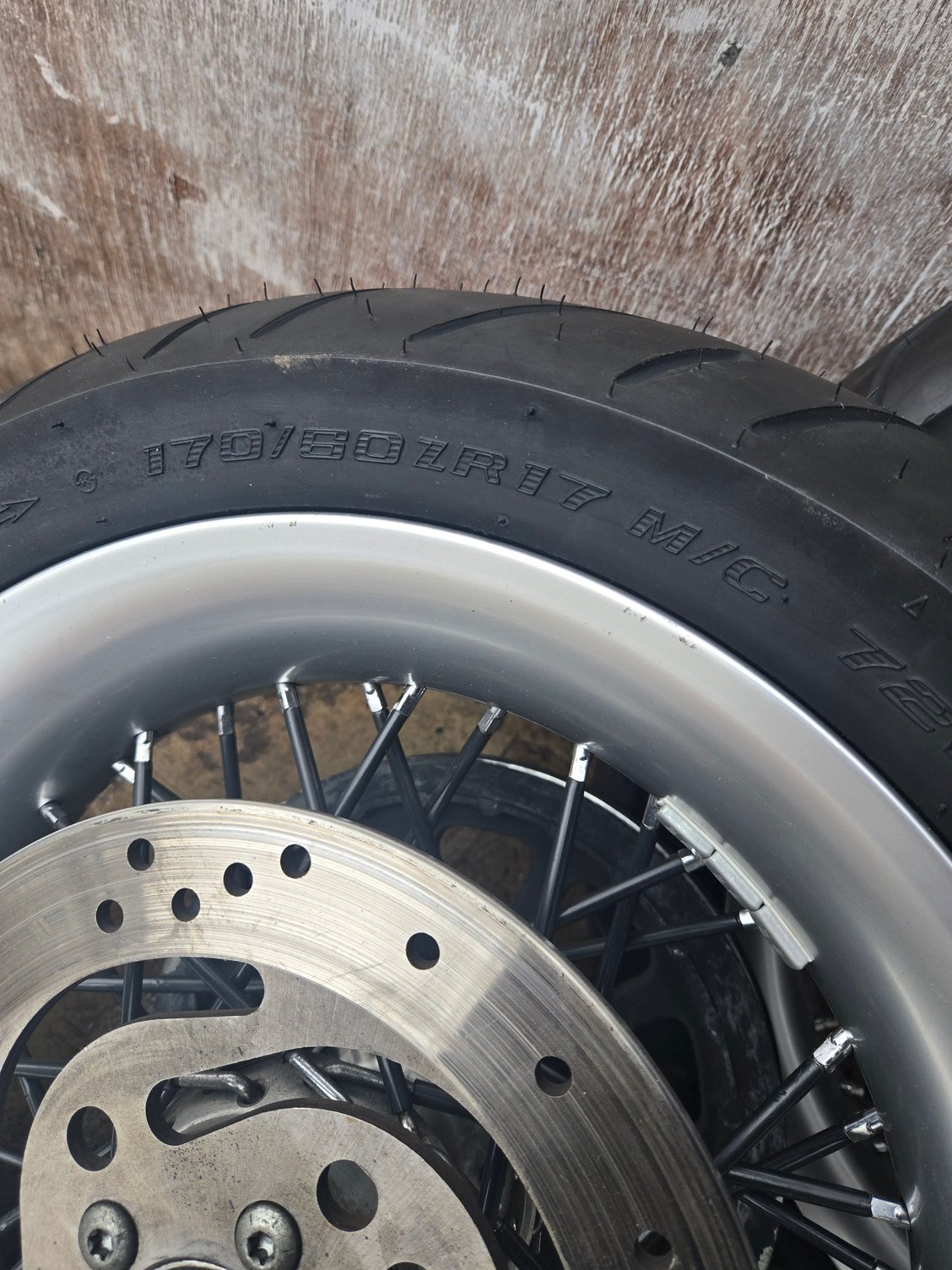

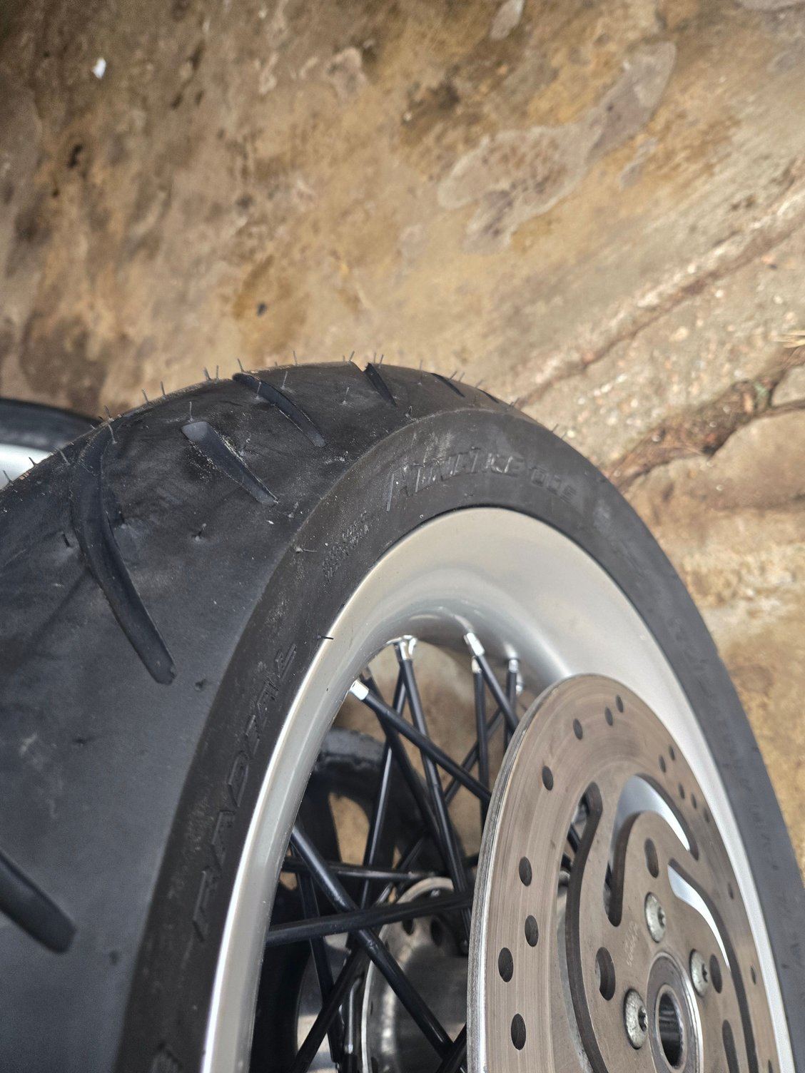

Looks like it will work. It's the sides that stick out some that had me worried.

Shinko Radial 170/80/ZR17 Advance 005 Looks like it will fit ok. I looked for less expensive tires this year.

I've used that tire.. It fits and hooks up well.. I really like it..
