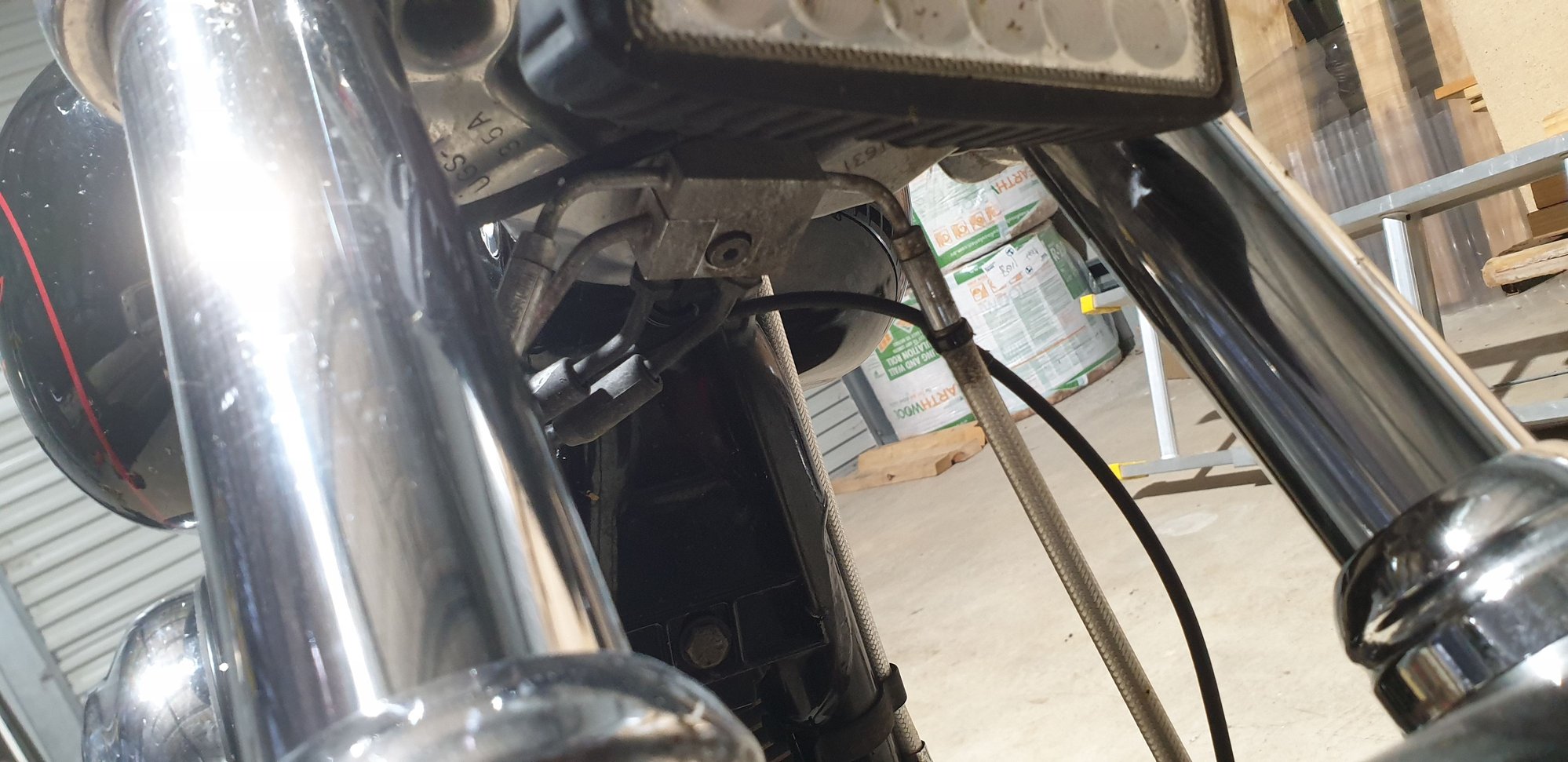

Can anyone confirm if this is the ABS junction box? Pretty sure it is. If so, then I can't bleed the brakes myself for the cylinder rebuild.
Old Apr 28, 2026 | 06:42 PM
hattitude's Avatar
hattitude
Posts: 14,156
Likes: 11,244
From: San Diego, CA
That is the junction box between the master cylinder, front caliper lines, and ABS lines.
Why can't you bleed the brakes after your master cylinder rebuild...?
While using the Dealer's Digital Tech 2, or one of the other aftermarket tools for activating the ABS module is always nice to do, as long as you don't "activate" the ABS module until after you get your front master cylinder, brake lines, & calipers bled, no air will get into the ABS module requiring it to be purged.
You can also bench bleed the master cylinder, before attaching it to the main front brake line, to reduce the amount of air you will need to bleed out through the front calipers.

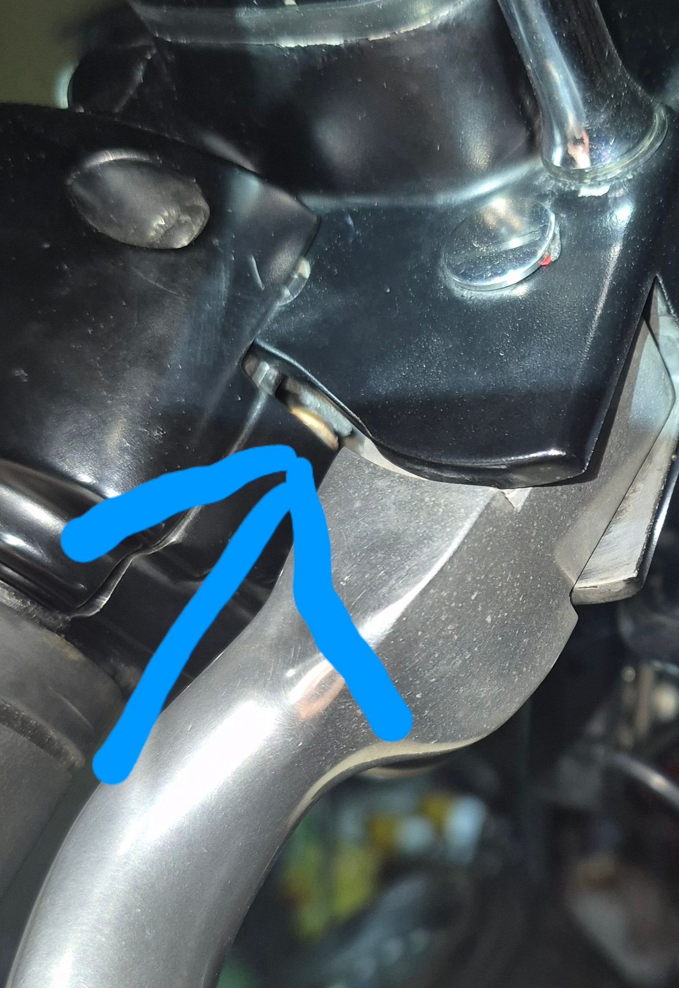

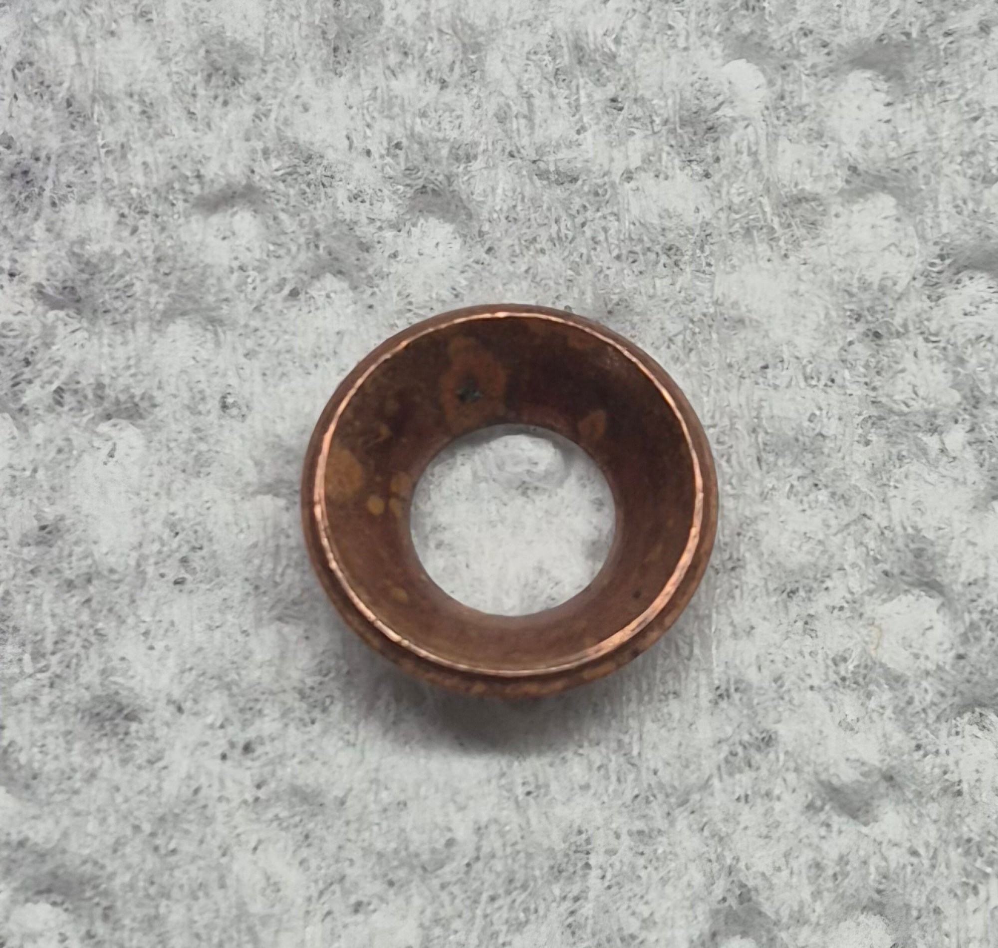

If you push out on your brake lever does the brake like go out??
I had the exact symptoms and the only fix I could do to remedy it was to super glue a 1/4" copper flare onto the switch and it solved all my problems.. If you zoom in on the pic with the lever in it you can see the flare a little better.. The second Pic is the actual flare that I used..
