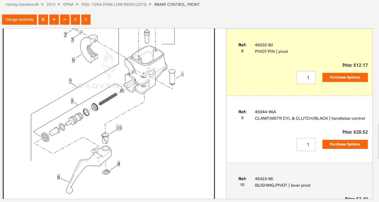

Went ahead and ordered a new front o2 sensor, that should resolve that issue.
As for the brake switch, the front brake lever has some play in it and it keeps falling back onto the switch, triggering the brake light. So my brake light is on without the lever being depressed, not entirely safe.
Are the levers sprung open? Perhaps the spring fell out or has lost its strength?
Is there a quick fix for this? Any advice welcome.
Thanks for the input so far.
The front brake lever is held in place by a Pivot Pin (#8 below) and a pivot bushing (#10 below). If the bushing has been worn, it will affect the fitment between the lever and the switch. Perhaps a new pivot bushing #45423-96 will fix your issues.
If there is damage to the lever, pivot pin, or pivot pin perch themselves, you'll need to replace the damaged parts...
FYI.. It's been awhile since I have had to mess with the actual front brake light switch. As I remember, there is no adjustment with/to the brake switch itself. So it's either installed correctly or not... If I am remembering that wrong, I welcome the correction.
