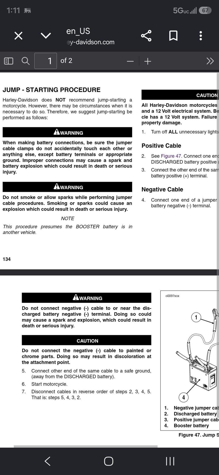

Old May 27, 2026 | 12:14 PM
Jackie Paper's Avatar
Jackie Paper
Posts: 38,586
Likes: 6,435
From: Honah Lee
2022 Harley Ultra owners manual.
