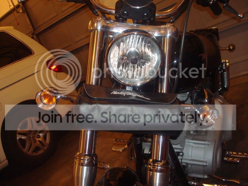

I mounted mine on the frame in front of the motor mount to prevent such damage.&nbsp\\; Here is a pic if suggestions are welcomed.

Here are some pics of what I did.
&nbsp\\;\\\\\\;
You could also search Fork bag damage for the thread of the guy I got the idea from.
&nbsp\\;\\\\\\;
&nbsp\\;\\\\\\;
&nbsp\\;\\\\\\;
He used a door hinge for his. I took a T brace and bent the one end down in a vise. I cut a small hole in the back to slide it through then bolted it to the bag with 2 bolts. Then had to drill out a hole so the headlight bolt would fit through the brace. Its nice and sturdy but was flexible enough for me to slightly bend it some to keep the edges from rubbing.
