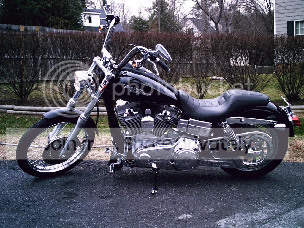

I installed Kuryakyn forwards on my 07 LR earlier this year and the old shift shaft that sticks out the the primary cover is driving me nuts. I dont like it and never have liked it. I know it can be removed, so what do you do with the hole on the cover. I know that the softail bike ddo not have mid controls so will one of those primary cover fit my LR?

Put a plug in the whole like on my bike.

The 07 Softail or Wide Glide primary will fit. You will need to put a plug of some sort in the hole of the shifter shaft tunnel on the inner to keep the fluid in the cases. A plug such a Pig shows above is the easiest and cheapest way to go.
Here's a couple pics. One shows the plug on a chrome outer primary. The other shows where to cut the shifter shaft to remove it without pulling the primary covers.
