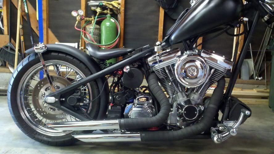

i used the titanium wrap. no need to soak or wear gloves.
