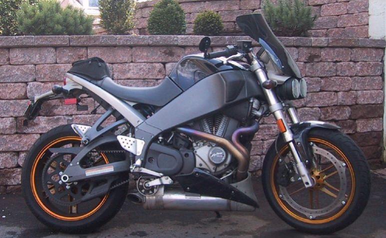

I have had high speed wobble on my old Sportster. It use to snake down the
highway. I have not had any problem with by 2005 FXDX, and I push the bike hard into the corners. I have had front and back tire skipping around corners. I never open the bike wide open, because the bike mitt wobble at high speed runs. I am going to install True-Track stabilization kit. or steering dampener. For my own piece of mind. I had high wind problem on my Buell. Install a taller fairing which solved the problem.
