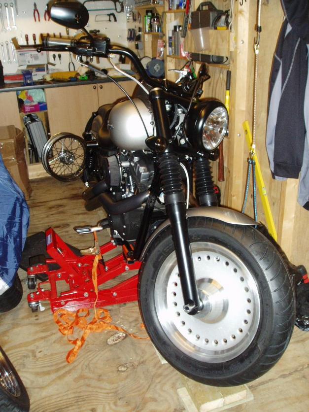

its easier to have your hub re-spoked to a wider rim. going that way myself.
for now here's a 17" fatboy wheel fitted wirh a 150 tyre.

Mark that looks bada$$

Mark: More details on that man!! Did that bolt right up?! I L-O-V-E the look of fat tires up front. How does it ride? What bike is that on?

looks like a nightster, but that is fat

they ride like TANKS with anything over a 160 on front... does look cool as hell though!

it's a 150 up front on my streetbob. not a simple bolt on. had to space rotor and have new spacers made. snow outside so no better pics yet. as for the ride, not been on it yet. will post update when weather lets me out.
