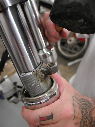

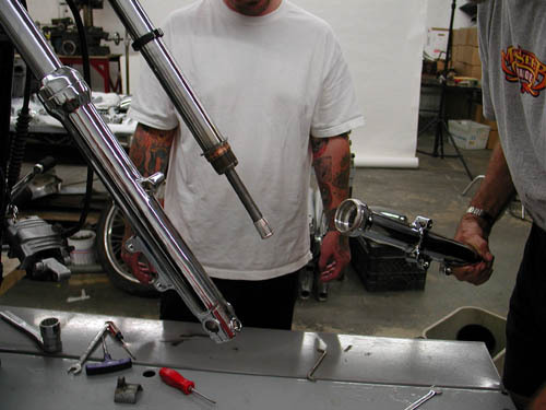

As you can see, I have in place the chrome dust cover, new dust seal, then new oil seal, then the spacer and bushings. The fork lower then slides over the bottom bushing, and then the oil seal, bushing and spacer all need to be tapped back into place somehow. I found this website where they made a tool:
http://www.bikernet.com/sportsters/P...asp?PageID=690
Unfortunately I don't have the means to weld anything. Looking for some other ideas. I was thinking about using a wide flathead screwdriver with some tape over the end to prevent damaging the seal. What do you think?

Can you elaborate a bit? I was thinking about using a piece, cutting it in half so that it wraps around half of the seal, but then I need a way to tap it without whacking the fork tube.... If there was a piece sticking off of the pipe somehow, something that I could get the mallet on, that would sure help, much like the nut in the picture above.
Although, if it was thick enough PVC I bet I could just tap the edge with the mallet.
Is that what you had in mind?

To be honest, that contraption that the guys are using in the pics above looks completely hack!
