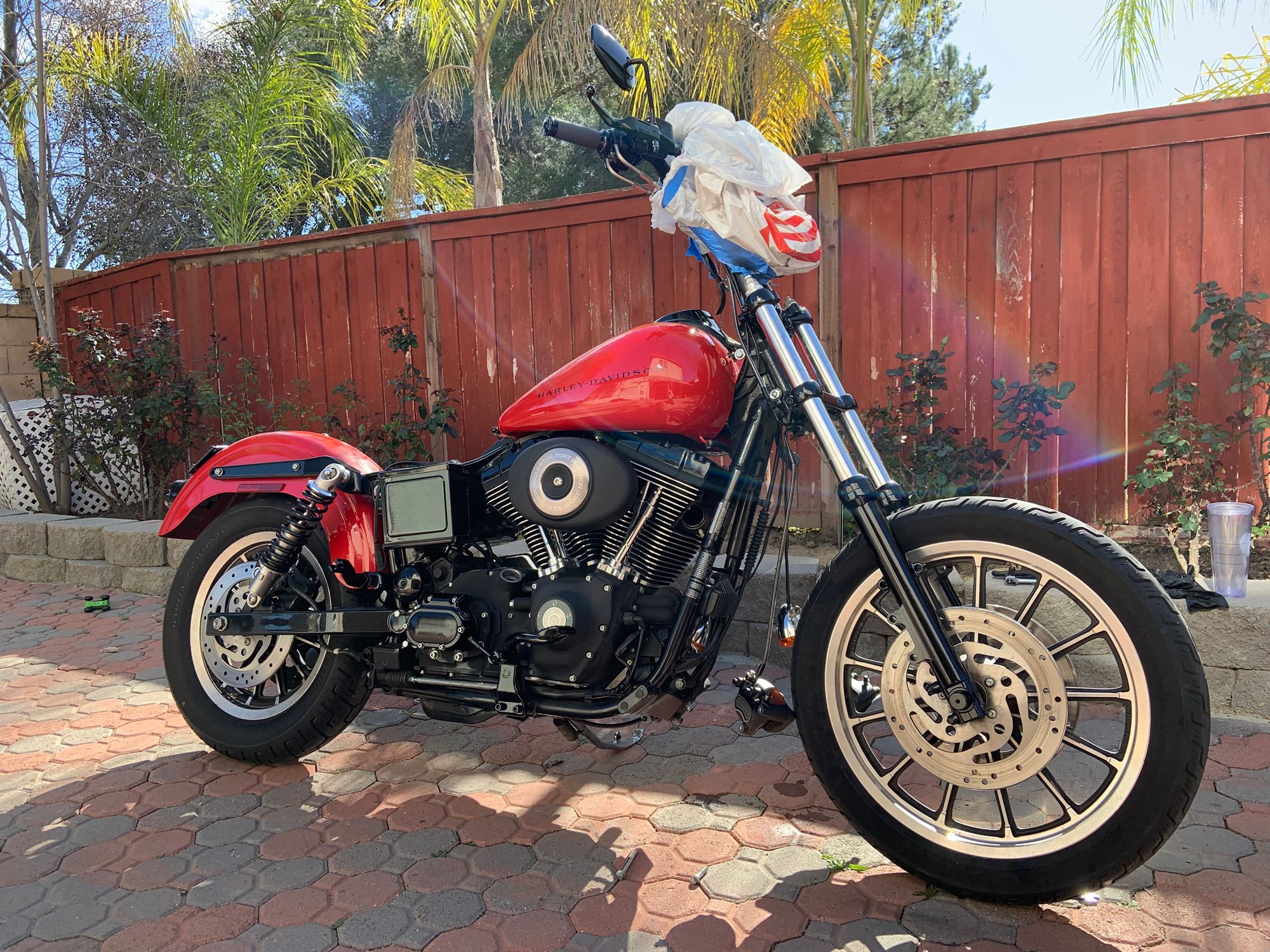

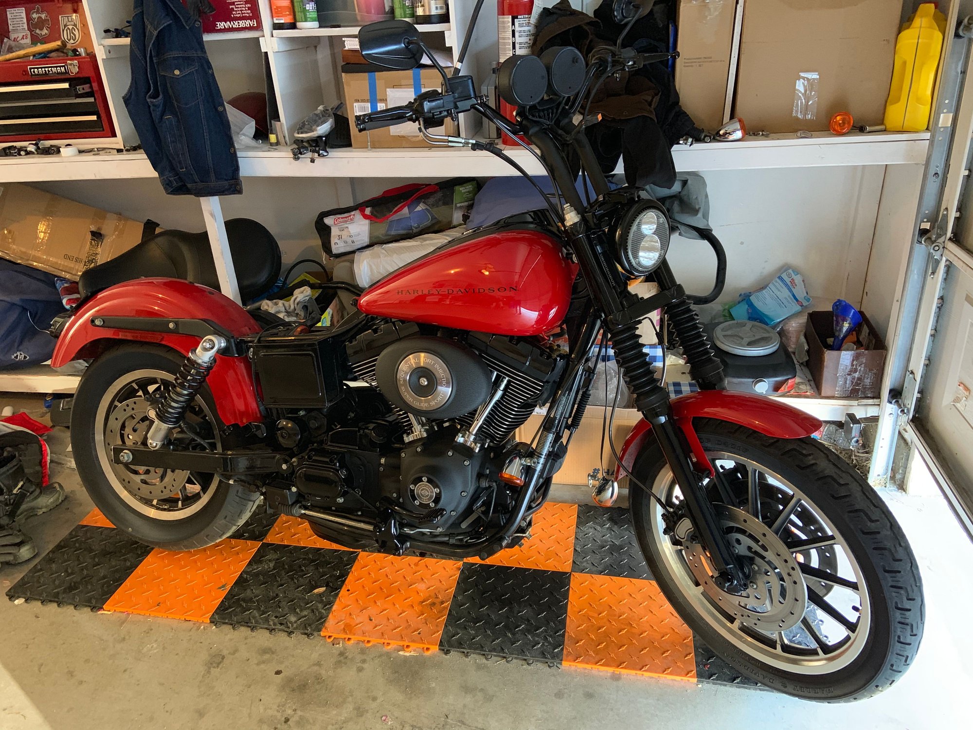

Here's my before and after.
Epoxy on forks & front fender. Light (very light) sand front fender 2 days later, matte clear enamel rattle can on all other fenders. Changed forwards to mids.
Before
After
Alternate view (before mids)

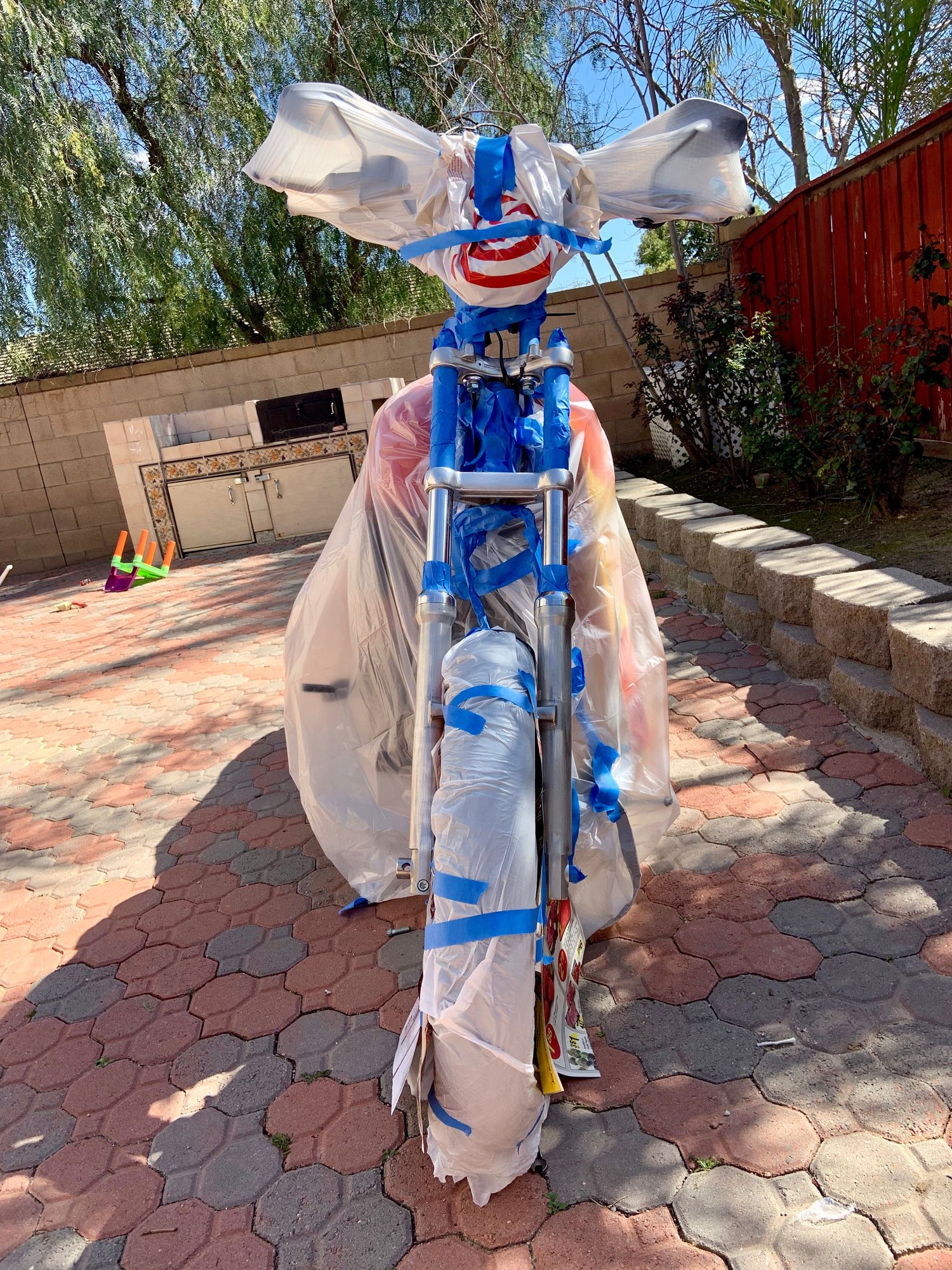

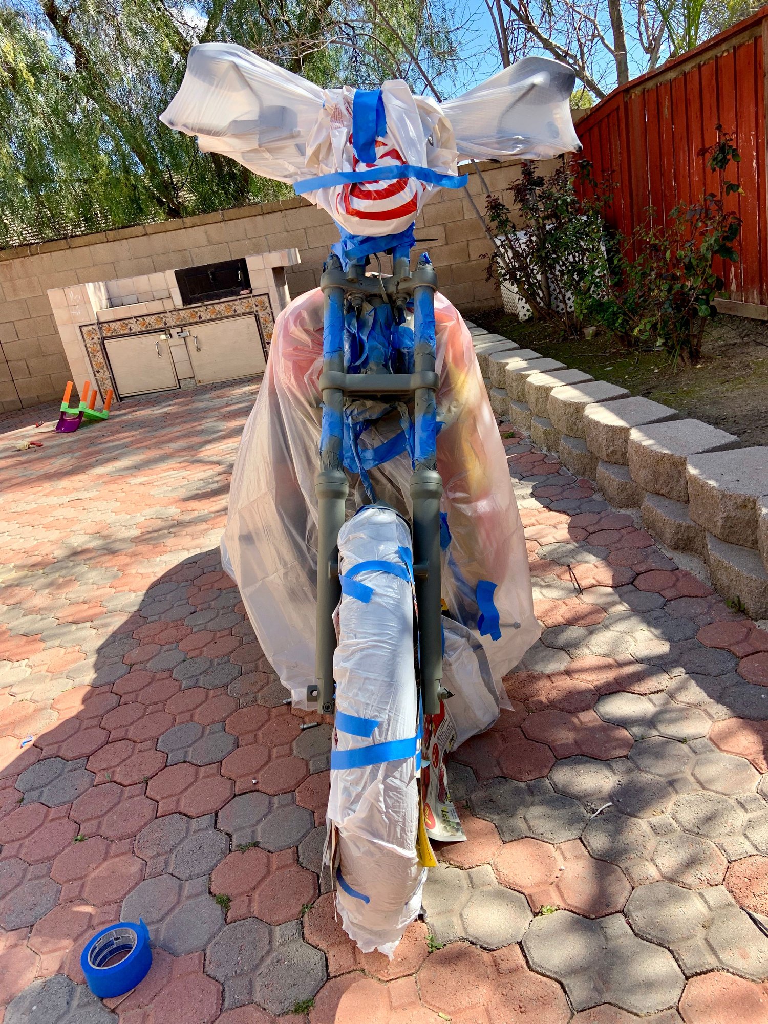

@fxdx1985 are you able to post some more pictures of the trees?
How well were you able to get coverage? Did you spray the bolts/hardware as well?
Looks good!
