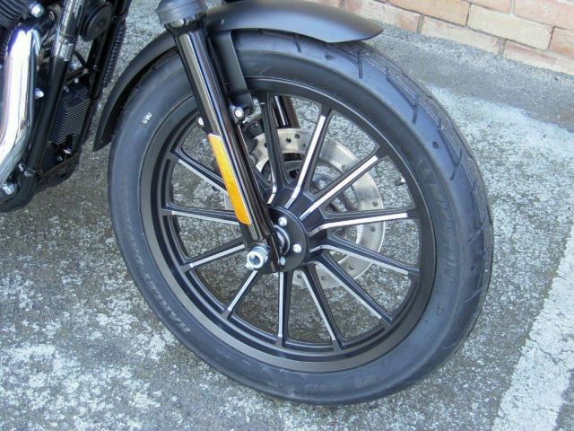

Epoxy paint front wheel

Originally Posted by jpbutler1983
THIS IS SO AMAZING! I will be doing this VERY soon...
I also want to do my wheels to look like what I've attached below... will this appliance paint do well to do the cast wheels?
Thanks!
i did mine about 4000 miles ago and they still look like the day i did them don't mask the wheels off just use a rag with brake clean on it and wipe over spray off as you go its faster and looks better
