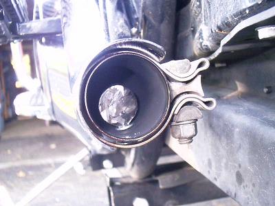

If you are looking for more backpressure and/or a way to take some crack out of a set of loud mufflers, a set of homemade lollipop baffles in front of your muffler will work. I run them in front of my mufflers.....I needed a little more restriction, when I went to True Duals...Anyway, they are nothing more than 1" washers with the hole welded shut welded on a 1/4" bolt stem. You can turn them to kinda tune them.
