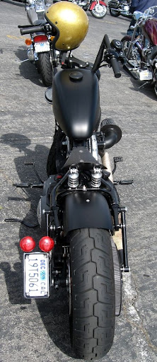

I haven't seen any Dyna's with a speedometer mounted some place other than the tank or handlebars/risers, but here's a couple of Sportsters with the speedometer mounted below the tank.
