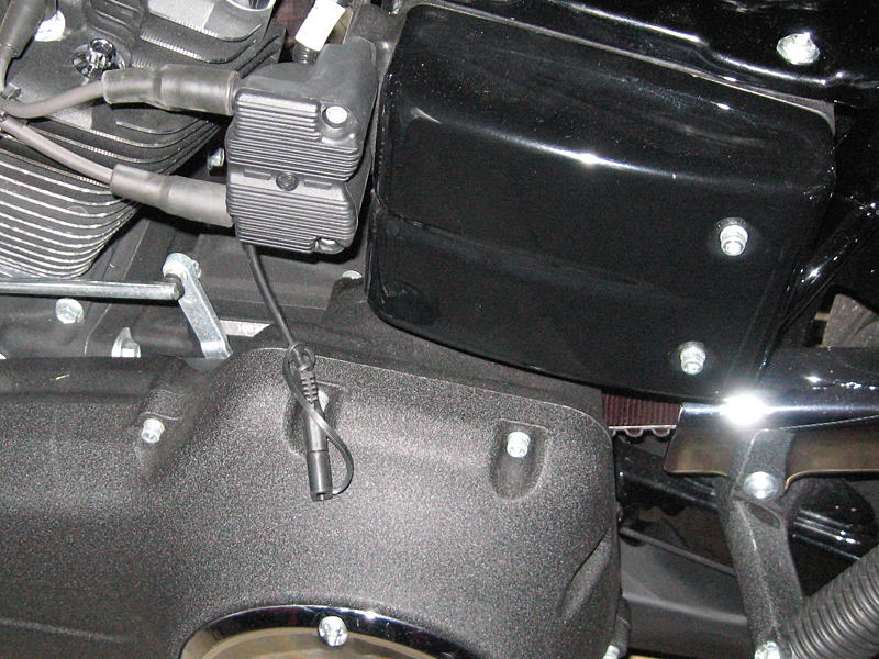

Originally Posted by Baeseman1
Rich - do you have this installed? It's not on the above photo, but I imagine it looks perfect. I'll be ordering one of these and most likely the same kit you have. Already have the leads, this will just finish that off nicely.
Thanks for the link.
Here you go:

Originally Posted by 8541hog
Here you go:
How could I not do this?!?
Thanks - the more I thought about it, the more I like it.
And you'll know where I stole the idea from...
Lucky for you I have not patented my ideas...lol It does take a little finesse to get all 4 bolts in and lined up in the metal, so be careful with the drill. Also, the powerlet comes with a backing plate, make sure you use it between the powerlet and the metal on the bike. There is a round shoulder on it that does not fit in the oblong hole, didn't want to drill out the hole to make it round. Would be one more place that could rust.

Mine goes around the side of the battery box, under the coil, and then I shove it out of sight in between the fuse box and the top of the primary. You can't even tell it is there.

No pictures right now, but mine is mounted with the battery tender plug sticking out about 1" out the side of the battery box pointing towards the rear wheel. Not noticeable when capped, easy to access when I park her.
