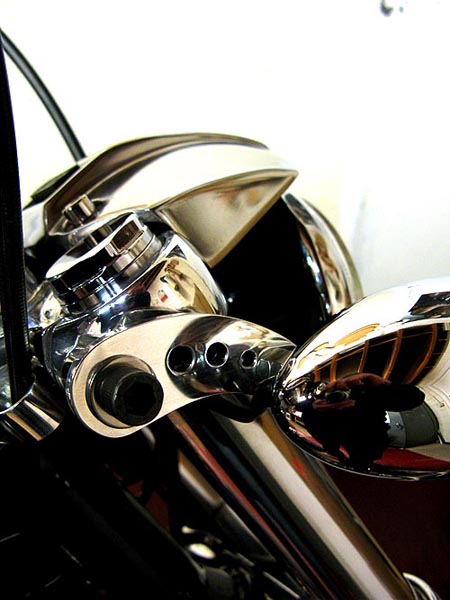

Changed the oil last night. gonna go for a good ride after work today. I'll check on the moisture problem after that. One more question. I did a quick search, but there are so many that I could be reading all day and not doing the mod. But I need to move my turn signals to the forks. Is there a quick low cost solution to this? I would like to put them on the forks. Someone have a link?

There's these
Derv
