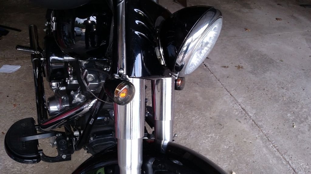

You could get adapters to mount them down on the forks for fairly cheap. They would then sit down low and bolt to the forks similar to the Glide in your signature.

These would mount your turn signals down on the forks at the triple tree, or near it. That would take them off the handlebars completely.

I bought the HD kit for my FXDL. Good clamps and instructions how to tie into the harness and register them to the can-bus.

it's kinda a hack job but I just got some small "L" brackets at Lowes's rounded the square corners an painted them black....picked up some of the small bolts that hold side strips to the headlight housing cover an mounted the turn signals with it. with the black turn signal housing you don't really see it anyway.
