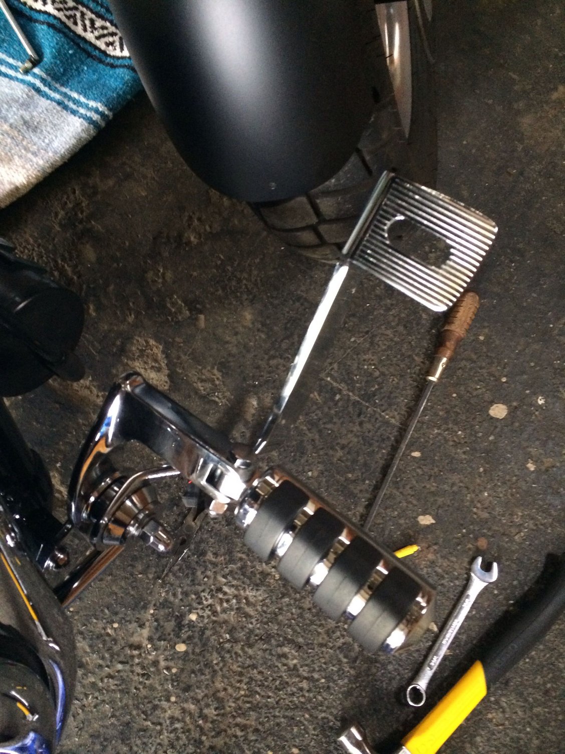

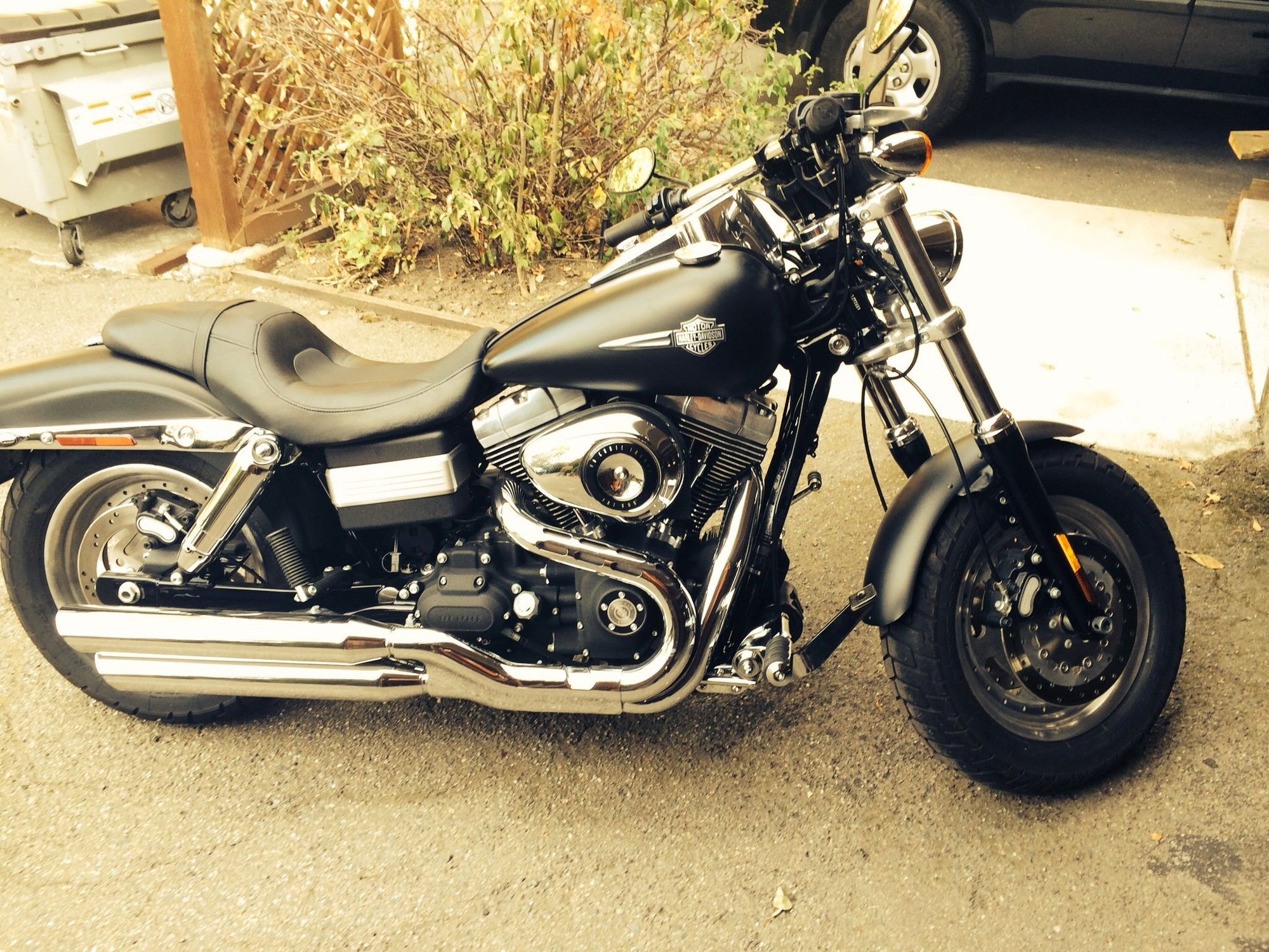

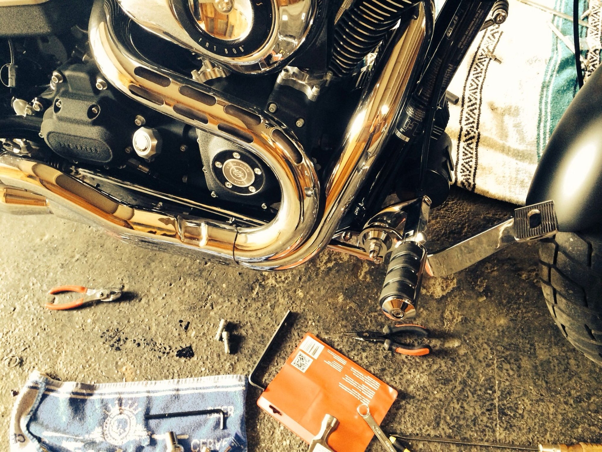

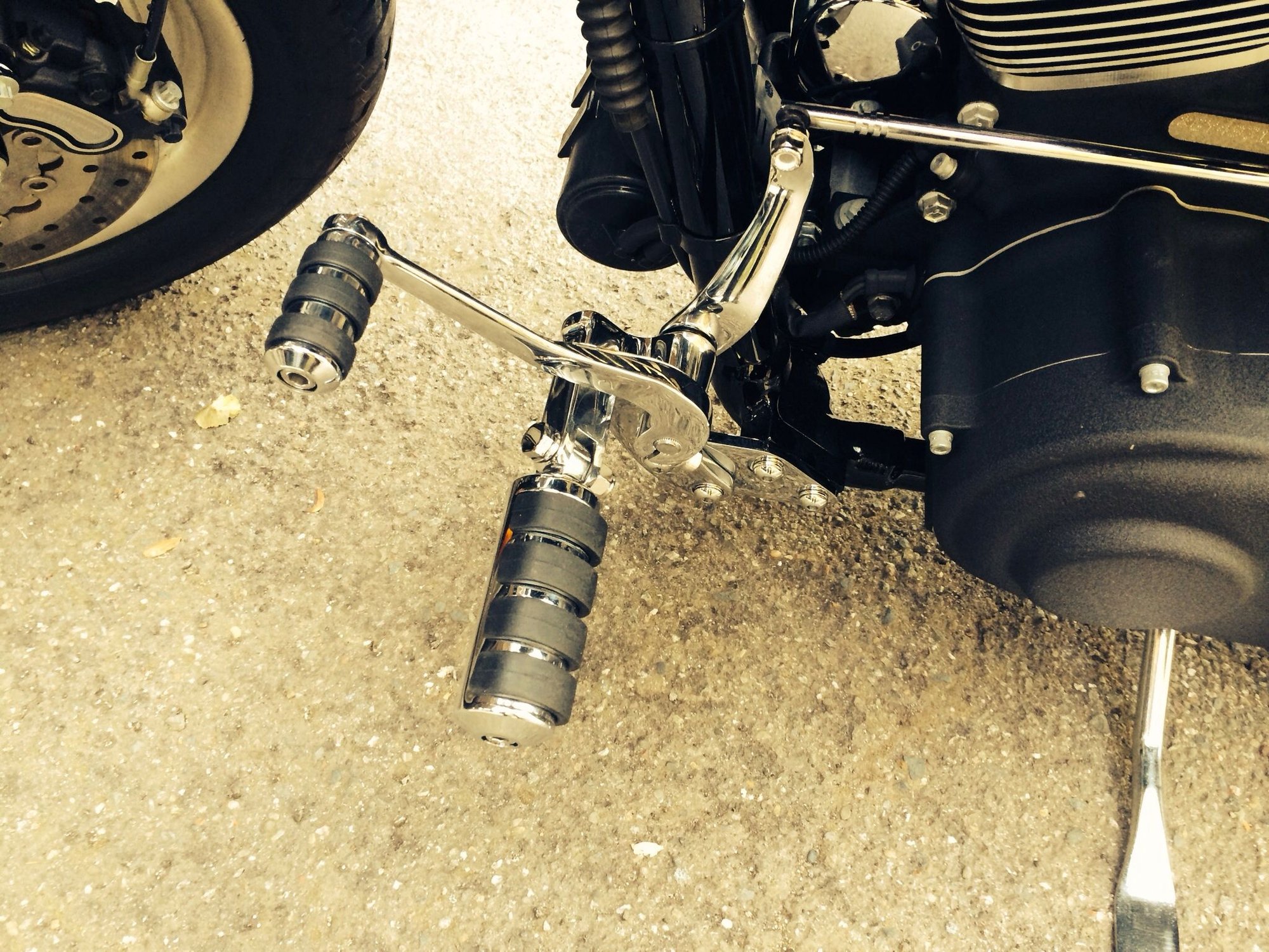

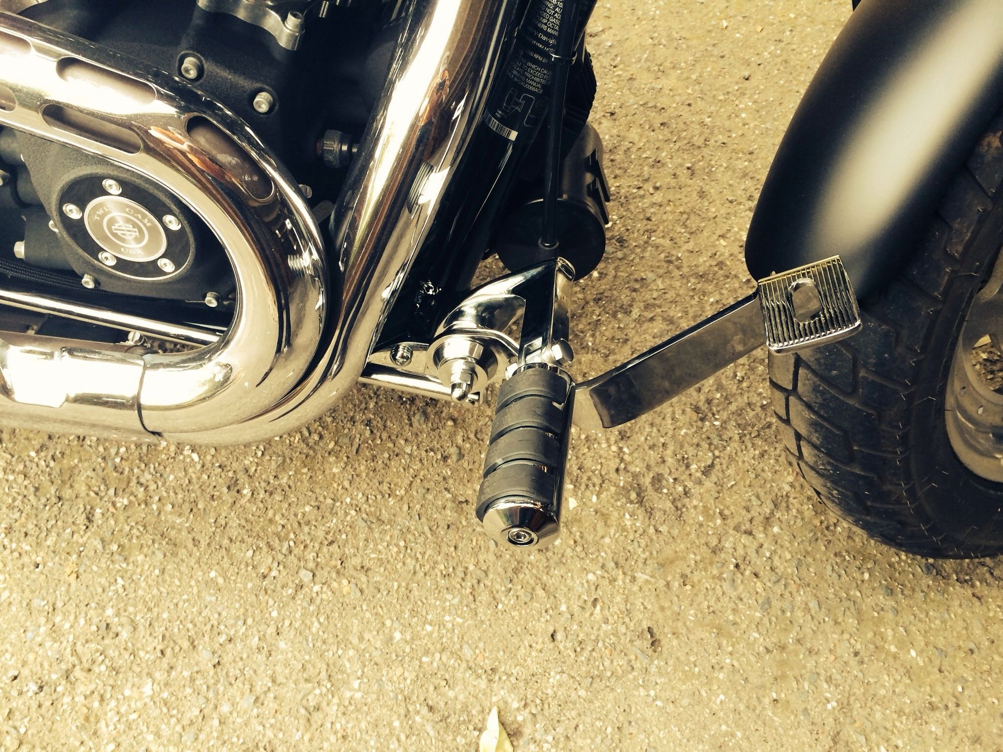

Just put Raider 2" extended forward controls onto my 09 FXDF. The instructions were crap, but the kit is pretty solid. All the parts you need, with the exception of a mid-shifter shaft cover and a pad for the brake pedal. The bare metal is a little bit too far down, making me point my toes more than I would
Like when braking. Overall though, went together well, and they work great! Best part? *I DIDNT HAVE TO REMOVE ANY PART OF THE PRIMARY!*
You can see the detent in the exhaust cover where the miss were.
Nice pegs, but the needs a pad.
And at 6'4" I'm totally comfortable
