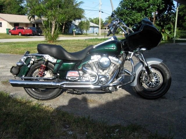

If you want to put a steering stem in back of the forks with 4" of trail, also done that for many years, not new. Better steering the forks must be in front of the neck as the wheel always self centers and always pushes back when the steering stem is in front of the fork as what is on a 1984~current FLT. The FLT's have a goose neck just like choppers of old.
This a current Bagger:
This is a new style FLT with a steering stem in front of the fork tubes
This is a new style FLT with a steering stem behind the fork tubes
This is a pre-new style (steering stem in front of the fork tubes) found like almost forever:
