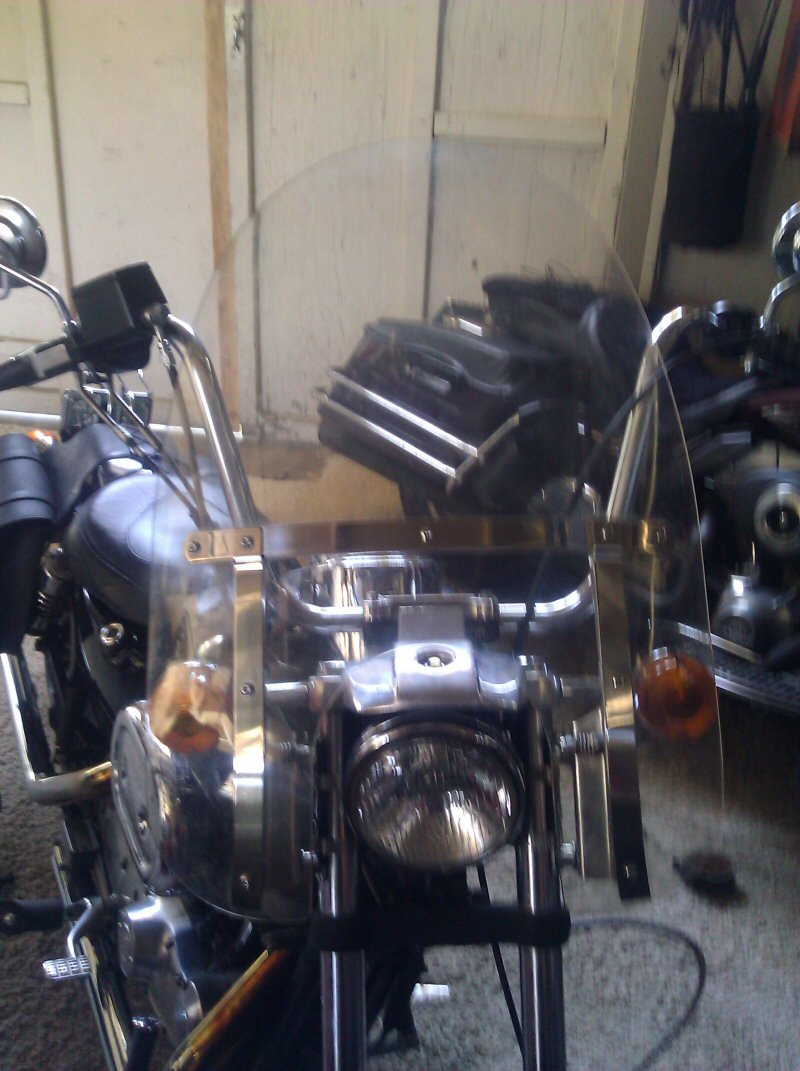

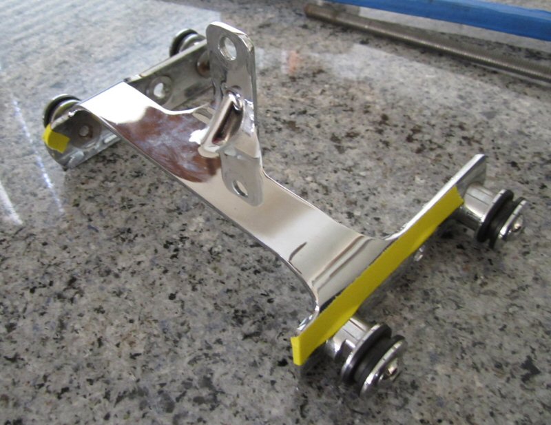

Searched and didn't find an answer. Can a detachable windshield designed for the hardware that stays on the bike be converted to the quick-release style? I got this windshield and hardware as part of a package and want to use the windshield, but not leave the mounts on the bike. I will rarely use the windshield which is why I don't want the hardware on the bike for the 99% of the time that I won't be using the windshield. 2003 Dyna Low-Rider.

Ordered 4 39mm quick detach clamps (1 locking) from Surdyke for under $100. Cut the bracket off a the red line. Used existing upper hole for retaining bolt, enlarged to 5/16". Drilled a new lower hole to 5/16". bolted the clamps to the holes with some stainless bolts from the local hardware store. Clamps right onto the forks and fits great.

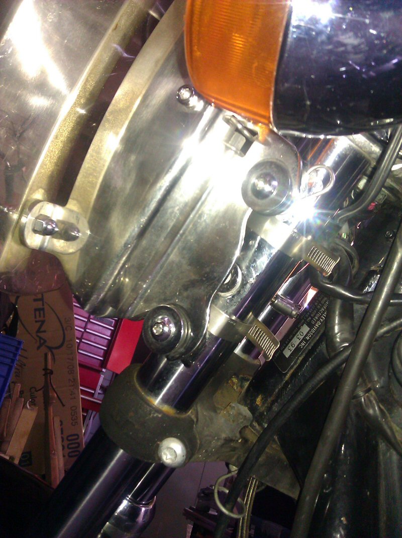

jumping in on this one. my old lady just bought a 93 xl
we scored a springer quick release windshield at the swap meet for 30 bux!.
I am cutting the springer bracket in to two halves with two docking points per side two hose clamps per side AND VOILA should work. going to do it today will take pics of the surgery and results.

springer windshield and mount 30$
hose clamps from ace hardware 8$
not hearing my old lady bitch pricele$$

Hose clamps will help to keep the detachable hardware from staying on the bike when the windshield is removed, but I'd hardly call them quick release. My quick release windshield comes off in under 5 seconds.
On the other hand, I wouldn't care to have the left behind detachable hardware on my bike when going shieldless, either, but I would trim those hose clamps to be a bit shorter, or at least keep a screw gun handy for putting them on and taking them off.
