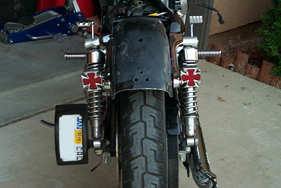

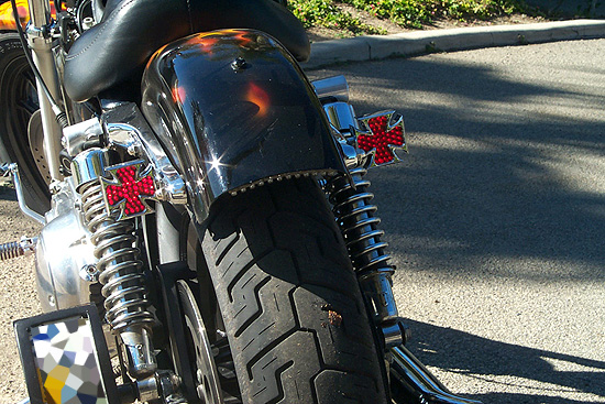

I'm not sure if this information will help you or not but I thought I'd share just in case.
With the solid mount Evo Sportsters (1995-2003) we were stuck with 130 rear tires too. Same issue. The fender was wide enough for a 150 but the belt would hit the tire.
So someone came up with a spacer (3/8") that bolts between the rear pulley and rear wheel. We bolt that in to our tire, spread the swing arm slightly using a scissor jack, and the 150 tire fits no problem. We just put in a couple 2mm spacers between the stock pulley side axle spacer and the swing arm to give a little more clearance between the pulley and the swingarm.

Before:
After:
