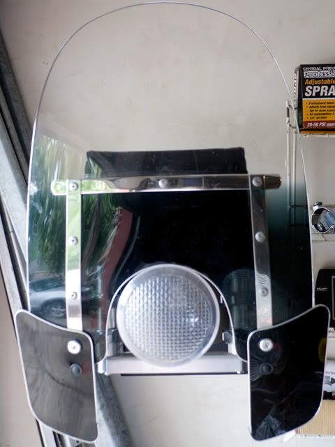

The other day I saw a fix for wind buffeting coming under the windshield and over the tank on a HD Compact QD windshield.
With stock shield the buffeting coming over the tank was really bad. It would always blow the cigarettes and lighter right out of my shirt pocket when I got over 50 mph. After this modification I ran the bike up to 80 mph and returned home with my cigarettes and lighter still in my pocket.
Could not find the original link, but thought I would show you what I did to stop the buffeting coming over the tank.
This was a very cheap fix. $9.95 for a 1” x 1/8” aluminum strap stock, 8 #10 screws and 8 lock nuts. And a spare piece of 1/8” Lexan I had laying around.
I removed the bottom 2 screws on each side of the wind shield and use 4 new screws to attach aluminum strips that extended several inches below the bottom of the windshield.
I then cut the Lexan to shape and used the screws to attach to the extended aluminum strips. I also put a backing strip of 1/8” aluminum to support the lower Lexan deflectors.

That's a great idea. I like how they are attached to the windshield so when the shield is removed, so are the lowers.

I did basicly the same thing several years ago, has held up fine, and it is nice that its all quick detachable.

That is very nice! How did you get the curves to come out so good?

I first made a cardboard template and then I cut the Lexan curved shape on my band saw, then sanded the edges with 220 & 320 grit sand paper. I did not remove the protective covering on the Lexan until I had completely done with the job. There were a few trim cuts I had to make on the Lexan to get them to fit better. If you do this don't forget to flip the template over to make the other side deflector. I learned the hard way. First try I had 2 deflectors that fit the left side well, but not the right side. Back to the bandsaw to cut a right side deflector.
I really like the way RonnR's looks, but I did not have the guts to drill additional holes in my windshield braces.
The way I did it you can always remove the straps and the original windshield straps will look as if they had not been touched.

but as a side note I didnt drill any additional holes, I just took a 1/2" longer bolt thru the top hole on the M/S Lowers,
and thru the bottom hole of the M/S windshield..
I did ,however put a 'cut to size' peice of sheet rubber between the 2 as to prevent scratch or rub marks on the windshield.. Then found a couple rubber plugs for the bottom holes on the lowers.
