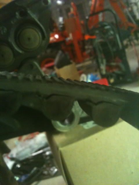

Here's mine after 45K miles. I checked it about 9K miles ago when I replaced the last tire and it looked fine.
I don't know what caused this to happen. I guess sometimes you never figure it out. Just hoping it doesn't happen again as quickly.

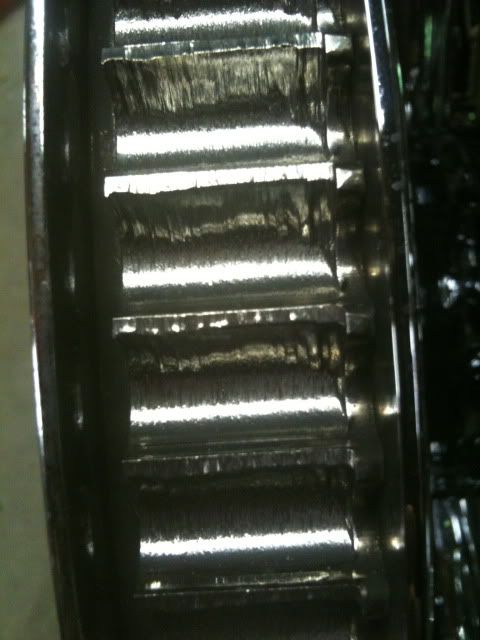

Here's a pic of the pulley too, replacing it as well.

damn, that things is grinded to hell.
I heard doing a lot of holeshots kills the belt. Jeeze...I better lay off going to fast so quick.

haha, I know I couldn't believe the belt did that to the pulley. Got the replacement for 40% off (out of warranty). I am guessing even though I don't do any burnouts I must be using all of the torque I have, at times
