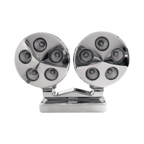

I've been holding off because the parts manager at my dealer said the Harley engineers told him they are working on a dual LED headlight for the Fat Bob and he thinks they are closer since they just came out with the Daymaker Dual headlight for the Road Glide. Joker Machine has one out already but it's really expensive and I'm not crazy about the looks of it.
I'd be interested in this DDM set up mentioned above and hearing how well it works, how much power it draws vs. stock headlamps etc...
edit: below are pictures of the Joker Machine Dual LED but they no longer have it listed on their site. Maybe because it was over $800 and looked ridiculous (IMHO)

Woof, that is/was ugly.
