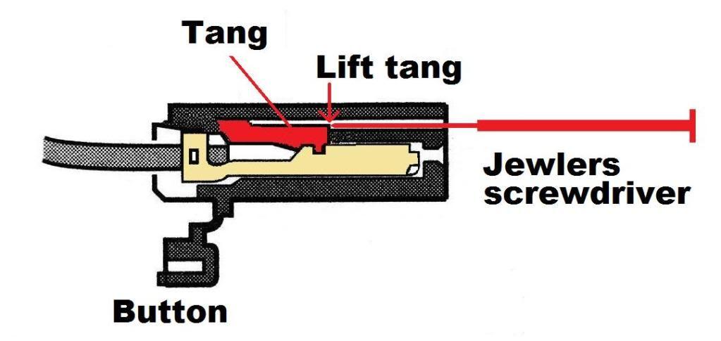

Originally Posted by FXD2003Rider
Flip open the button secondary lock; lift the tang using the screwdriver or a flattened paperclip and pull out the wires & pins...
Just wanted to say thanks for posting this diagram. I took my pins out but forgot to pay attention to the way they go back in. Your diagram cleared it up.

Originally Posted by Fatbob V2
Pulling my hair out last night trying to get these pins out so I knew someone had the answer on here!
Took me 2 minutes once I saw this.
Thanks FXD.

Yes, That is a good one too, Had stumbled across that video the other night. I also found the attached GIF.
As far as forgetting to pay attention what way the pins go back in, I just "told myself" to remember the flat end of the terminal goes DOWN toward the hinge portion of the connector, and the locking tang is up top.
If it's upside down, it won't lock in. There is a notch on the terminal that locks into the tang, (as shown in the photo and GIF, and I can of course see it on mine)
