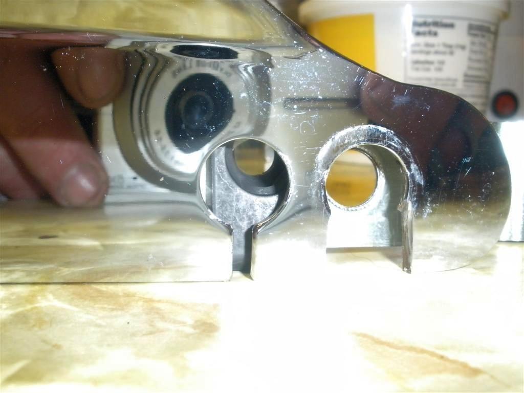

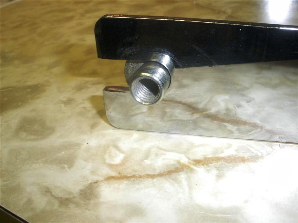

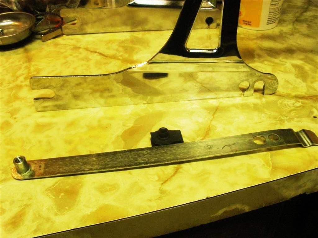

Got a PM from a member about some pictures of the side plates after the cuts were made but I must have deleted the PM so I will post the pics in the thread. I traded that bike in but found a couple of pictures on the pc of the side plates.
The mod didn't turn them into a quick release but sure made it easier to put the side plates on and off.
