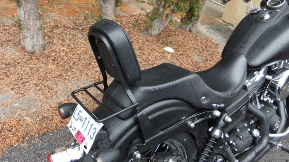

This is my home made sissy bar. It fits with easy bracket mounts.
Another alternative would be to bolt the bar on the bracket to change bars(to something 2' high with a reverse kink on the top?)
Attached Thumbnails Sissybar fabrication ???-sissy-bar.jpg   Sissybar fabrication ???-sissy-bar-2.jpg   Sissybar fabrication ???-sissy-bar-3.jpg   Sissybar fabrication ???-sissy-bar-5.jpg   Sissybar fabrication ???-sissy-mount.jpg
